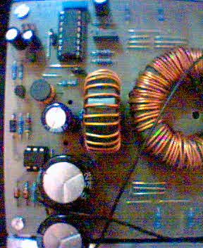

Hello to every body.You dont need to buy the my car amplifiers you can make it your one.Now reed the text sown on www.valveaudio.com for making car amplifiers 3-4 times on part for dc/dc converter and you will be able to make car amplifier.Plus download car amplifiers pcb protel format from the site + see all the pictures for dc/dc converter and that is!!!!
Now I am finising some car amplifier 1x 200W and I will put pictures + schematic + pcb and thips how to make him

Risto, your boards look so good! I just use magic marker then etch. ugly but practical I guess.
