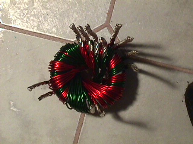

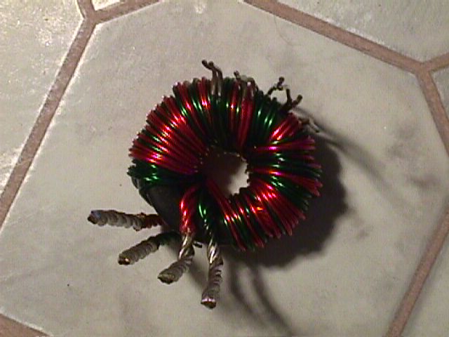

If anyone is interested I have about 200 finished 150 watt transformers and about 50 of a 500 watt unit ready to go they were made for an old car audio company.
I can take pictures if needed and cost would be cheap.
The smaller cores need to run 35 to 50Khz and the bigger cores around 40Khz the small cores give + / - 35 and the big cores are +/- 45 and up.

I'm going to take some Pics today and post I’ll be turning the transformers over to my son for shipping his handle is Zagi's rule I'll have him post here soon .
Price: small core $8.00 Plus shipping Big unit's $14.00 plus shipping.

I have just tryed to upload pics any one else care to try? I can email them over? there 40K ea is that too big a file?

These transformers are inteded for regulated operation, so the small unit puts out about +/- 28V regulated and ~ +/- 40V unregulated or unloaded. The large units will put out +/- 32V regulated, and +/- 55V or more when unregulated or unloaded. The big one is good to about 500W or more and can withstand up to around 100A peak.
Both are made by Coil Tech based in AZ, and are roughly 85% efficient.

What's the physical size of each torroid?
