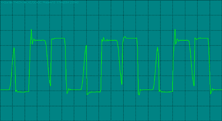

Hi.
Well I tried my smps 3 weeks ago with some mosfet amplifier, and I played very good (looud), but when I looked some stuff with scope I found some big voltage spikes. Spikes have reduced when I used 4 more tansistors to drive mosfets instead using only sg3525.
Using 5watt 56ohm resistors+100nF cap reduced spikes to minimum value , but they heat alot.
Also I think that I found some problem with opto feedback when smps is working in pwm.
I dont want to have time bomb in my car. If smps will not work perfectly I will not put it in my car.

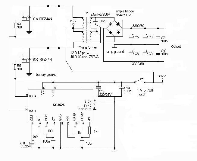

Hi Guys
I have made an amp + smps for my Contessa Classic car.
The smps uses
SG3525 PWM IC
12 X IRFZ44N mosfets
12 X 47ohm Gate resistors
1 X E-I CRGO 4 No. Iron Core Transformer 😛rimary=12-0-12 Multifillar Winding and Secondary 50-0-50 Windings.
one Vero board
2 X 100mFd 25V Caps
2 X 0.1mfd 50V ceramics cap
Couple of other resistors and caps etc.
Frequency is 250Hz
No - Feedback is applied , therefore efficiency is high.
1 X 3.5mFd/250V cap is directly connected to secondary of transformer to suppress spikes.
2 X small heat sinks.
Now the results
No heating on full load only simple warming of sinks
650W power capability
Still alives and is breathing in my car
IF any one interseted mail me.

Well I think I have problems with PWM. When I use non-regulated supply everything is OK, no spikes or anything. But when I switch to PWM I get strange readings on scope on primary and secondary. Gates looks at it should at any duty cycle, but look at primary. I dont know is this ok ?? this is about 40% duty cycle. After rectification everything is normaly I get targeted voltage.

ThanX for ur interest
here is schematics
ryssen said:
bengt said:Hi Mr Amp_man.
I am also very intrested so please send me info on bengt_e_eriksson@yahoo.se
Regards, Bengt
here is schematics

Hi amp man
Amazing results, constant output power, no overheat, now you got to help us here, I don't know the dimensions of your E-I iron, from where did you get it anyway.
What wire gauge did you use,and why did you use the 3.5mF capacitor on the secondary directly,and how did you wind your transformer.
Now if I bring an old 5 Amp 48 volt ordinary mains transformer, can I use it, if so, are the number of windings still the same, and what wire gauge should I use,and how many total mosfets should I use, I mean how much power can I obtain from it.
BTW, how should I wind the transformer,there is a plastic core for the primary,and another one for the secondary,should I wind the primary in clockwise and the secondary in counter-clockwise for example,or both of them in clockwise.

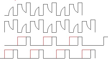

Grucho: It looks to be that at the midpoint between rise and fall of the first switching device, a switching device on the other end fo the winding activates. remove the transformer and see if it still occours
Hi.
I dont have camera so I draw image from analog scope.
Center tap of primari is conectet do GND of scope
1 image - 1st primary
2 image - 2nd primary
3 image - gate1
4 image - gate2
With red is 50% duty cycle, with 50% duty everything is ok .
So this is about 10-15% duty cycle .
