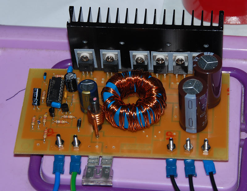

I have built the PSU and it works!
Slight modifications (to make the circuit similar to the one found at ESP):
10k resistors replaced by 12k
Remove one of the 10k resistors immediately above the 3525
Remove the 1k resistor in the same place
Add a 12k resistor from pin 1 to pin 9 of the 3525
Gate resistors changed to 22 ohms
MOSFETs used are Infineon SPP80N06's and output rectifiers are MUR1520s.
The shutdown/standby circuit works, it disconnects power to the chip instead of using the chip's own shutdown input.
Efficiency is >90% (estimated), the (small!) heatsink only gets slightly warm at ~100W output.
I accidentally shorted the output while testing... nothing happened other than a BIG spark.
This will power a pair of Red Rocks Audio D200's 🙂

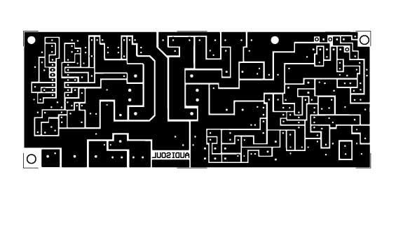

Greetings sharing audisoul first circuit I know the great I am more under construction and I am so worried about the results but I have a few questions using detaylarınıda picture of the transformer to know the shared core diameter of the wire thickness, number of rounds as the winding direction thanks
> swap
I do not actually know one of the most important issues is how the transformer ever done before and I do not understand how yapıldığınıda English is not my anlıyamıyorum still so you know to share fotoraflarıyla under construction and I would be very happy, thank you
