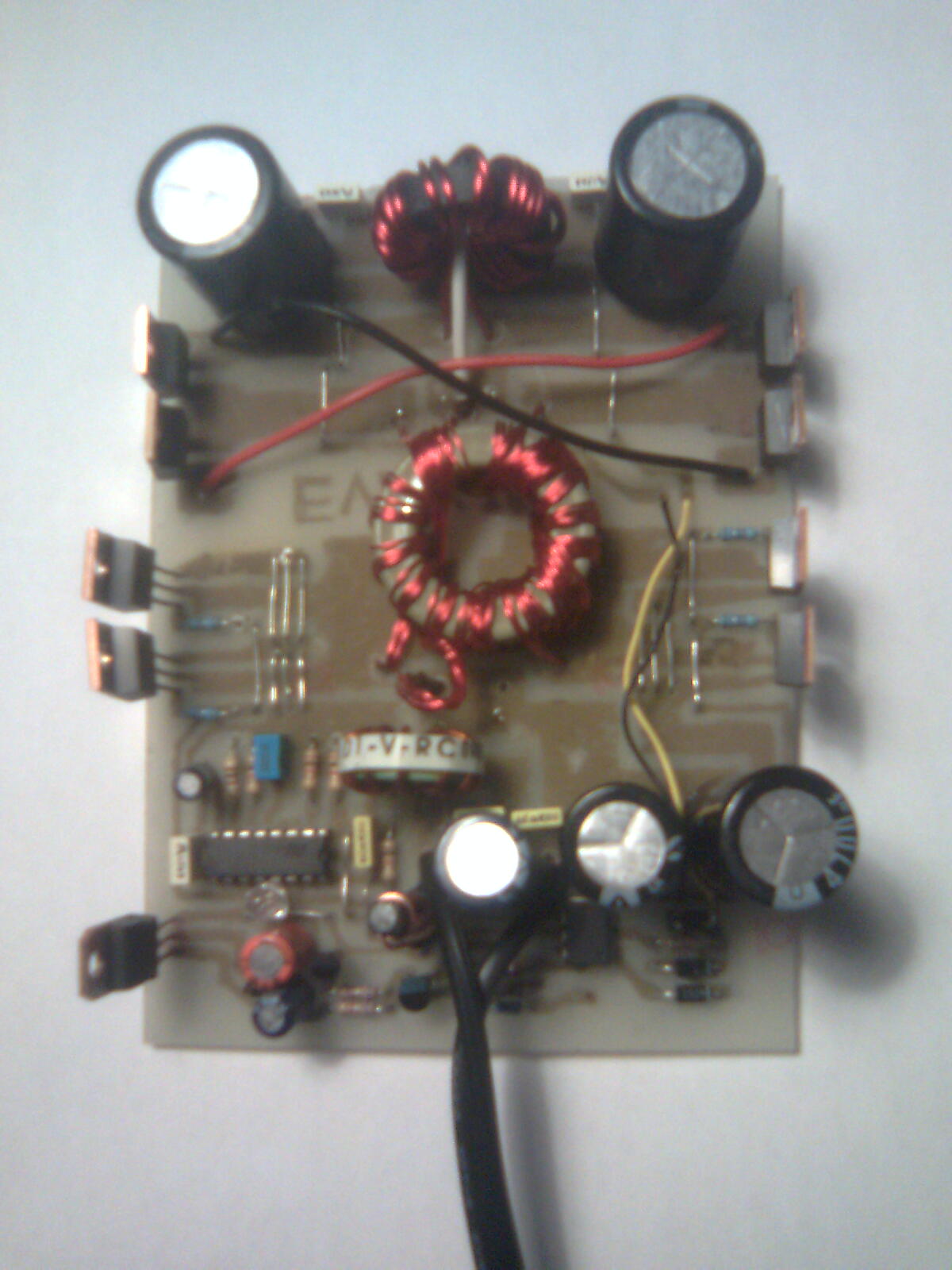

is it fine to use a 10uH inductor for the input and output filters? It's my understanding they are not needed but the SMPS runs smoother with them and since im only running 200W it should still be adequate? Since I already have them ready from another project.
i tried it with the 10uH inductors and the mosfets got really hot and might be blown. I don't know what might be wrong with it right now so im attaching a picture of how it is set up right now. Does anything jump out?

Thank you for looking at it 2pist, it has no voltage at the output with no load though. It's good that nothing stands out besides that though.
with school closed all i have access to is a multimeter. I'm using 47 ohm gate resistors instead of 100 ohm though. The core has 952R 58071-a2 +2 written on the side and what i've been able to find is that it is a high flux core, dimensions are 33.02mm OD, 19.94mm ID, and 10.67mm high. Permeability of 60 according to High Flux Toroidal Cores for Chokes and Inductors : CWS ByteMark, largest supplier of toroids, ferrite cores, iron powder cores, MPP cores and RF cores
That's not the correct core for a power transformer. Go to CWS Bytemark and buy a core made of 'F' material. That should solve your problem.
that wasnt bright of me... I tried with another toroid i had, a smaller black one with shiny bits in it. No markings or any way to discern what is it though. I tested it and got a reading for a second on the secondary and then a trace to the mosfets burnt out :|
Only one side of mosfets got hot, and they did get very hot.
The trace was to the mosfet's source. I'm assuming the toroid im using now is fine, but either the transformer is not wound tight enough, or the mosfets are toast from testing with the wrong core.

Winding the core loosely won't cause it to burn traces.
If you can't get the power supply to work properly with the second core, try to find an amplifier to salvage a transformer/core from. Be sure to salvage a core from a transformer, not an inductor.
