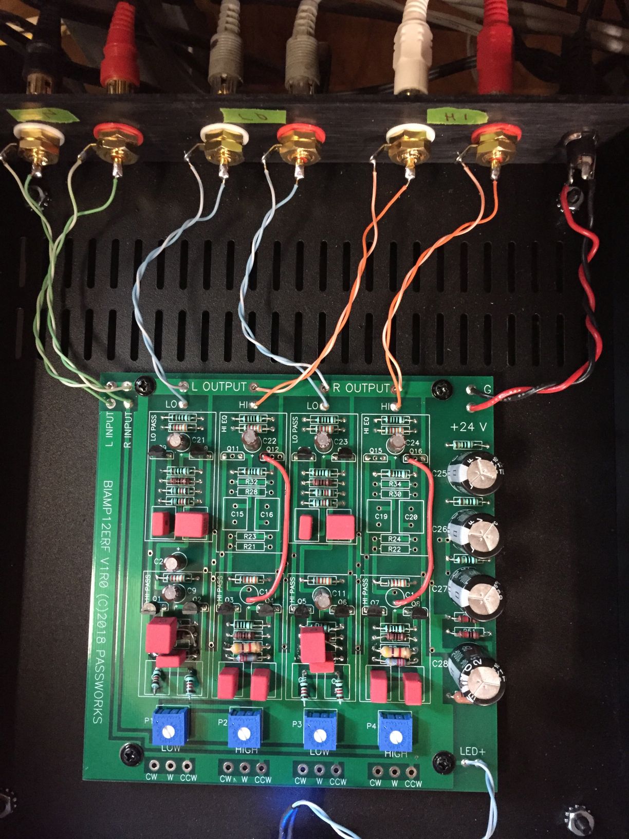

Here is how I went about designing and modifying an LX Mini crossover board for my biamplified ADS L980 studio monitor loudspeakers.
The ADS L980 is a 12” 3-way loudspeaker that was manufactured in the mid-1980s. Since it was ADS entry into the studio monitor market, it features high quality, matched drivers in mirror image cabinets. Components consist of a12” sealed box woofer, a 2” high excursion dome midrange and a 0.75” dome tweeter. Crossover points are nominally 450Hz (very low for a 2”) and 5000Hz. Efficiency is 90dB 1W/1M. Passive crossover slopes are 12dB/oct Butterworth. In biamp mode, direct connection is provided to the woofer voice coil but the midrange HPF and LPF and tweeter HPF stay in the circuit.
Listening tests using a miniDSP digital crossover/processor determined that my preferences were for a 500Hz 24dB/oct Linkwitz-Reilly alignment between the woofer and the midrange, leaving the mid-high passive crossover set at the -1.5db position for the tweeter. Since a 24dB/oct L-R filter is two 12dB/oct Butterworth filters cascaded, I decided to design the active crossover with a 12dB/oct Butterworth alignment HPF for the midrange, which would add to the passive crossover Butterworth filter to yield a 24dB/oct L-R alignment, and an active 24dB/oct L-R alignment LPF for the woofer.
I started with TCJ Filter Designer from Glass-Ware. This program is a bargain at only $10. John Broskie has done the DIY audio community a real service here. Moving away from the optimal component values, which are non-standard, I went with the closest standard cap values first and then the closest 1% resistor values after that. I plugged these into a modified LTSpice version of the LxMini crossover model (link available on one of Papa's sites). This confirmed I was on the right track.

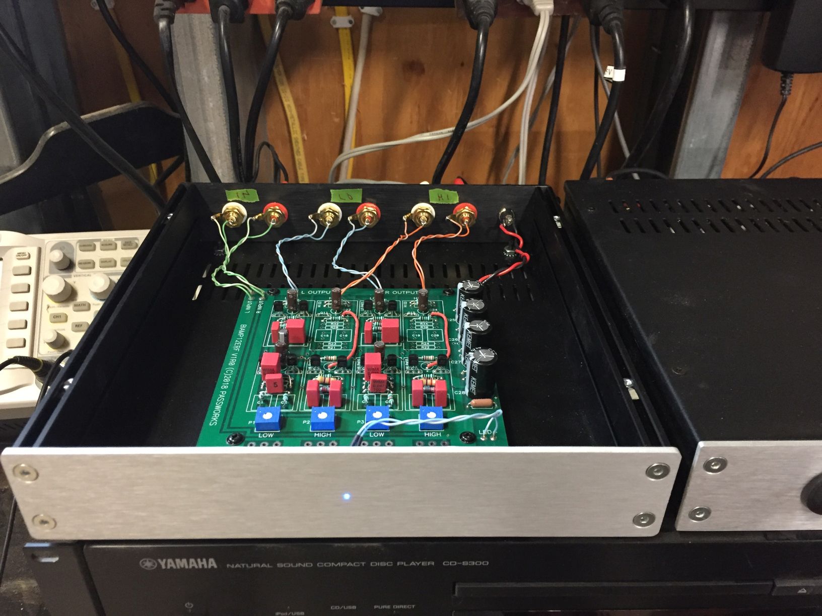

I have posted the schematic mods, the LTSpice plot and file and some photos. Should be pretty self-explanatory. The caps in the resistor spots are a bit twisty as are the resistors in the cap locations. There are a few Jfet current source resistors I stuffed and soldered in by mistake in the L and R section two of the HPF. Ignore them.
How does it sound? The improvement over the miniDSP in detail, imaging and overall clarity is almost shocking, it is so obvious. Well worth the time and investment. Thank you, Papa, for making this wonderful Jfet analog crossover board available through the DIY store and also the matched Jfets and current source resistors.

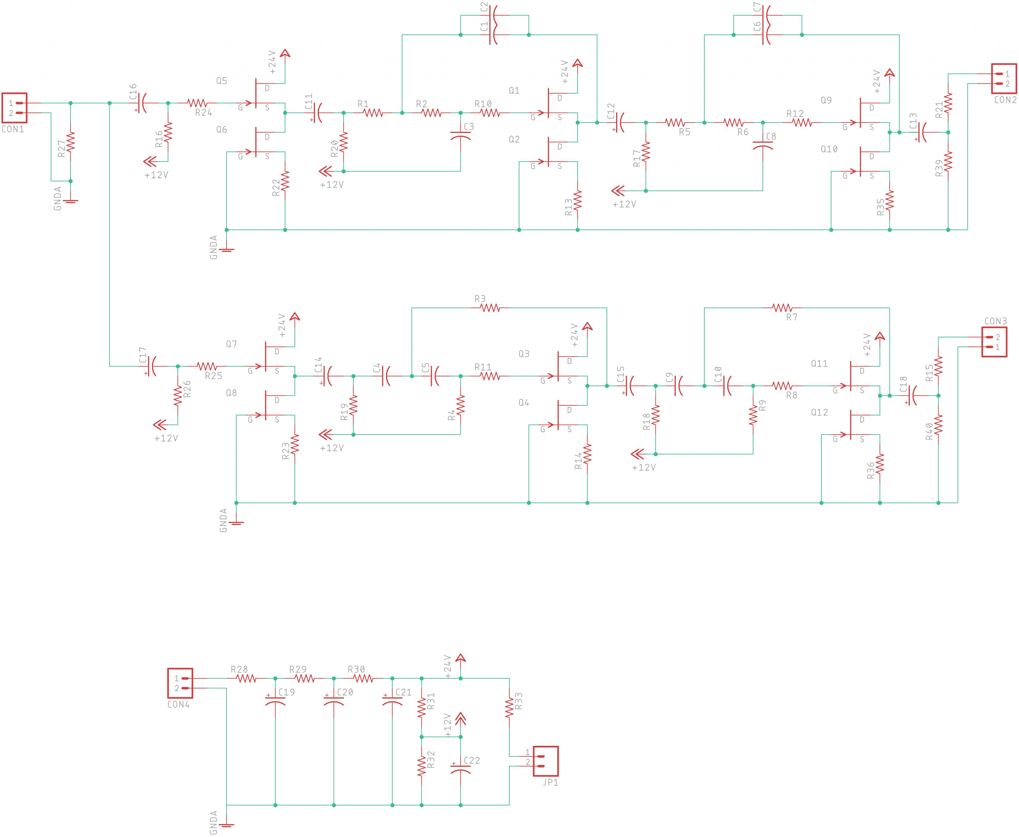

I'm interested in a 24db lr 2 way and have bought two kits. I have made the following schematic and would like opinions if possible. I am crossing over between stereo subs and speakers at around 80 hz. C is 100nf R in the filter is 14k (R4 & R9 would be 28k). The bias resistors specific to the jfets in the kits would be used. I also wanted to buffer the input of the filters. Does this look good?

Looks fine. If you bought the store kits, then the input buffers are there already.....

Thanks for the help. Does that mean Q5/Q6 - Q7/Q8 buffers are not necessary? The boards I have from the store don't have input buffers, they go straight to the filter after the pots. My subs have VC so I'm leaving out the pots. I was worried that the filter might be too hard to drive in some cases. I'll be using various preamps. Currently it is a 2sk79 based with a Pimm ccs using mu output and thought an input buffer would avoid any incompatibility.

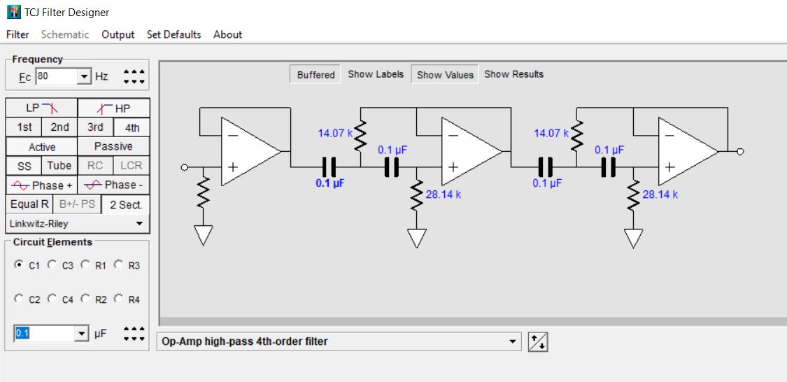

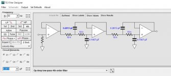

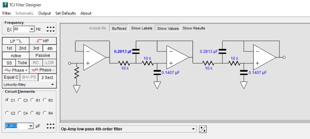

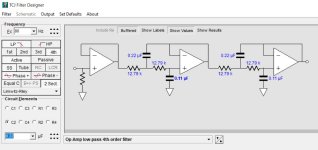

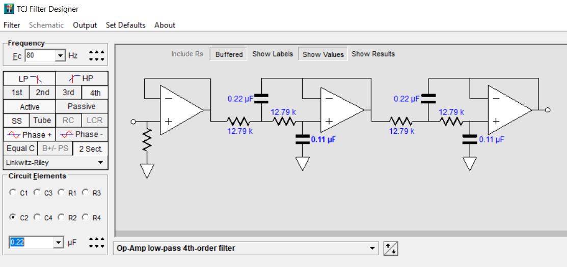

The HPF values are easy - yours match the filter designer software almost exactly. For the LPF you can see that cap values are non-standard. So, I would change to 0.22 and 0.10 caps and use 12.7K resistors. I found when I modeled my version (500Hz/24LR) in LTSpice, these types of small changes to standard values made virtually no perceivable difference in the resulting slopes and crossover point.

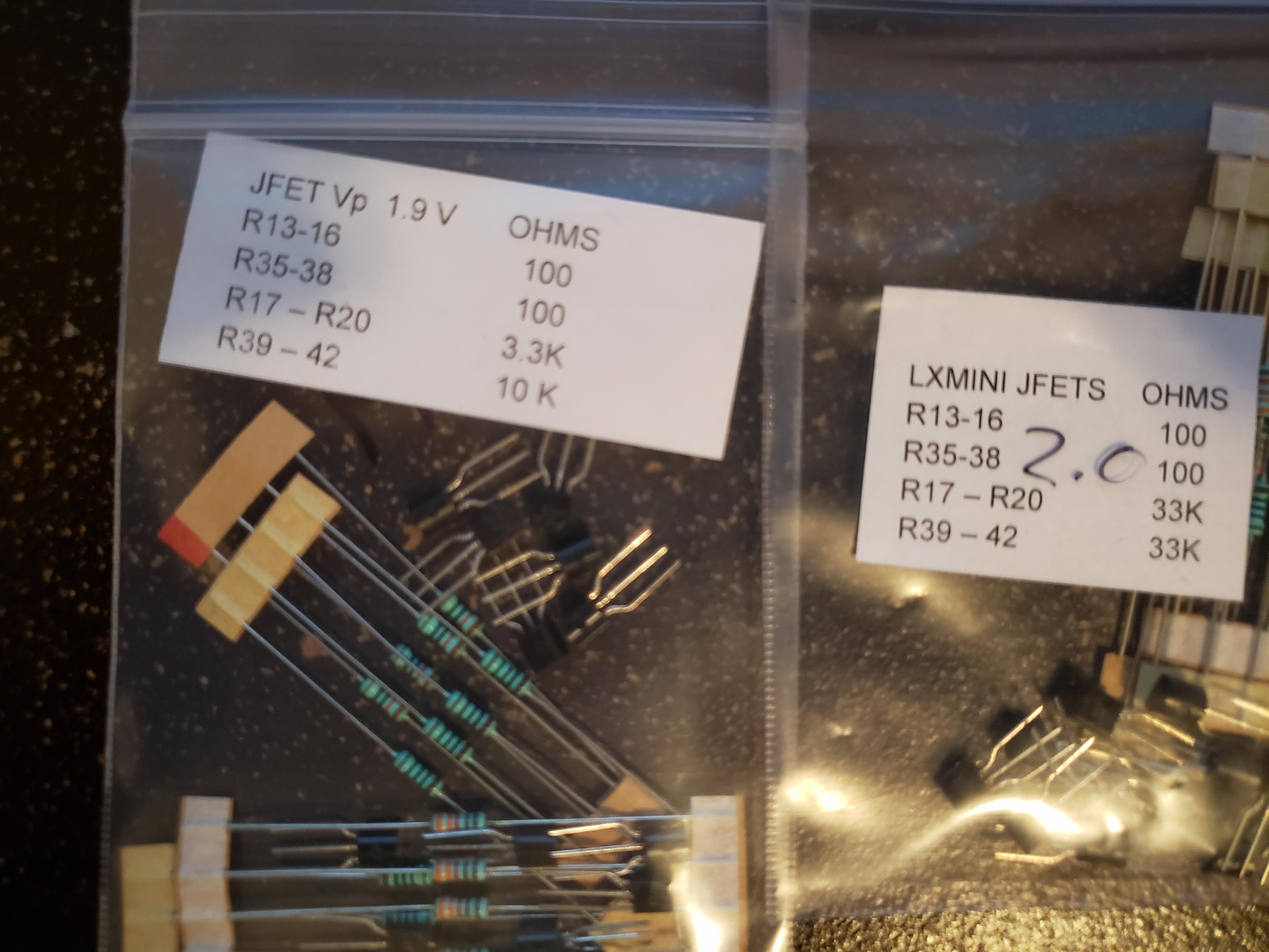

Hi, I have another question about the kits. I have two from the store. The article says the resistors should be around 4k and 10k. One of my sets came with 3.3k and 10k so they fit. The second set came with 33k and 33k and I measured to be sure. The resistors in the pack are 100 ohm and 33kohm. The small label in the bag also lists 100 ohm and 33k for both the other spots. Does this sound right? Are there any downsides to using jfets that require resistors of that value?

Hi, here is a picture of the two jfet kits I received. One is labeled as vp 1.9v and has what looks to be a reasonable, according to the article, 3.3k for R17-R20 and 10k for R39-R42. The second kit is labeled 2.0 on the bag which I guess is for a vp of 2.0v but the resistors are 33k for both R17-R20 and R39-R42. I measured and confirmed those values. They are way outside the range listed in the article so I'm wondering if they are in fact correct or there was some mistake made. Can someone confirm the correct values for the second kit?
