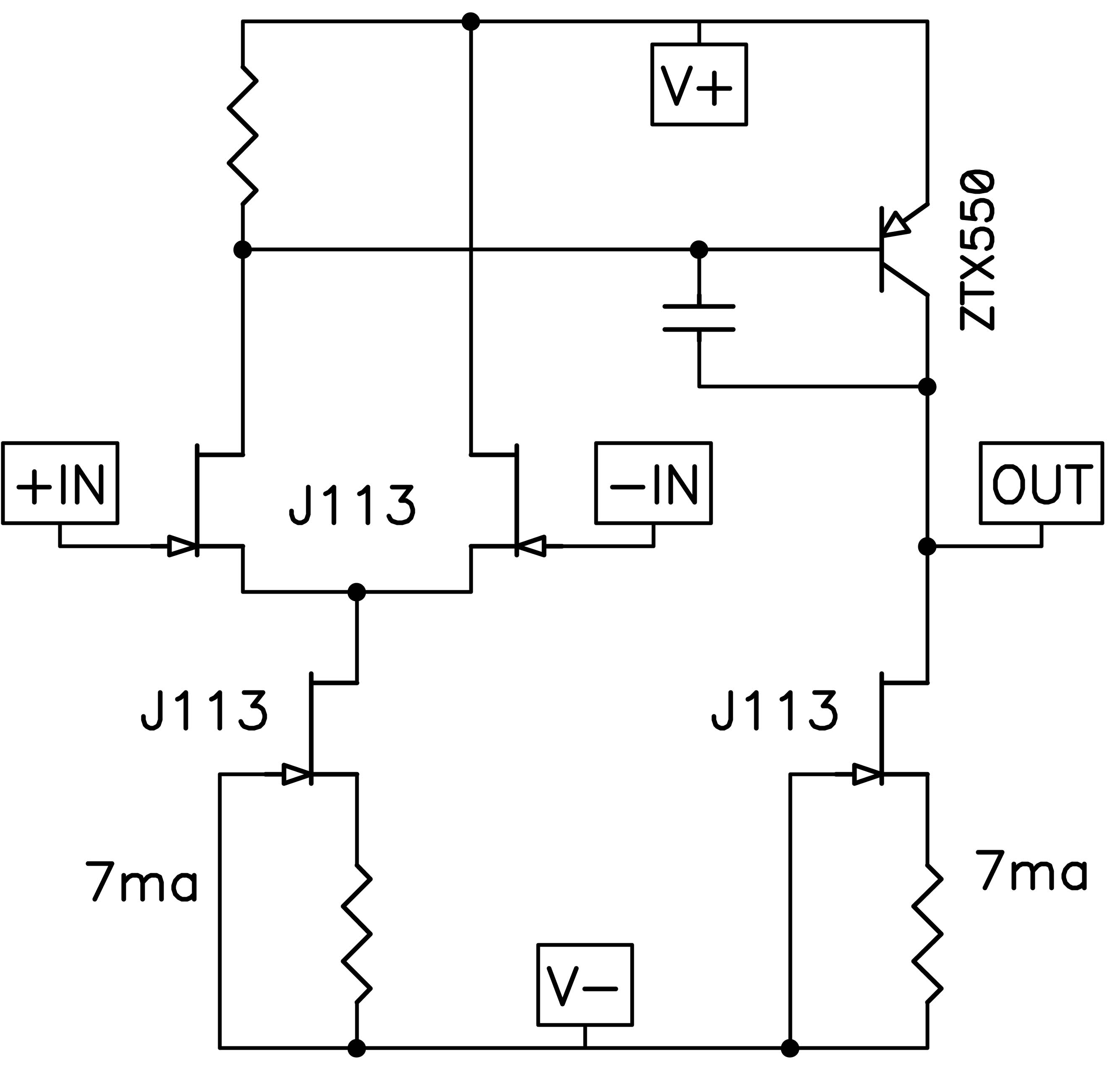

Plenty of discrete op amps laying around.
Here's one. :cheers:

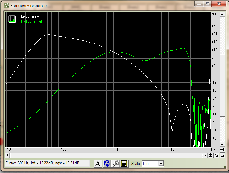

frequency response
I used RMAA to measure the frequency response curve. The signal was input to output from LXMINI ASP, and no microphone was used. The bass needs to be subtracted by 6.5dB, because the signal requirement adds 6.5dB to the input, which must be subtracted in fact.

Look at my post #486.and #494 There are a few basic checks on simulation curve to make sure your modification does not cause any sonic issues
1. Makes sure Response summation/subtraction is 5-6 dB above the Xover frequency. Look at my plot for amplitude summation and subtraction
2. Need to make sure whatever Xover frequency you change is *in phase*. If your new Xover is not in phase, you might need to modify R, C values and play around until everything is in phase. Look at my plot for the in phase response and formula.
Good luck :)
