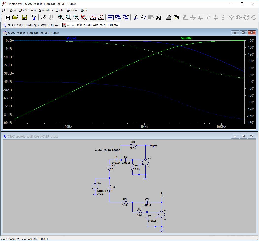

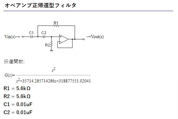

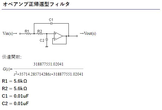

I am a beginner. I have a question. I want to use the ACN-basic kit from diyaudiostore for my 2way-speaker. The speaker is SEAS's Loki-Mk3 and it's crossover is "2nd order symmetrical with a 2.9 kHz crossover frequency SEAS Loki MkIII
I have no knowledge of calculating the C and R values to replace this passive crossover with an active crossover.So I asked Google and found the filter calculation homepage (I'm sorry, it's Japanese). (サンプル)オペアンプ正帰還型ローパス・フィルタ計算ツール In this page, if I enter the cutoff frequency and the quality factor "Q", the C and R values required for the "op amp positive feedback type" HPF / LPF are calculated.
Question 1: Can I apply this "op-amp positive feedback type" calculation to ACN calculation? I entered a cutoff frequency of 2.9kHz and Q = 0.5 (2nd order Linkwitz–Riley in my understanding) on this page, and obtained HPF / LPF values of C: 0.01uF and R: 5.6kohm(Pic.1,2).
All C and R have this same value.
Question 2: Are these C and R values normal? I calculated the above values with LTspice (I have no experience).
Question 3: Are the results correct?
Any advice and opinions are welcome. Sorry about my terrible English.

Congratulations. All looks good. Actual R values for C=0.01 is 5.488K ohms but the standard value of 5.6K ohms is certainly close enough. I recommend 1% tolerance metal film resistors and 2.5% tolerance film capacitors.
Keep in mind that the PCB layout for the DIYstore ACN is for cascaded filters specific to the LXmini loudspeaker. You will not use filter 1 of the low pass section and will not use filter 2 of the high pass section. These unused filters are easily bypassed.
Personally, I find this crossover sounds best with the 25K input trimmers set to full input and attenuation used on one of the amplifier inputs if level balancing between HI and LO is required.
If you will be feeding this crossover with a tube preamplifier that does not work well into the 12.5K ohm effective input impedance, you may want to consider re-purposing the unused filter sections as unity gain buffers and deleting the input pots. Easily done in the LO section but requires some fancier trace and jumper work in the HI section to get section 2 in front of section 1.

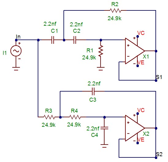

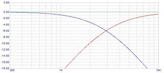

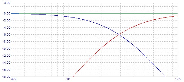

That looks a little off - the response would want to be -6 dB at the crossover point for a flat sum.
This filter will give a flat sum with one driver phase inverted. (edit) my error, I misread the scale on your resp graph.....

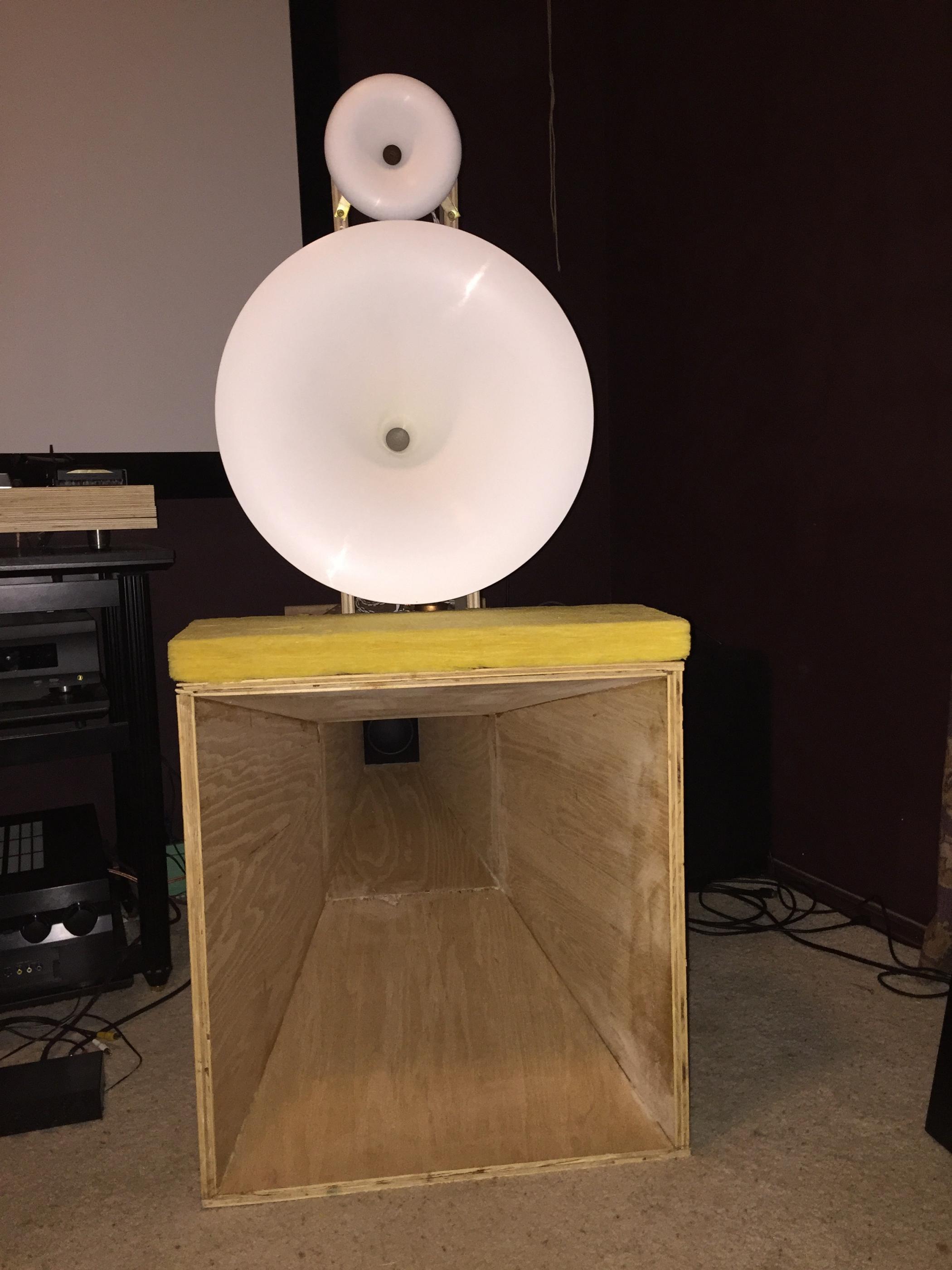

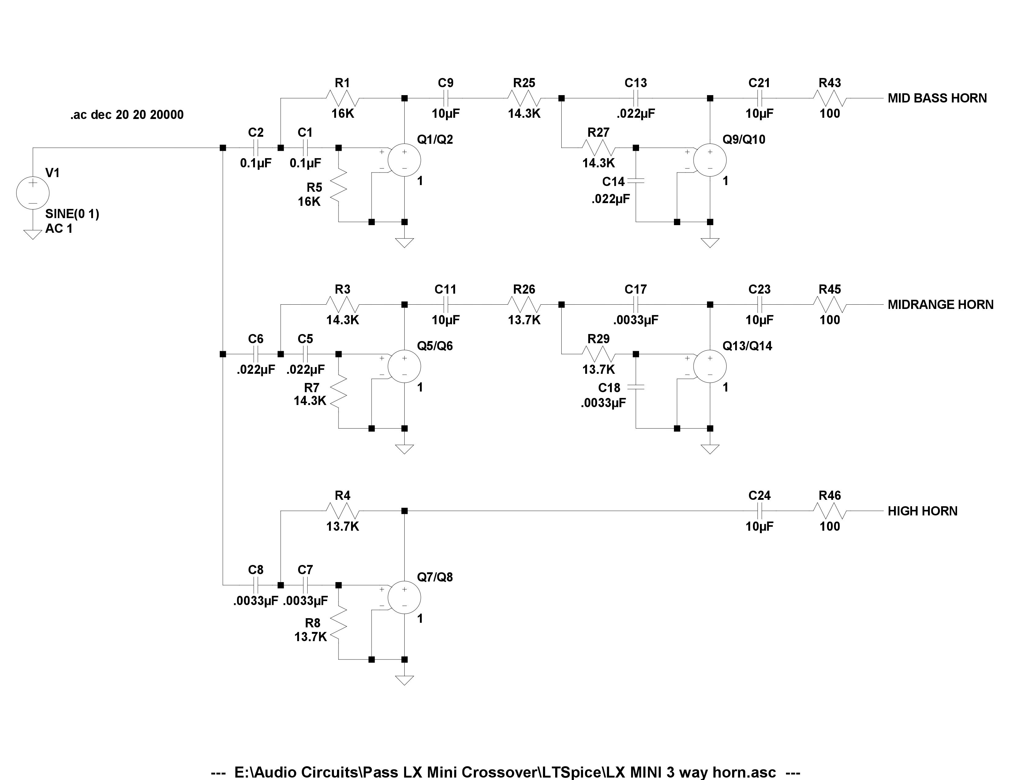

LX mini crossover in 3 way system
I hoping to get some guidance on how to configure the LX-mini kit as a 3 way crossover in a speaker system I'm working on.
When done it will be an active 3 horn system plus a pair of powered sub-woofers below 100 Hz
An early, wood glue barely dry, work in process picture is below
I already have a pair of the LX-mini crossover kits and would like to use a single stereo kit on each side but configured as a mono crossover with Low Mid and High outs.
I thought I remembered seeing something on this in this thread but after much searching I decided to cry for help😕
My ask is for some guidance on how to configure / connect it as a 3 way.

I would like to end up with the LX mini crossover configured something like:
- Mid bass horn: Low pass @500 Hz
- Midrange horn: High Pass @ 500 >> Low Pass @ 3.5 kHz
- High horn: Low pass @ 3.5 kHz
The mid bass horn rolls off below 100 Hz as predicted by Hornresp so I plan to relocate the mini-dsp to do room correction / low pass only below 100 Hz to the subwoofers.
Any guidance, suggestions or breadcrumbs would be most appreciated.

Here is a modified LTSpice Model and printout with your crossover points and component numbering that matches the PCB. It includes a HPF at 100Hz for the low horn. I used standard cap values that got me pretty close using standard resistor values.
If you want to fine tune the filters, you may want to pick up a copy of tubeCAD filter designer - it's only ten bucks.
TCJ Filter Design - Download
This can be a help if you want to plug in different standard caps and see how the resistors come out - I try to stay in the 5K to 25K range of resistance values.

Note: I did not include input trimmers. I found that because there were no input buffers for this board, the crossover sounded best with the 25K input trims wide open. Your results may vary.
Due to the use of 3 inputs in parallel, if you don't have power amp input attenuation for balancing, and you end up adding input trims, you may want to consider upping the trimmers to 50K to raise the effective input impedance your preamp sees from 8.3K to 16.6K. Although solid state preamps should have no problem driving 8.3K.
I have not listened to the circuit without some sort of input loading resistance, in my case 25K trim pots wide open. Something, even 100K, might be necessary to stabilize your preamp. I just don't know for sure.

In any case I would like to try out the analog crossover of your design, and wonder if you agree that replacing my DSP with your analog crossover is a good and reasonable approach for my purpose. I prefer a 4 ways crossover as described above, but a 3 way solution may be feasible (although if possible I prefer to have a high pass filter at 125 Hz).
If you or someone with a similar experience can give me a guidance, that is very much appreciated.
RY
You don't seem to need the EQ circuits of the LXmini, so maybe an
ordinary flexible crossover would work for you.
I have a crossover ready for the store which is 6,12,18,24 dB/oct high pass
and low pass for each channel, and this might be appropriate for you.
You can adjust each pole of the filters individually +/- 1 octave around
a frequency determined by capacitors you install - all the caps are the
same value to make life easier.
If you cascade low pass and high pass filters, you have band pass, and
a 4 way system would require 3 of these boards for stereo
The base kit is the board plus selected Jfets.
I expect that it's cost will be competitive, so perhaps you would like to try it.
