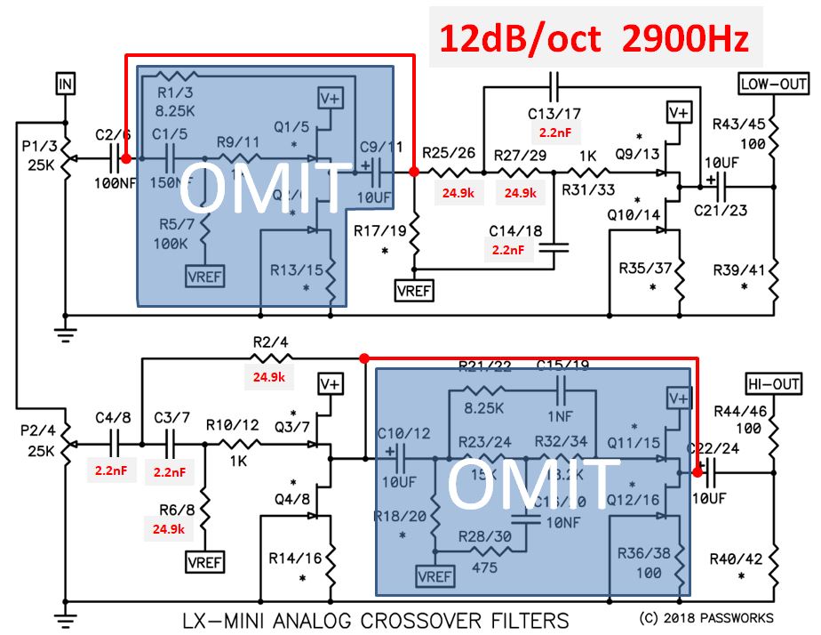

Thank you for the answer.
I changed the schematic.
Does this correctly reflect your opinion?
On the low pass, Vref gets shorted to ground. Move the red line to the other side of C2/6.
Papa
I don't understand the purpose of including C2/6 and R17/19 in the LOW-OUT section. The HI-OUT section does not contain the equivalent.
The RC combo couples the AC signal to the filter, and C2/6 isolates the DC voltages to maintain the filter's DC operating points. Without C2/6, the DC voltages will have paths to ground.
Then would it not be better to change the value of C2/3 to 10uf? Or connect the wiper of P1/3 directly to the positive side of C9/10?
For the 12dB / oct network I need, I need to bypass some, but is it correct as my pic?
I am not confident that R17-20 is unnecessary.

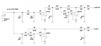

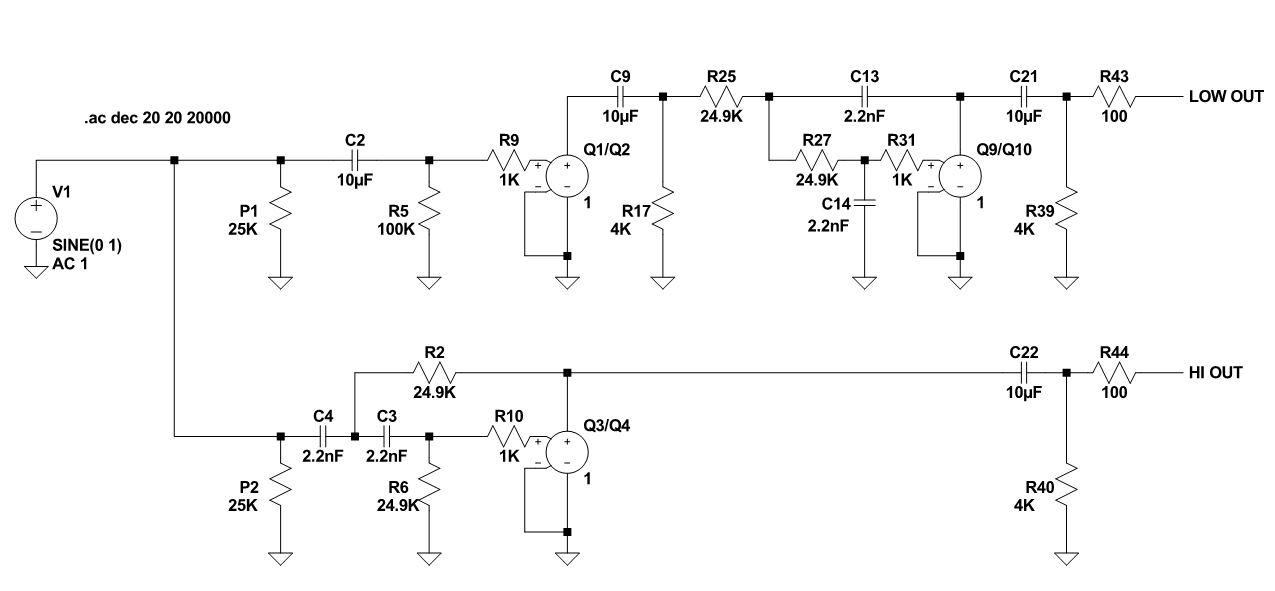

Out of curiosity, I decided to model this. Attached is LTSpice model with component numbers that relate to the PCB. I kept the LOW-OUT section one input buffer since it was available and easy to use. R17, R39 and R40 are nominal and should be the values specific to the supplied JFETS.
Here's a pic
