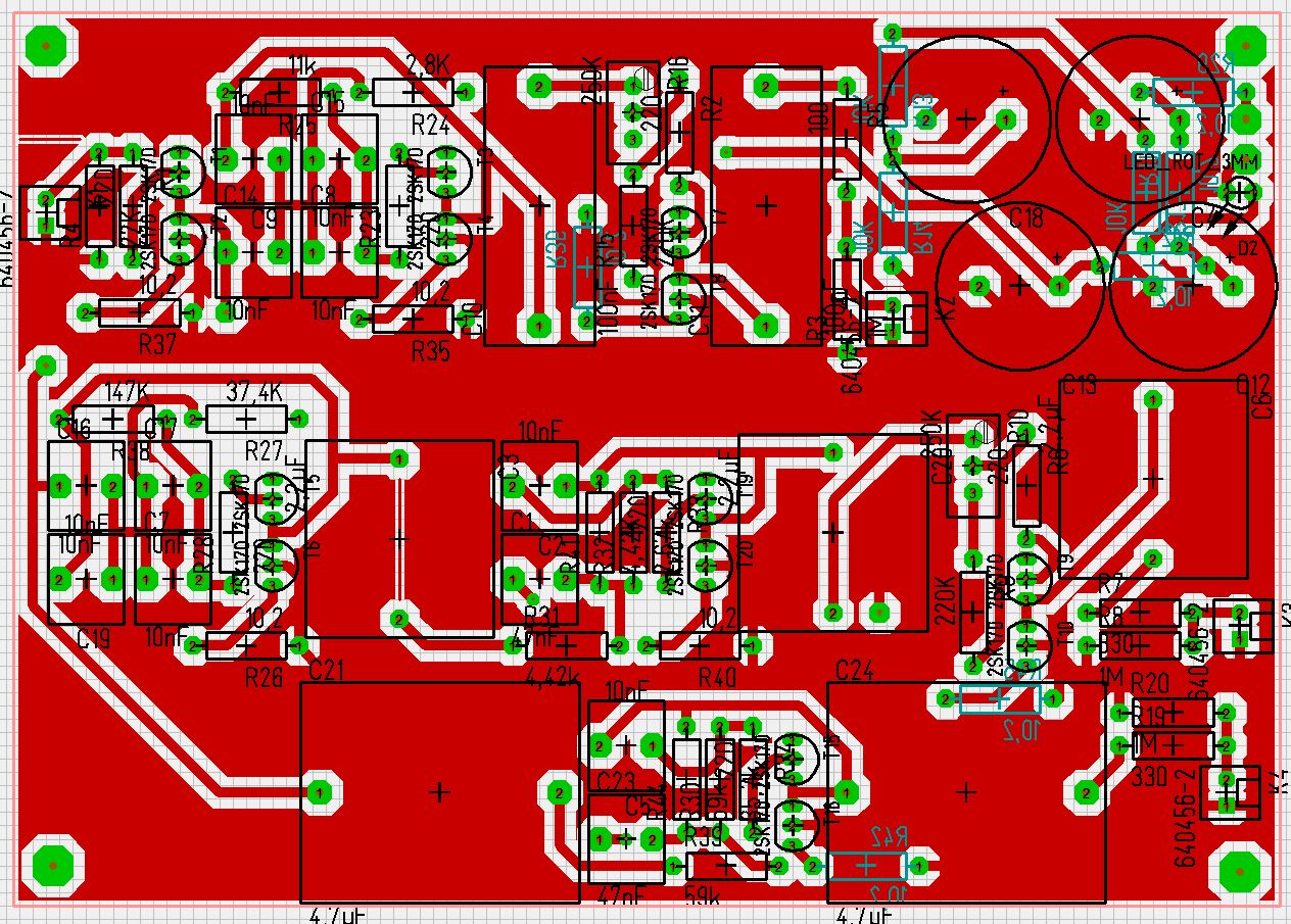

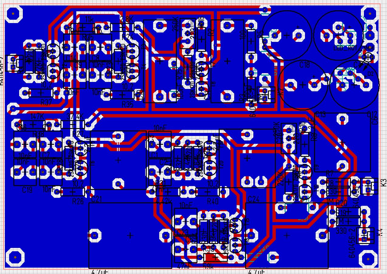

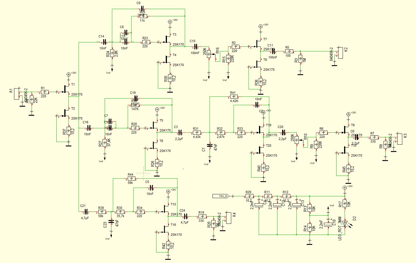

Purpose of the Vref?
What is the purpose of Vref? i didn't recognized any explanation. i think it's an rcr-pi-filter to lower the noise(?) . but how to integrate it in the calculation of the filter?
i want to use the topology for a 3way active crossover (2000hz 2nd order/150hz 3n order)...

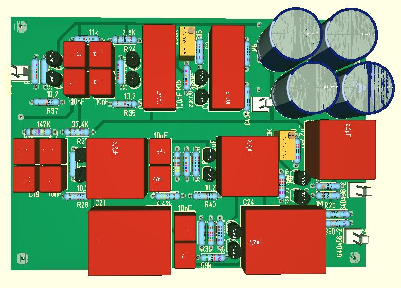

as promised: my try of drawing the crossover. It's a 3way crossover. the values of the caps were chosen, because they are laying around on my workbench.
the topology is butterworth/multible feedback/2nd order.
i`ve chosen the multible feedback because, i had build a xenover with sallen-key topology and had the problem, of signal-rising at higher frequencies at the lowpass-filters.
the values of the resistors for the jfets are not the real values, they are just drawn as a placeholder for the board.
the lowpass-fitler for the bass got no poti, because it is the quietest part of the loudspeaker (as obviously always).
the whole thing will be used in a loudspeaker called "heartbeat" from hobbyhifi. a german magazine for building loudspeaker. the active crossover will replace the passiv crossover of the original build. it will be driven by f5v3 for the bass and mofo for mid and twetter.
i will be happy for thought, ideas and threats🙂

I guess you have to re-check your whole layout again: Every stage needs a ref voltage on the gate of the fet, since you use a single supply voltage. Please re-read Nelson's original schematic. (The potentiometers should also be kept out of the DC biased parts.)
"... VREFis a DC value to set the operating point of the single-ended circuits. ..."
