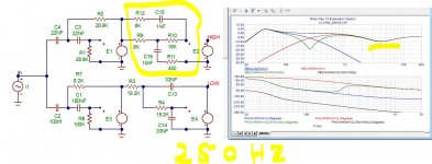

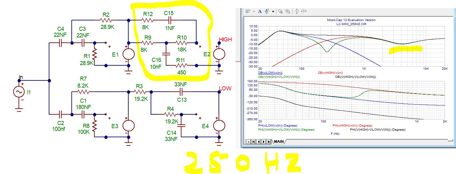

Can somebody enlighten me how the EQ works and how to calculate the values. I did try to modify the values to reflects a 250Hz Crossover with a 40HZ bump for an open baffle.
My initial thoughts are to leave the EQ out ...
