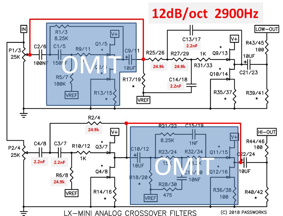

Nelson-san,avdesignguru-san,
Thank you for replying to post # 546. Sorry for the late reply.
I received the ACN-PCB from the store today.As usual, it is a beautiful.
For the 12dB / oct network I need, I need to bypass some, but is it correct as my pic?
I am not confident that R17-20 is unnecessary.
Yamana-san
If you purchase a PCB from the store (The diyAudio Store - DIY amplifier kits, chassis, and parts), the cheapest shipping cost (DHL Parcel Direct) to Japan is $ 15-20.

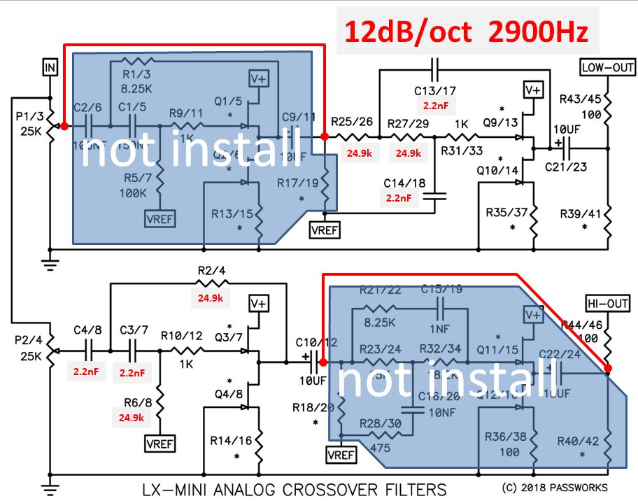

I think the LOW-OUT is correct but the HI-OUT needs output resistance to ground. See attached.
