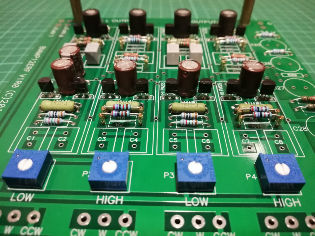

for anyone interested to change XO point,add additional pin connector to resistor position which impact on filters. it will make it easier for resistor swap later

Mr. Pass,
I modified my crossover again since my previous mods did not give me the correct summation of phase response alignment. Here's the final plot for my version of XO at 135 hz. Closed enough to what i needed.
I think the best part of this version is the perfect in-phase response summation with one driver inverted matches closely the phase of LP and roughly flat freq response summation.
Let me know your thoughts on this one.
Thanks Mr. Pass
Tom

I put together the kit with R,C values of my simulation. Play around with the simulation some more. Did many audition sessions and REW measurement to finally decide that 125 hz XO frequency was the best optimal sonic for my OB speaker.
Man, the sound really comes to life with alot of details and 3D. It trumps over the miniDSP with the same setting at the same XO frequency.
Thank you Mr. Pass for a wonderful gift to the DIY community from a happy DIYer and music listener :hphones::wave2::wave2s:
With this much of sound quality from this kit, I'm really intrigued and anxiously waiting to get my hands on the new XO ckt with multiple slope settings coming up ahead in the store 😀
Boy, you have an interesting collection of parts. Its very cool to see you using the K40 caps. What are those red resistors and white resistors?
Thank you sir. I have more goodies hiding under the closet 🙂 I really love the sweet and open tones of Russian PIO and Teflon caps. I've been collecting over the years from my past DIY builds and have a full box of them. I'm planning to do another LX mini XO build with all PIO/teflon caps populated and see if there're any differences in sonic result. My guess is It might take a while before I notice any differences since those caps take forever to really break in and sound sweet but it's worth a try anyway.
Those Red/green/blue resistors are special 1% precision resistors that I inherited from one of my family member's friend who used to be a WWII electronics engineer. The values of those resistors are very precise to 0.01th. It's amazing how people care about build quality and control many decades ago!
