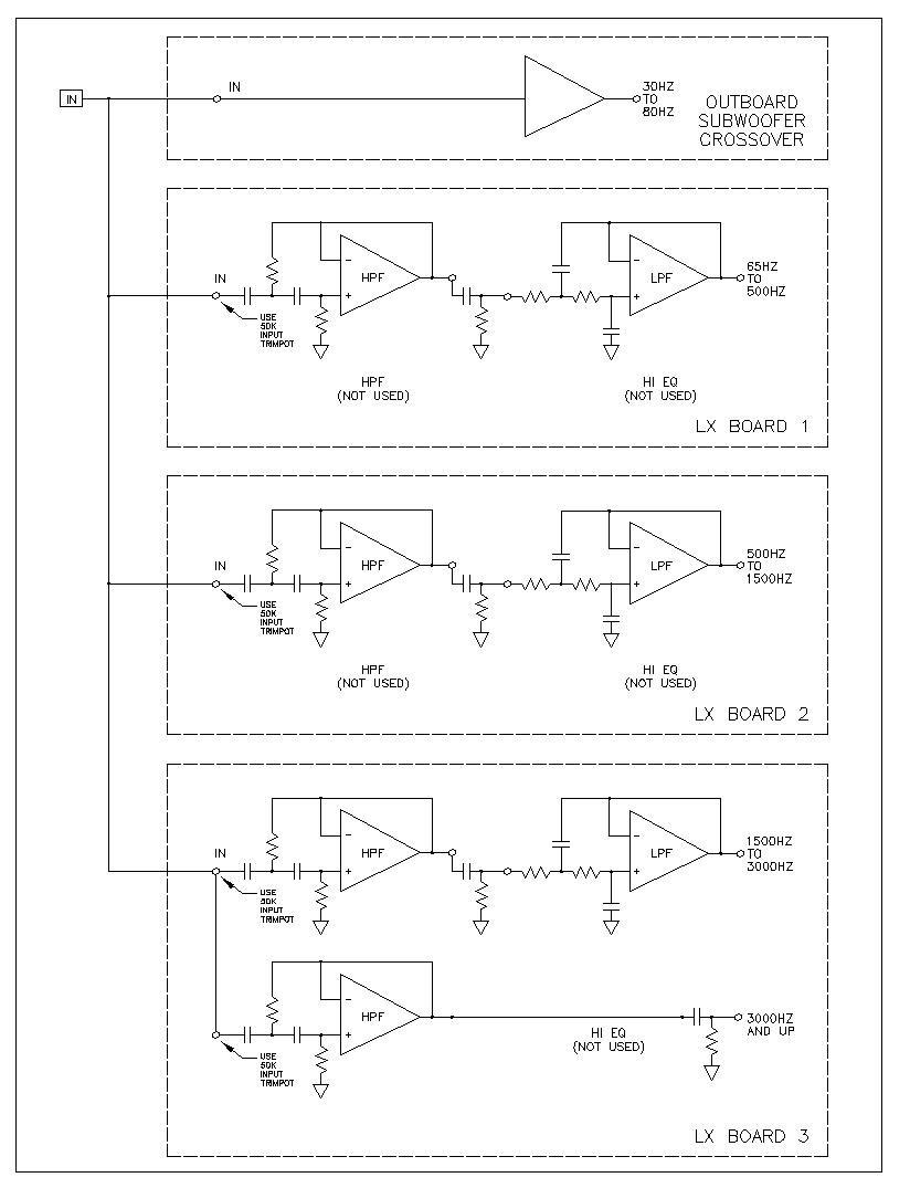

My other issue is that I have a 5-way horn system with three channels that require bandpass at 65-500Hz, 500-1500Hz, 1500-3000Hz. Tweeter needs 3000Hz and up. Subwoofer needs 30-80Hz 4th order, but in worse case I can use another filter for that. Question is, do I split the signal at source or cascade as many LXmini as it is required from the output of the previous LXmini.
Should I just wait for the B4 mkII to come out, but will that help me at all since I have so many channels?
And why did Papa recommend me not to use the EQ with so many channels?

I would not cascade boards, I would parallel inputs to multiple boards, using all-pass buffers if necessary. I think you can do this with two LX-mini crossover boards if you want all 2nd order filters. To do that, both boards will require some rewiring, jumpers, etc. to also use the EQ sections as either HP or LP sections. Perhaps Papa said not to use them to avoid cutting traces, adding jumpers and putting capacitors in resistor spaces and resistors in capacitor spaces but they are not really difficult circuit board hacks if you look at the schematic requirements.
LX-mini board is just JFET buffers instead of OP-Amp or tube buffers. Using all of Board 1 would give you bandpass filter 1 and bandpass filter 2. Using all of Board 2 would give you bandpass filter 3, plus HP for the tweeter and possibly LP for the subwoofer but you would still be missing the 30Hz HP subsonic filter. For that you would need a 3rd board or just use the separate bandpass subwoofer filter you mentioned.
For one board, the two 25K input pots in parallel are a 12.5K load to the source. A second board with hardwired parallel inputs would make that 6.25K, getting a bit low but not unmanageable if your preamp or source has a low output impedance. My experience is that as long as you stay above 5K summed input impedance you are probably OK with a solid state source, although staying above 10K is safest.
Alternatively, if you use your separate subwoofer bandpass filter, you could re-purpose the unused section of board 2 as an all pass buffer to drive the inputs of the subwoofer filter.
Careful reading of Papa's notes shows his recommendation that trim pots be used wide open if possible. If your power amps have input attenuation, that would be a good experiment to see what sounds better for level balancing.
Another way to slice this pie is to use 3 stereo LX boards, all 3 in various stages of rewiring. Board 1 gives you the subwoofer bandpass plus bandpass 1. Board 2 gives you bandpass 2 and bandpass 3. Board 3 gives you the tweeter high pass plus 2 all-pass buffers to drive boards 1 and 2.
Is all this worth the bother? I think yes. I have only used the analog LX-mini crossover as an alternate to the miniDSP HD processor on an actual pair of stock LX-mini loudspeakers. Papa's circuit does sound better but it is hard to say if that is the smoother EQ curves, which have less phase shift, the higher 40Hz cutoff which reduces woofer cone over-excursion and distortion, more signal headroom in the JFETs vs the DSP processor, lower noise floor, lack of jitter inherent in DSP, or elimination of A/D then D/A in the DSP. I suspect all of the above.
A test that I have not yet done would be to model Papa's LX analog curves in the miniDSP and have a listen. I have tried bypassing the miniDSP HD analog input with a direct Toslink connection and did not think it helped. So for me, the JFET buffer circuit is the real winner so far in the active crossover world and I intend to build another using an LX board, customized for my other 500Hz biamped 3-way system.

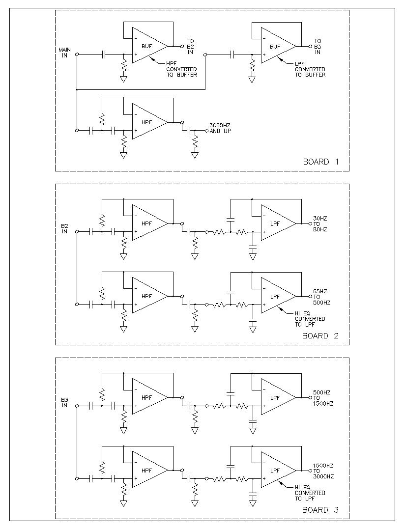

So if I need three boards, the load to the source is split again to 3.125K, which is too low? Then I don't see how I can use three LXmini boards, but I am probably missing something.

My concept is attached. It does require a lot of circuit board hacking. That is, cutting traces, adding jumpers, etc.
If you want to minimize board hacks and not use the HI EQ sections, you might also consider changing all the input trim pots to 100K, using 3 boards, 2 with only a bandpass filter and the other with a bandpass and a high pass for 3000HZ. You would need your external subwoofer crossover but as long as the input impedance was 25K or more you should be OK. You might be able to keep the input trims at 50K. Since the DIYstore only sells the boards with JFETs you would not be using almost half of them.

Thanks again, will try to simulate this eventually.
And here is how to do it with no board hacks required.
