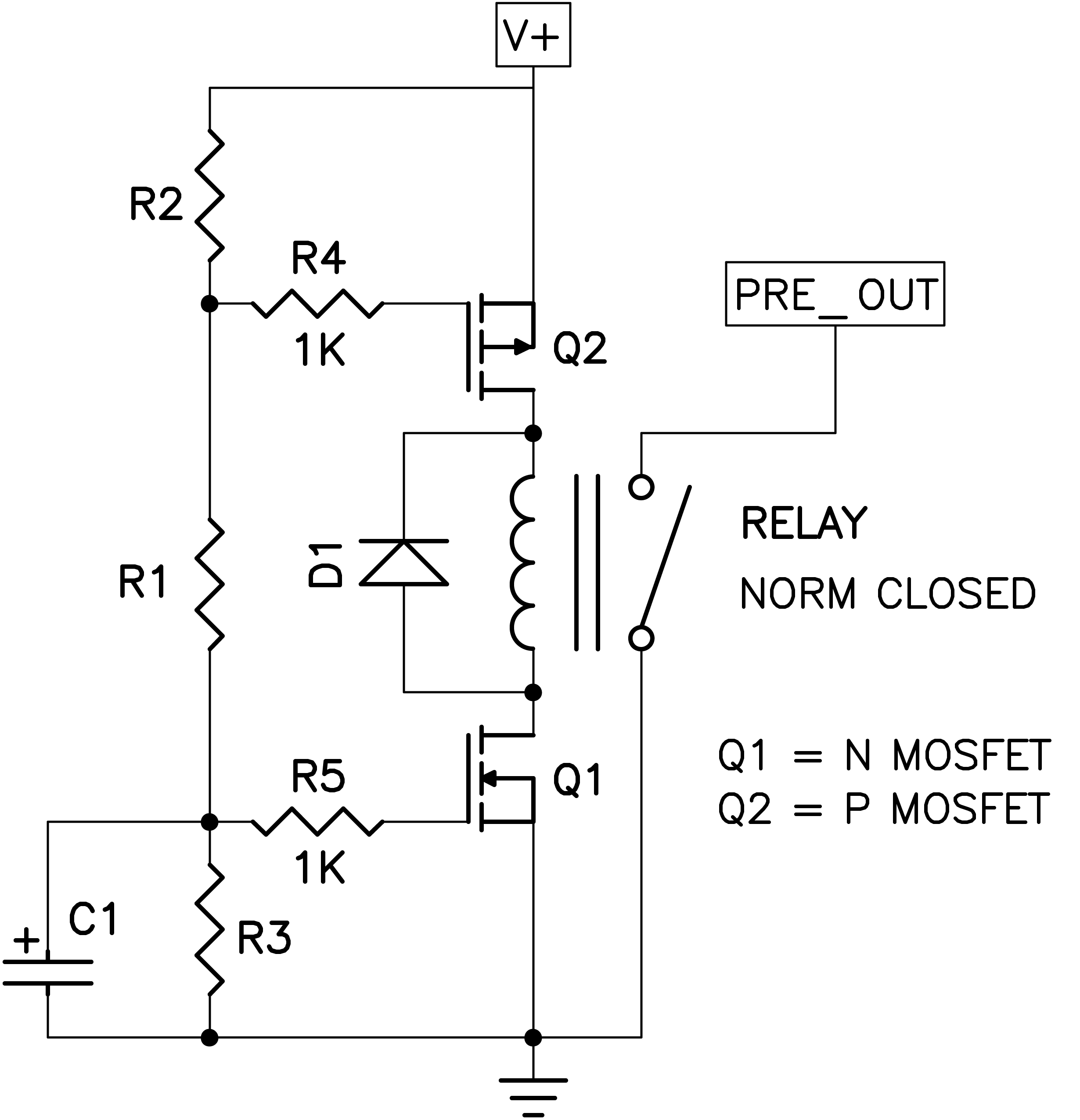

You can always put relays at the output if you are concerned. I have an
easy circuit for slow-on / fast-off relay driver.
I would love to see your "slow-on / fast-off relay driver circuit. I didn't see it in the articles at First Watt. Can you share it?
Jac
Here it is. R1, R2, and R3 are chosen to be high impedance so as to slowly charge C1 and activate the normally closed relay. 47K for R1 is maybe appropriate.
You want to develop about 5 volts max on the N channel Mosfet Gate, which should be more than enough, and you don't want much excess on the P channel Gate voltage, as that will slow down the turn-off when the supply voltage drops.

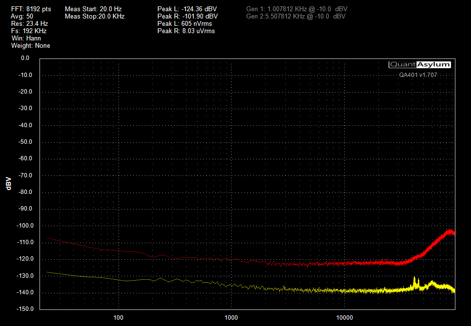

For reference, this is the difference in noise floor between the LXmini-ASP and a 2x4HD unit. ASP...yellow. DSP...red. (The miniDSP unit employs some noise-shaping.)
It's certainly noticeable in bench testing, but really shouldn't be in actual usage. With my 2x4HD unit connected in my setup, I can only hear a faint noise from the LXmini tweeter with my ear just a few inches away. And some of that is power amp idling noise.
Also, take a look at Amir's results in testing the 2x4Hd unit over on ASR.

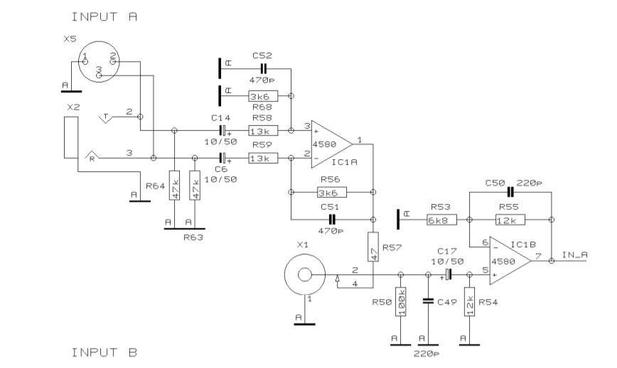

Interesting that pin 2 of XLR or Tip of 1/4" (I assume with pin 3 and/or Ring grounded) would work better. Maybe because the separate RCA input circuit is set to an input impedance of 100K ohms (see schematic).
No, the input impedance of the RCA connection is 11k ohms.
The XLR input is a straightforward differential amplifier. Either pin 2 or pin 3 could be grounded and the same result would be expected. Except for polarity, obviously. For info, with the gain control at maximum CW, the voltage gain of the amplifier is 39db via the RCA input, and 27db via the XLR input. That can also be seen from inspection of the IC1A stage.
