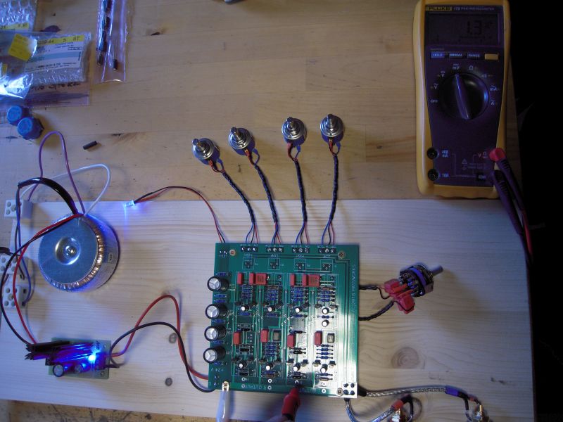

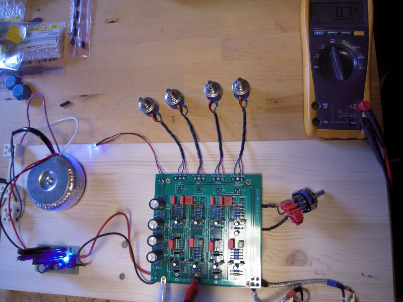

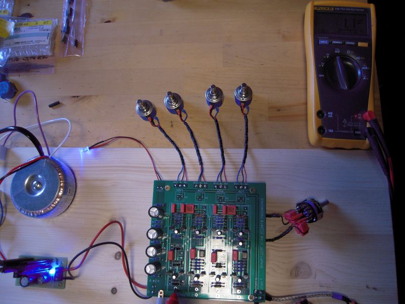

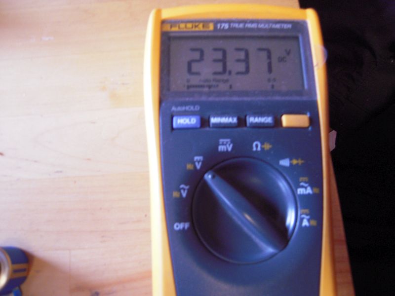

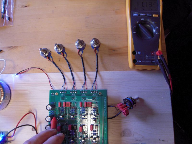

PASSWORKS AXO custom - first run

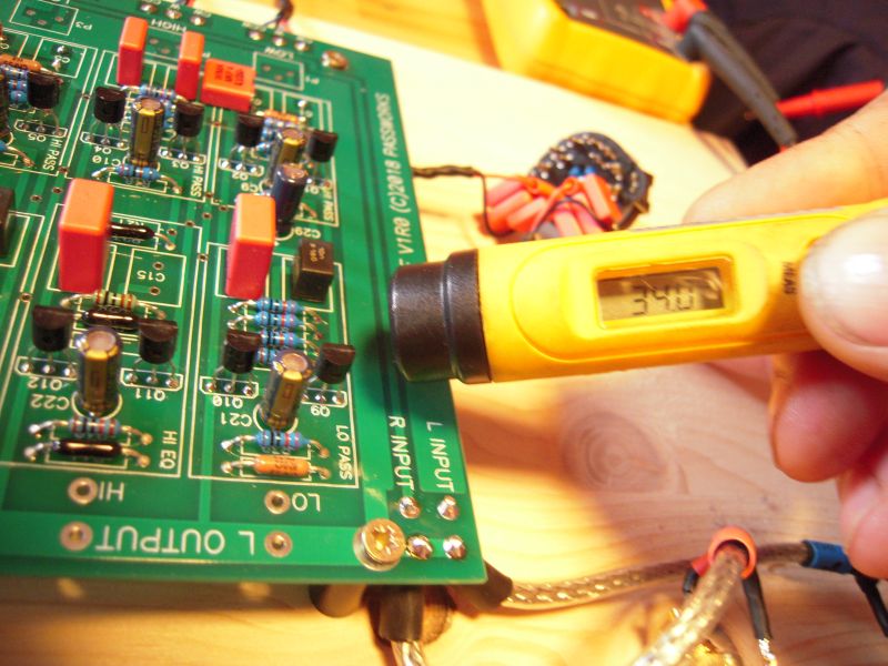

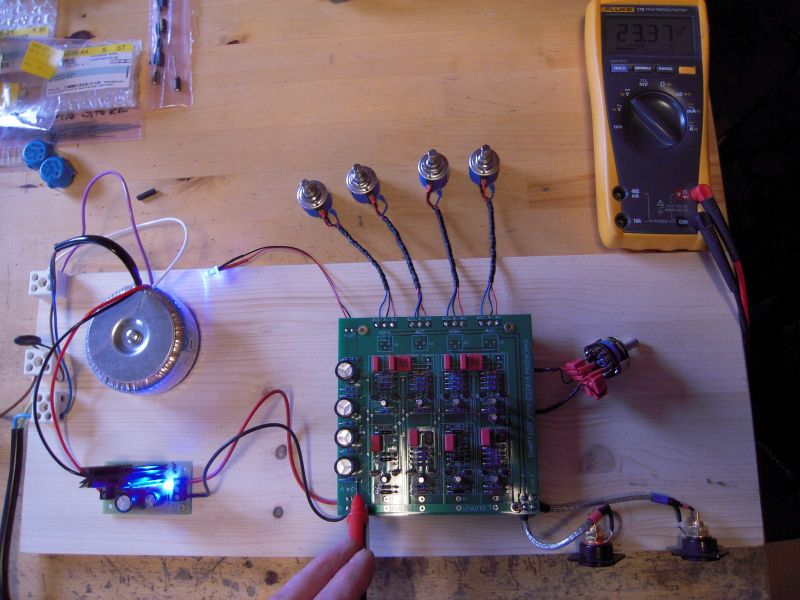

Hello members,
fired up the PASSWORKS AXO first time today. PSU is at 23,37 V under load. I have some offset at the outputs (between 0,7 to 1,3 mV). Will send some sine waves through it. JFETs at 33 - 37 C (temperature).
Greets,
Dirk

There's a 10k load resistor on the output caps which should drain any residual, so you should measure essentially zero DC offset.
My board measures about 100 microvolts DC (with no signal present) on all the outputs using my Fluke DVM.
Dave.

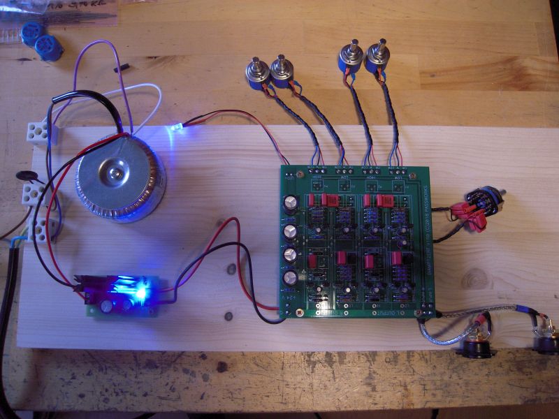

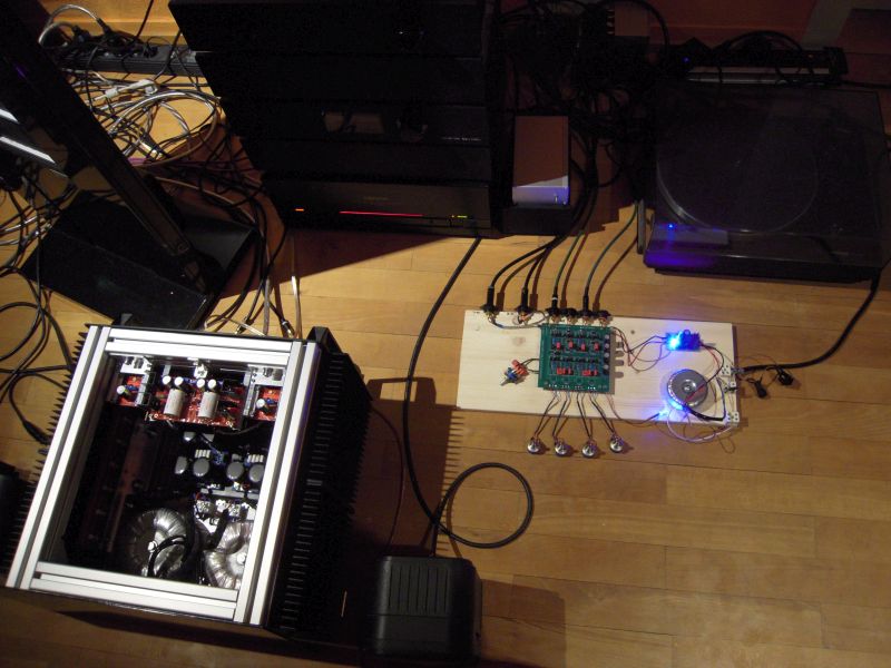

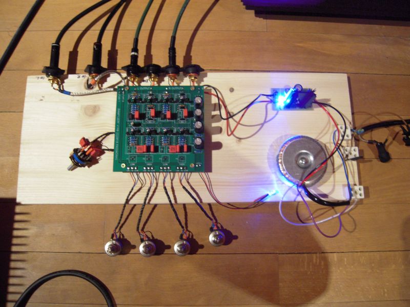

Passworks AXO custom - playing music first time
Hello forum members,
the Passworks AXO custom is playing music! I am running it in. Only playing the LOW-output at the moment (50 - 2500 Hz). Waiting for some new loudspeakercable to wire all fully active.
First impressions are very good.
The baby works! Thanks Nelson Pass!
I measured all the values over the resistors and measurepoints described in Nelson Pass article. Everything in the range. Nice! Very nice machine! But all is still on the wooden proto-board. Next step soundcheck - then lets build a case.
