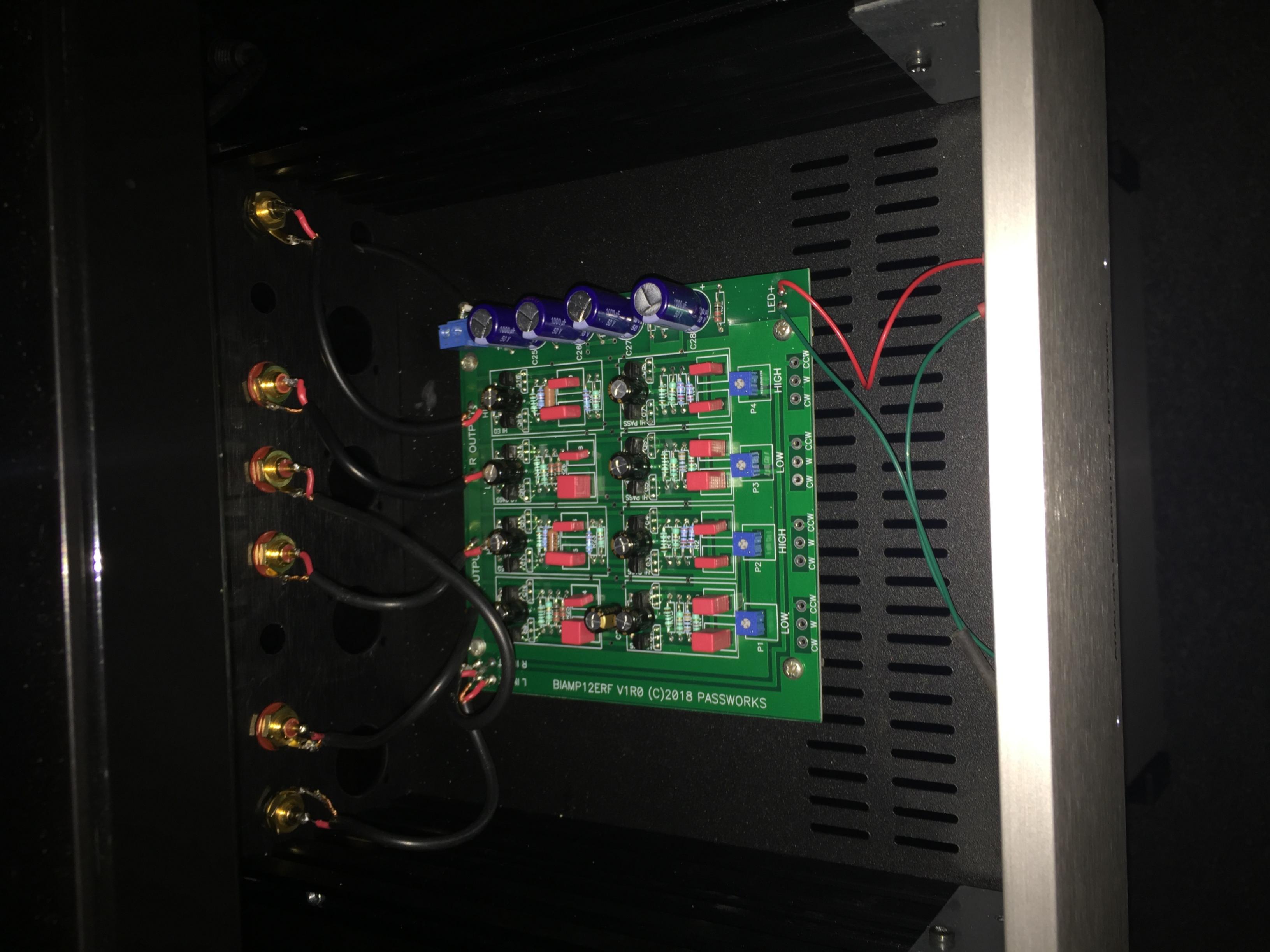

With your First Watt preamps and x-overs, with the external PSUs, do you connect the grounds of the RCAs to the chassis at all? Are these chassis' floating with regard to ground?
Thank you
The RCA ground gets attached to chassis.
Thank you.
My first preamp many years ago had the RCA screwed directly to the chassis. Later I used insulated washers, but had a star ground like concept wiring the RCA grounds to the chassis ground point of the grounding binding post (originally for turntable’s ground).””

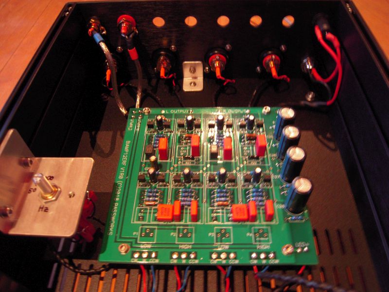

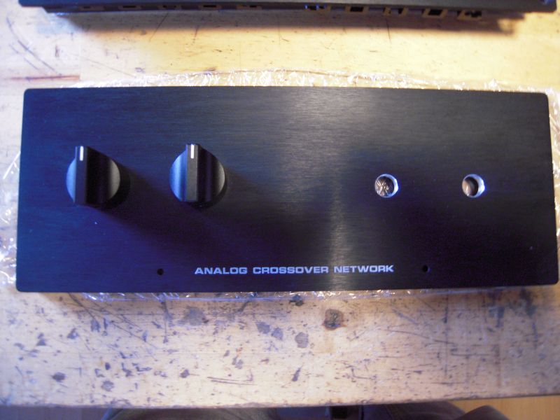

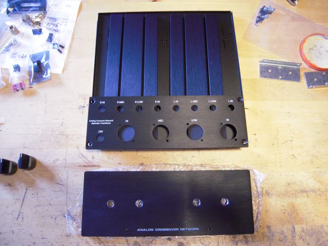

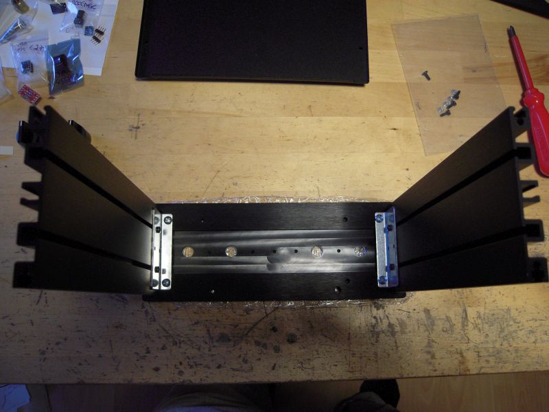

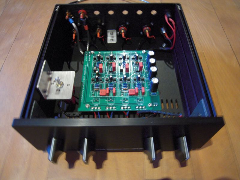

PASSWORKS AXO custom - case

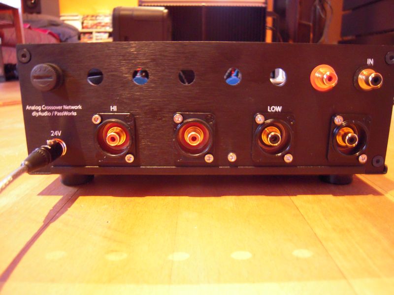

Hello diyAudio - members,
I've got my christmas present earlier this year. Santa arrived with a Ferrari and was only speaking Italian. He throw a nice pack of aluminum from Modushop - Italy into my direction. He leaved with spinning rear wheels and said: facere! Do it! I couldn`t answer - he was to fast! I think he is busy these days.
So I started to build the case for the diyAudio/Passworks AXO. Some pics and impressions.
I wish you all a relaxed and peaceful christmas! Listen to your beautiful selfmade soundmachines.....
Greets Dirk
Greets Dirk

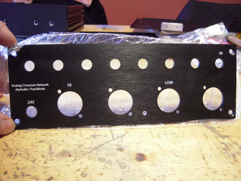

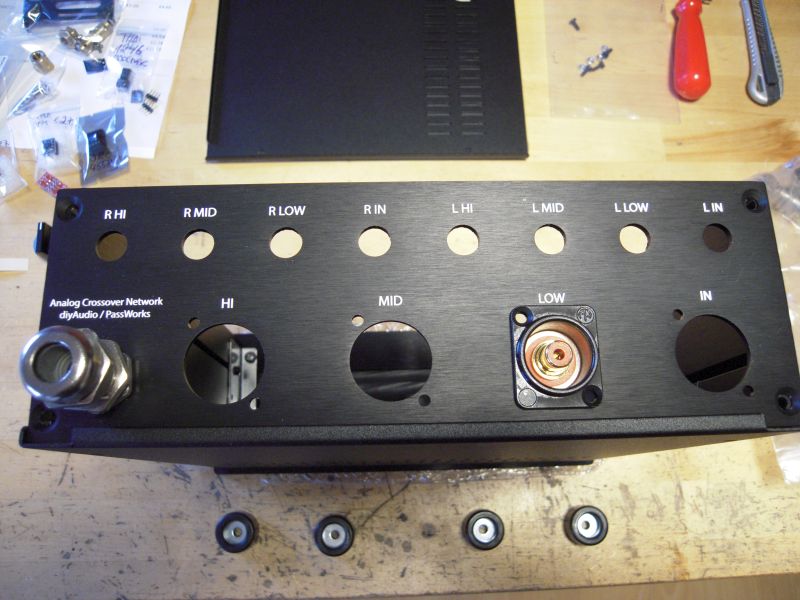

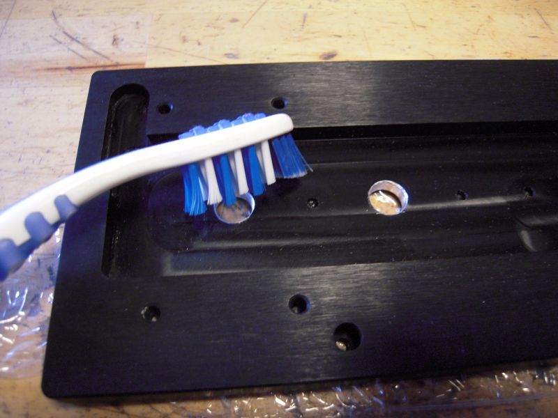

Getting the printed lettering of the in/outputs off the backpanel was a real pain!
Without making scratches to the beautiful case. 🙄

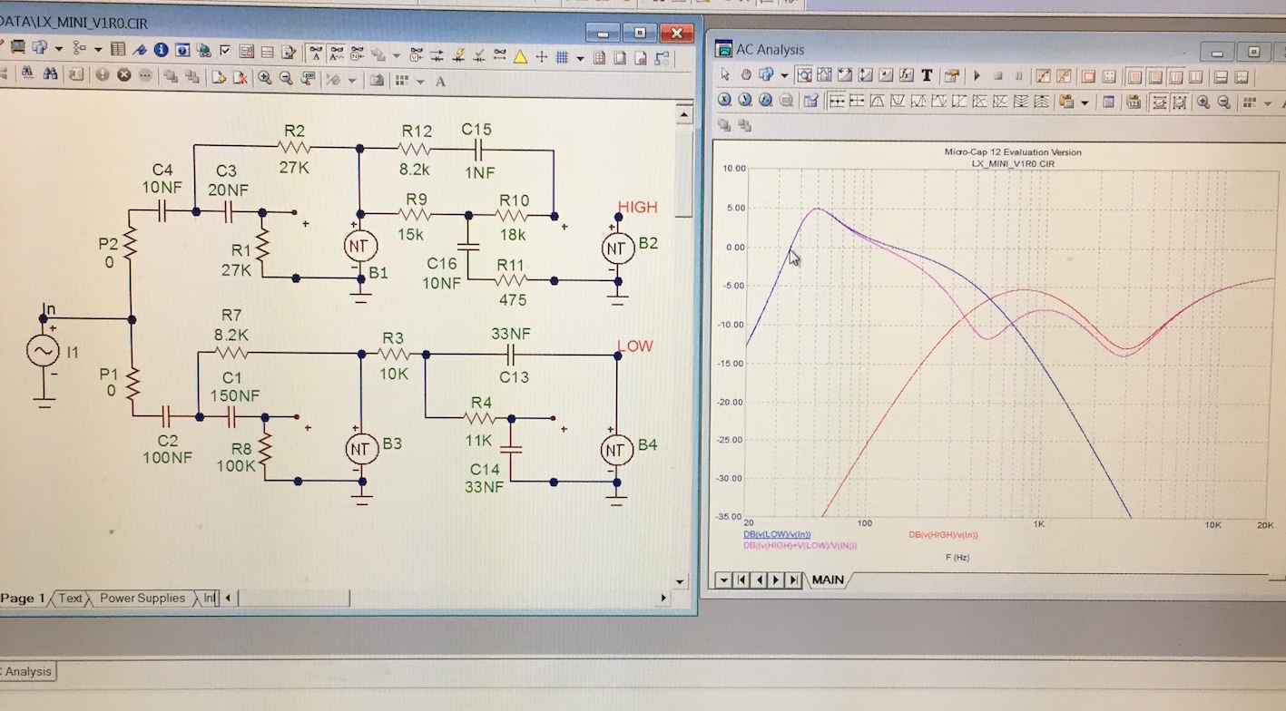

I tweaked mine for 500Hz (C3 and C13) I hope this is OK if not please feel free to pile in and chastise. I can get away with the stock 600 Xover...I think.
Have a good holiday and new year DIYers...

Why??
Dave.
Only because I run these TRIOs at 500Hz ...
I built it with the stock 600Hz anyway to start with....
Yes indeed Father.... I love them....happy xmas to you and thanks for the xover, early hours but sounding real nice...Aaaahhh. The lovely SALs.
Sorry. I keep forgetting many people aren't actually using the kit for LXmini's. 🙂Only because I run these TRIOs at 500Hz ...I built it with the stock 600Hz anyway to start with....
Dave.
Sorry. I keep forgetting many people aren't actually using the kit for LXmini's. 🙂 Dave.
No prob...seasons greetings.... have a good day.

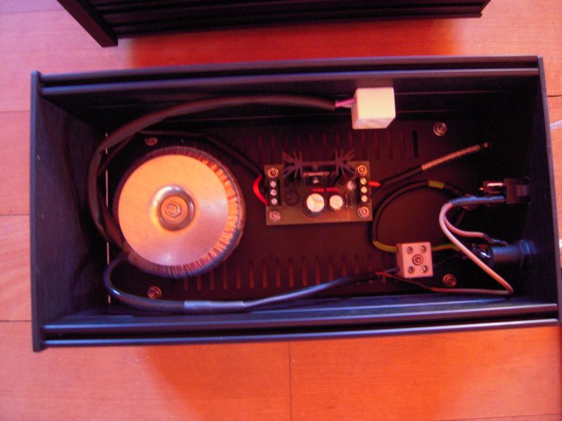

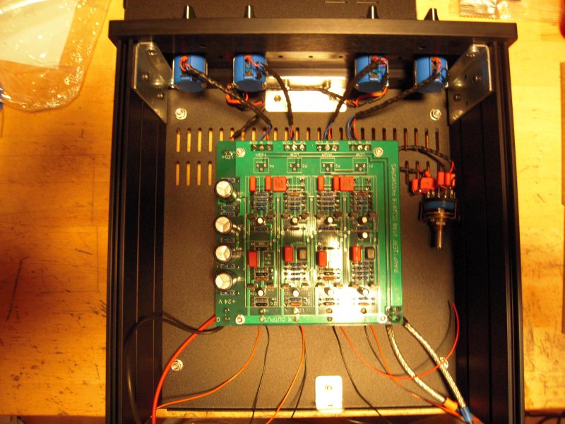

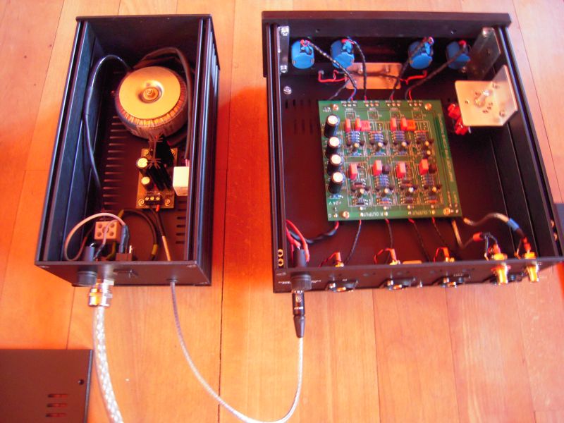

PASSWORKS AXO custom - close to be finished
I worked some more on the AXO custom. Finished the seperated PSU.Simple linear regulated Supply.Most of the assembly is done. Will make some of my first listening impressions next few days.
I wanna report....
Greets Dirk
I wanna report....
Greets Dirk
