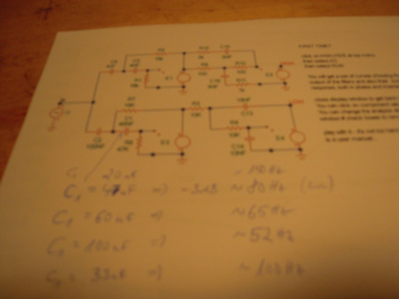

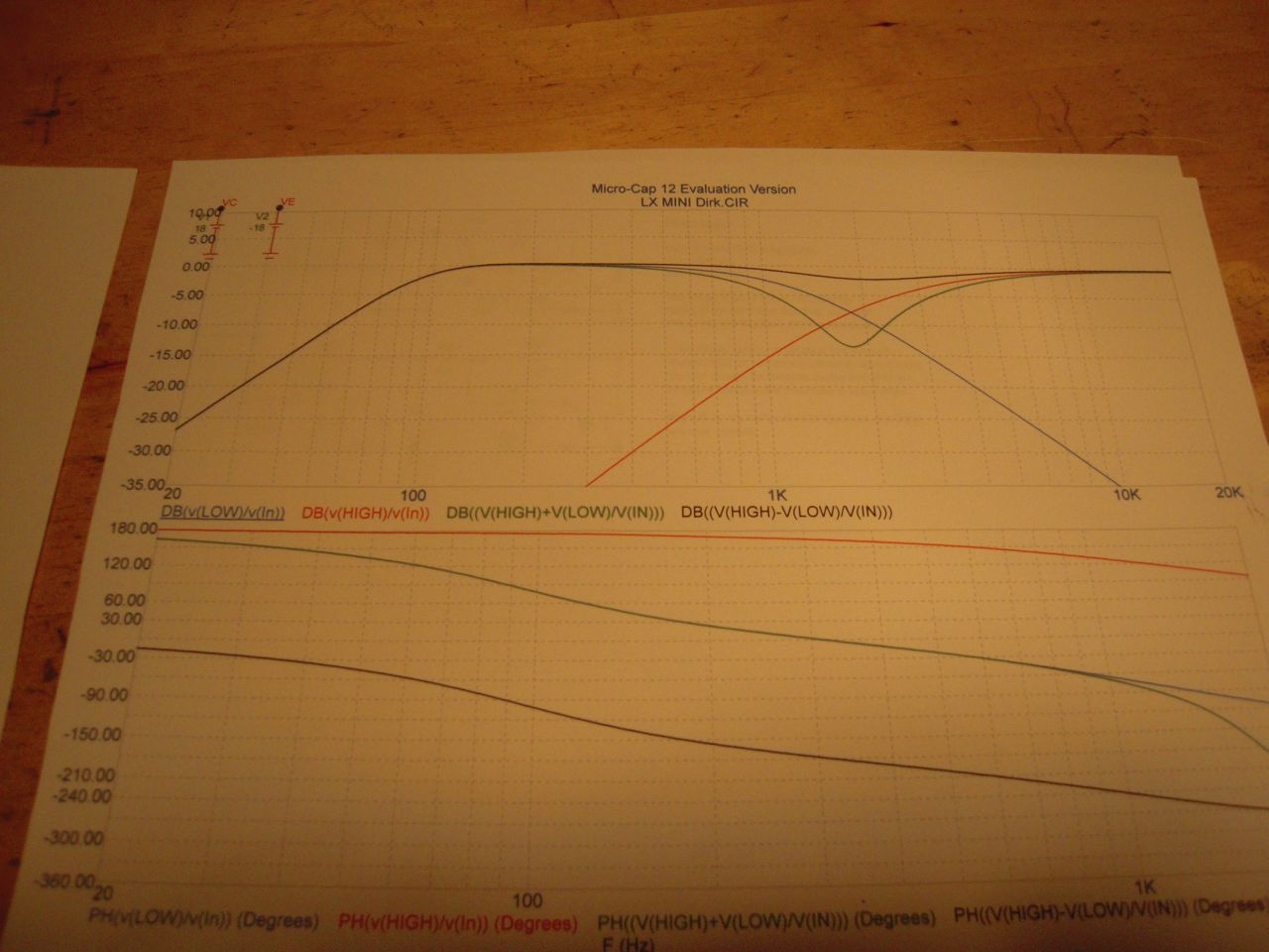

This sunday morning I was playing with MicroCap and LTSpice Nelson Pass is offering to us. Thanks! Big fun!
I want to get a bandpass between 80 Hz and 2500 Hz (for the mid-bass). Playing around to make the lower crossover point switchable (50 Hz /65 Hz/ 80 Hz / 100 Hz) by changing/ switch C1.
The highpass from 2000 - 2500 Hz up for the tweeter. I forgot to make screenshots. My present values are:
Highpass:
C4 4nF
C3 4nF
R1/ R2 18kOhm
R12 0K
C15 0nF
R9/R10 100 Ohm
C16 3nF
R11 1kOhm
Low / Bandpass:
C1 switchable 100nF = 52 Hz (-3dB)
60 nF = 65 Hz
47 nF = 80 Hz
33 nF = 100 Hz
C2 100nF
R6 47 kOhm
R7 15 kOhm
R3/R4 10 kOhm
C13 15 nF
C14 10 nF
Till now - only simulated! Need some new caps....Sorry for the bad pics.

The crossover points i need are configured but ; they can easily go changed ; maybe a way to modify those crossover points by using a potentiometer or fixed resistors would be great. I also found that in simulation AC->Slider can create a pot out of any resistor allowing a almost realtime curve update.
see the archive here
Edit:
and screen shot; see sliders on right side 🙂 :
