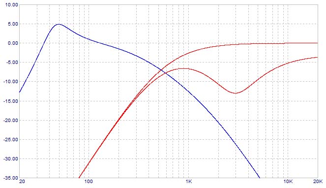

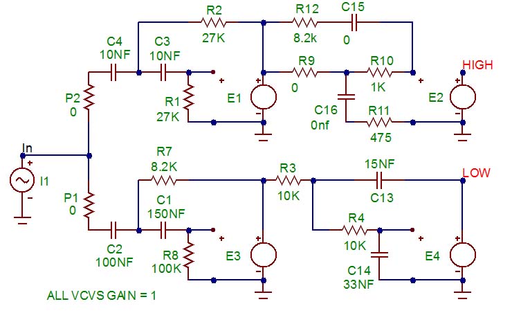

Here is an example.
On the Analysis Limits page, which you see when you press "RUN",
You add two more lines, like the other two, but with
DB((V(HIGH)+V(LOW)/V(IN)))
DB((V(HIGH)-V(LOW)/V(IN)))
and you will get the summations for + and - phase
My current crossover has op-amp buffers and I have set up impedance balanced outputs by adding a matching resistor on the output ground. I see that this circuit has 100 ohm resistors on the outputs. I wonder if the same thing could be done with these buffers to create a balanced output.
Yes, but you need to add the output impedance of the Jfet to the
value of the 100 ohms. If you know the transconductance of the Jfet, then you can invert it for that value.
Example, 40 mS transconductance gives 1/0.040 = 25 ohms.
Looks like that may be hard to measure. Would your example be useful as an estimate for these Jfets to get in the ballpark? Perhaps it is not worth doing. What do you think?
Thanks for your reply.
If you need to bypass a capacitor, draw a wire around it.
If you just want it gone, give it a zero value.
If you need the resistor to be open, give it a 100 Meg value.
If you need it shorted, give it a zero value.
Feel free to experiment with the sims - copy and paste, change values,
draw wires, add new test points, and so on.
If c15 and c16 are “ gone” how does the signal reach the high out? Please clarify.
Two sets of options: You can bypass a capacitor with a wire or replace it
with a wire if you want signal to continue to go through. When you don't
want signal going through, for example when it is a low pass to ground
filter, you set it at zero or delete it altogether.
