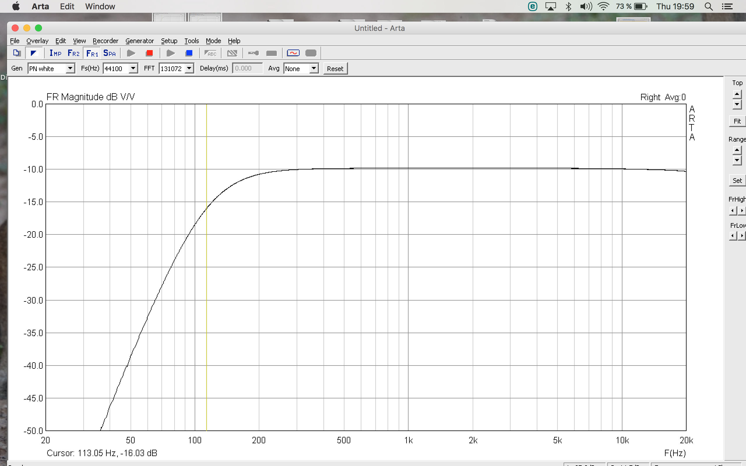

Crossover measurements
Two pics showing the crossover used as a 24 dB/octave high-pass filter
Distorsion at 1 V rms out and frequency response with cross-over at around 115 Hz (Quad ESL57 + and LX521 dipole bass combo)
Maybe not as good as using Toshiba parts but very respectable hi-end numbers.
SQ is wonderful.
I'm happy :)

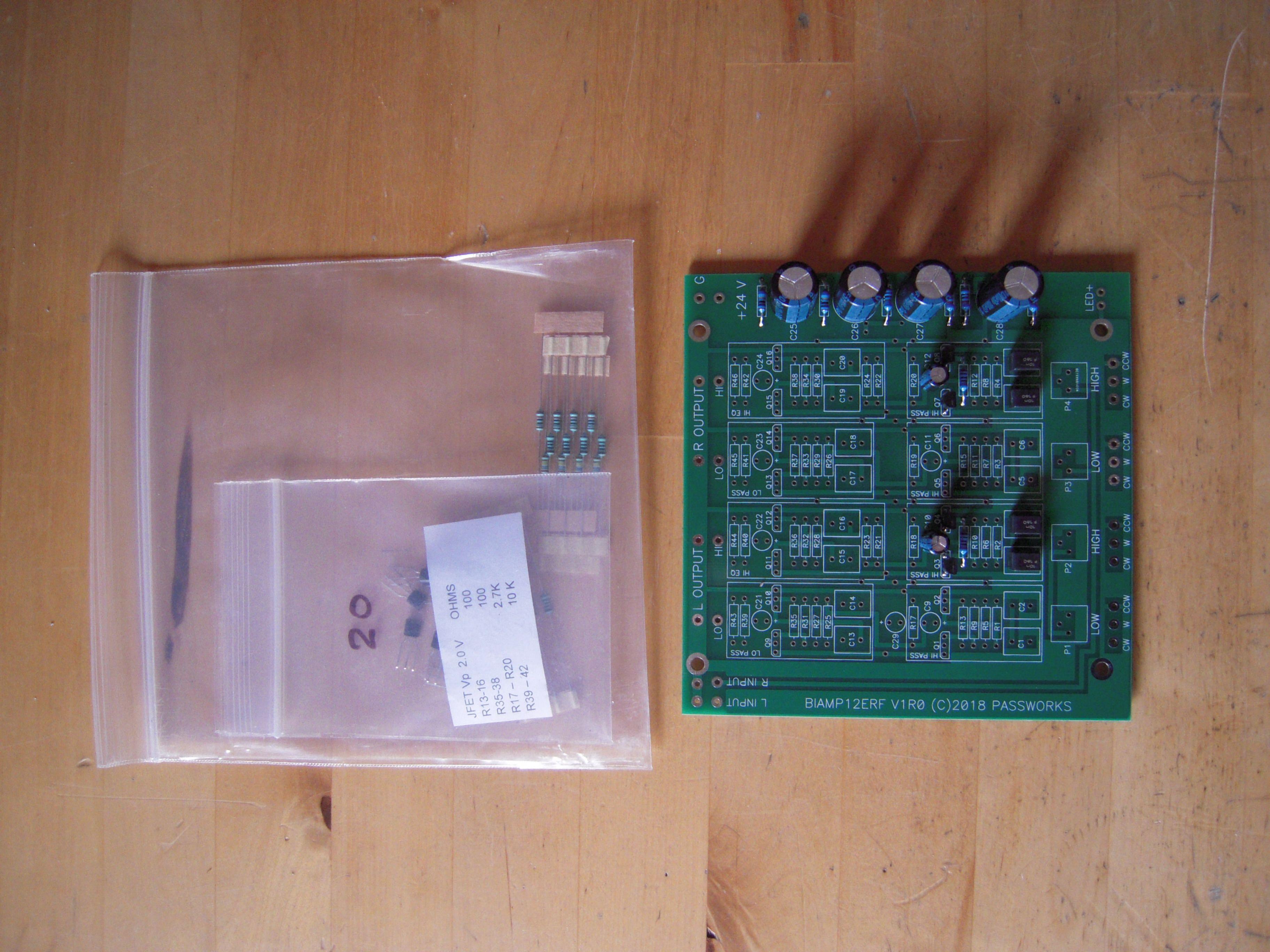

I am providing the kit and finished boards for this. At the moment, I have
a production piece on the bench, and I'm just adjusting the gain figures,
and then I will populate some for delivery in a week or so.

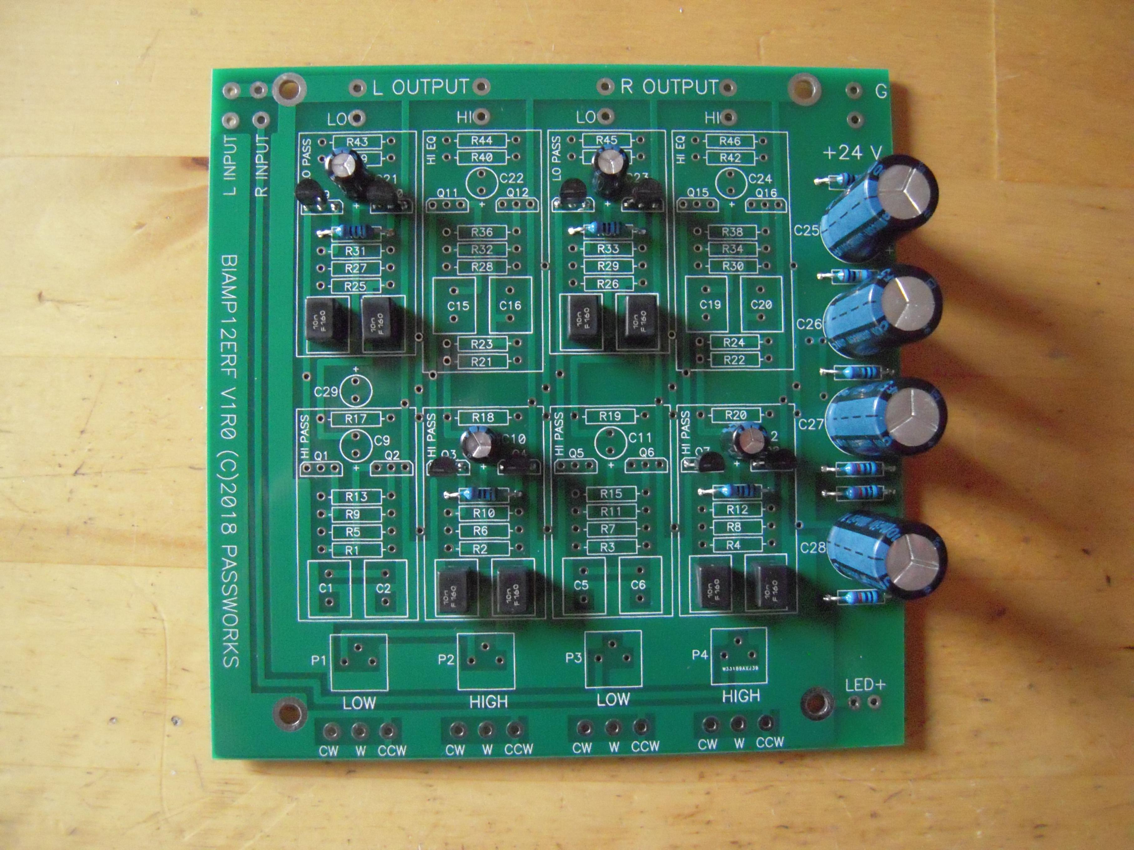

PASS AXO starting my build
I wish you all a welcome on the forum and always enough voltage and current in your projects!
I have started my crossover build in a different way. I don't want to use it for the LXmini.
I will use it as a 2-way-crossoverin my own speaker build. (crossover frequency will be around 2500Hz).
I am thinking to use the bandpass on the board (LOW output) between
80Hz and 2500Hz. I will make this switchable between the two filterpoles.
Gives me the possibility to add a subwoofer later.HIGH output will be used
above 2500Hz without the equalization network.
But I am at the beginning of this `journey`. Greetings from Germany
Dirk

Could the board be fed with +/- 12V supply instead of the 24V, since I already have some of the parts to do that? Anything special that would need to be done?
The board has a midpoint voltage reference for biasing the Fets, and
ground is what you might think of as the negative rail.
If you're not using that supply elsewhere and the ground is isolated
then you can drive the board with the -12V being ground and +12 forming
the positive rail. The ground of the power supply is best left unattached.

You can easily operate a stereo single ended crossover like this as mono
crossover balanced.
The MagicLX521 does the conversion with extra circuitry and also offers
both LXmini and also the two subwoofer versions, which makes for a
large circuit board.
I am informed that a board + fets kit will be offered by him as well.
Down the road, probably a similar but more basic kit will be offered
through the store.

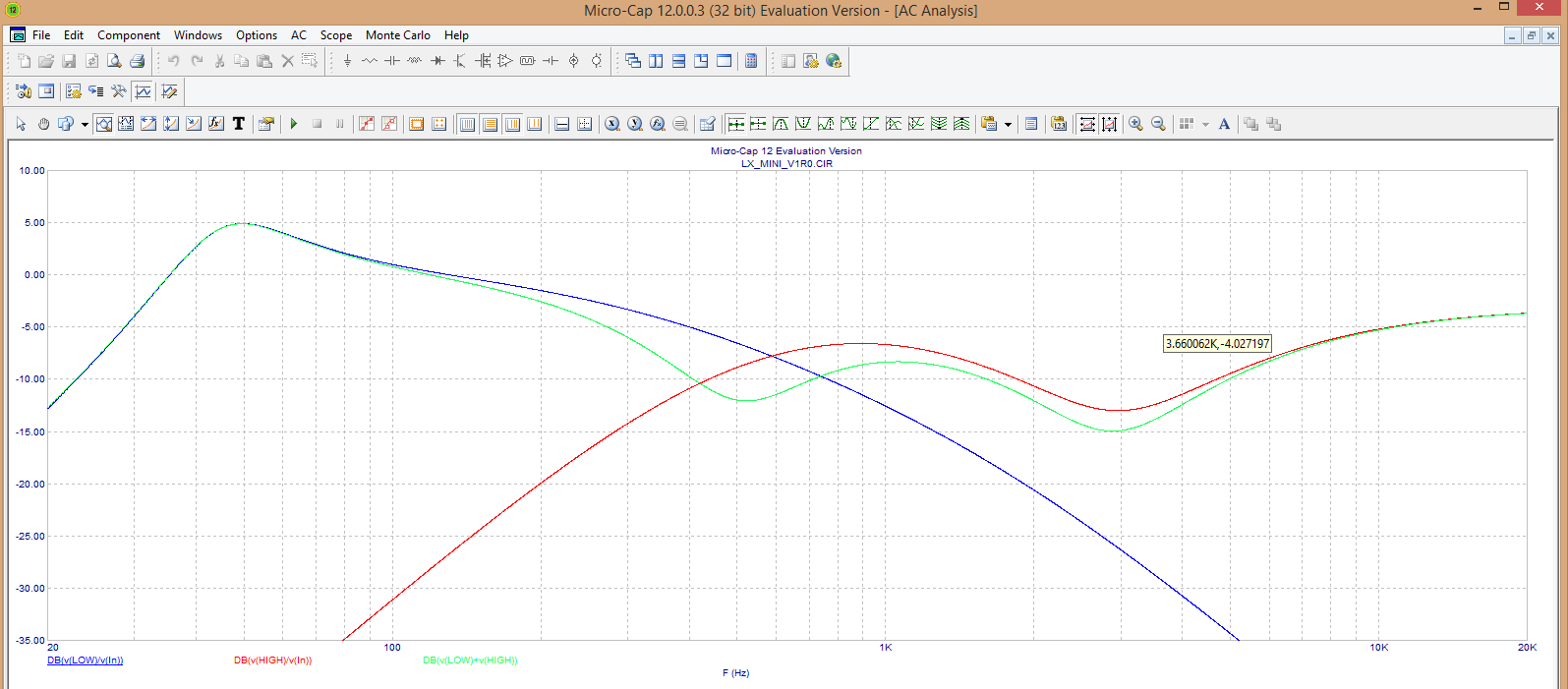

Hello,
I would need help obtaining a resulting trace from the FW miniLX micro-cap simulation. A cumulated response to be more precise.
To the best of my knowledge and from the LTspice simulation experience of my speakers passive filters, I added DB function to the sum of the resulting voltages or the logarithm of the resulting voltage amplitudes (that giving the form of the resulting equalizing curve to the best of my knowledge).
micro-cap simulation resulting cummulated response attached:
The question is :
Is this the equivalent of the sum of the resulting SPL if the amplifier would drive perfect ideal restive loads?
