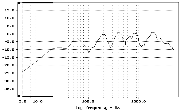

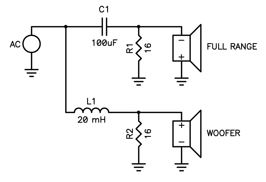

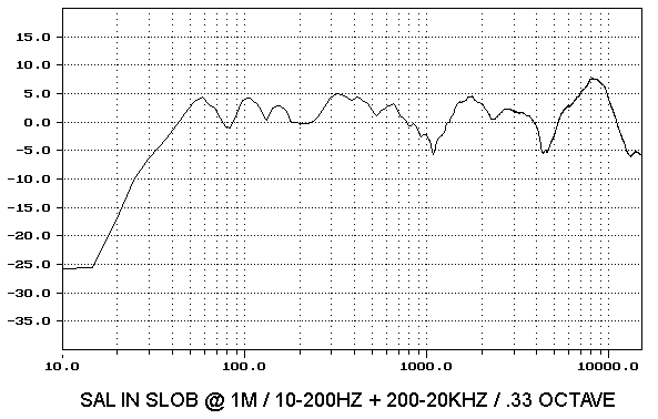

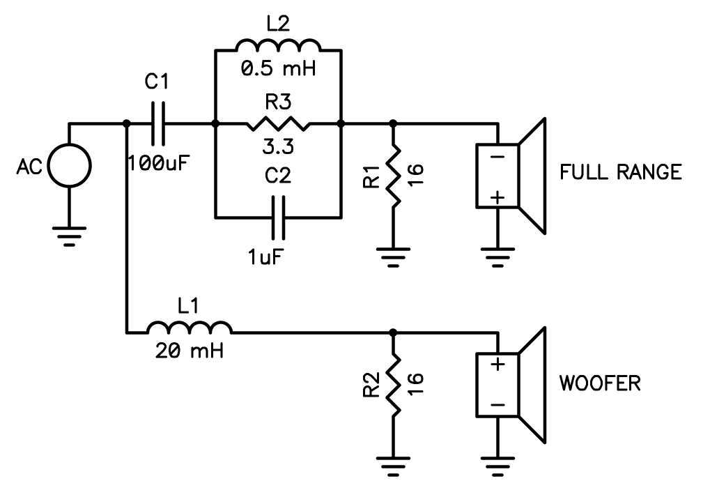

I have some data on this.
First, here is the passive crossover and the passive crossover with
a top end notch filter, both with OB's using the Eminence 15" Definimax,
and the curves for the top end with and without the notch, and lastly
the curves for the bottom end.
Thank you Nelson and Frank. This will give me something to mull over. Nelson, I was able to score some of the last stock of Hawthorne Augie 15" woofers and a pair of SAL fullrange from a forum member.
Dick does indicate the part values needed for the OB3 which is where I am headed. Would the SLOB information with the SAl and Augie pair get me in the ballpark?
David
