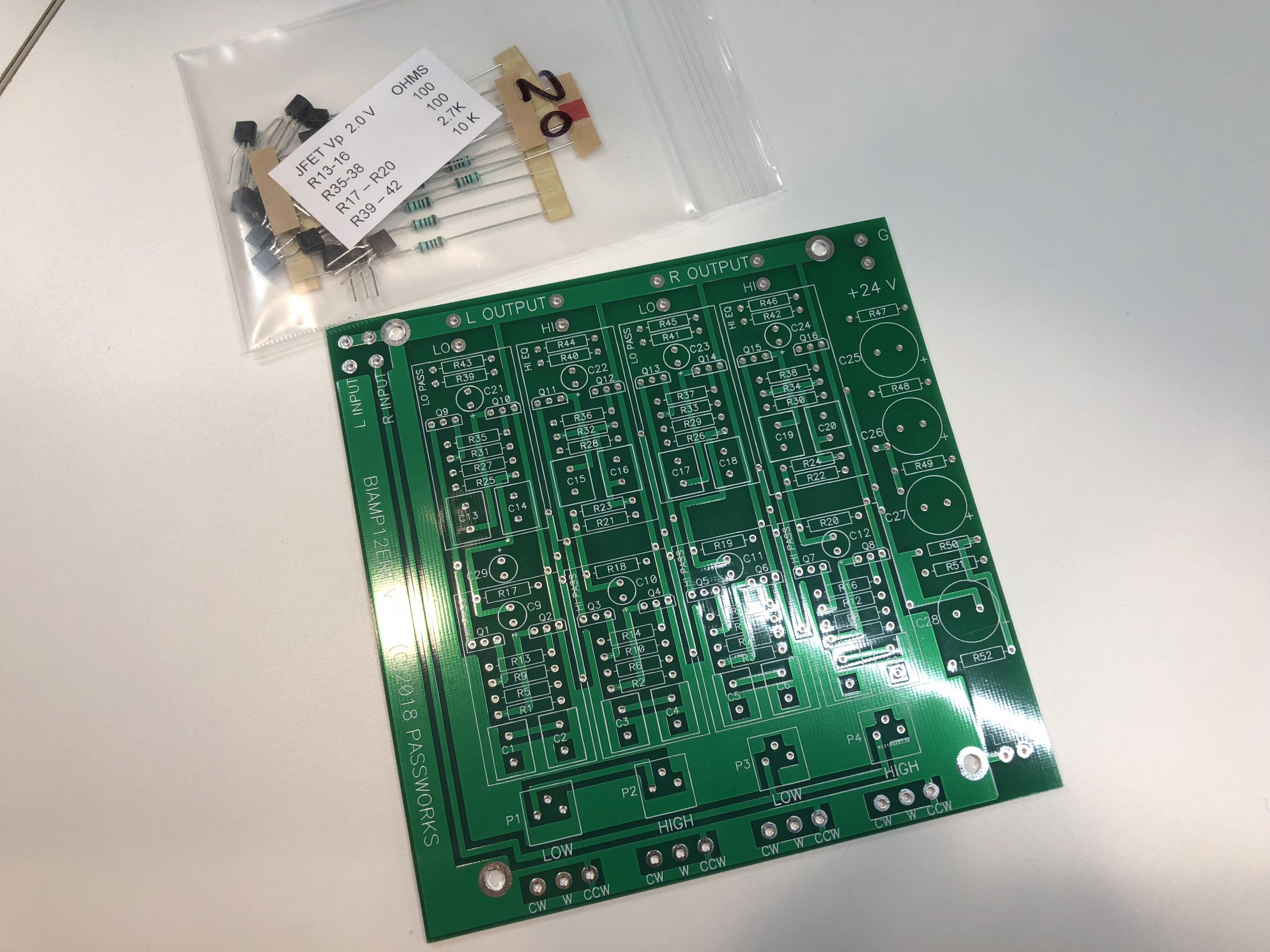

2nd order, the LXmini board will do it fine. Adds option for EQ.
You can check out the MicroCap sim if you want to model it.
Thanks Mr Pass
There are plans for a more general crossover.
The LXmini crossover can be stuffed for a variety of loudspeakers.
You have the board and existing schematic, and I have posted a
MicroCap sim file:
www.firstwatt.com/sims/LX_MINI_V1R0.CIR for you to play with.
You can download the Windows demo version of MicroCap from:
Spectrum Software - Micro-Cap 12. Analog simulation, mixed mode simulation, and digital simulation software. SPICE and PSpice(R) compatible circuit simulator.
and alter the values to see the resulting curves.
After installing MicroCap demo, you click on the file and it launches you
into the screen showing the schematic. On the top bar, click on
Analysis, then AC, then Run, and see the result. You can edit the values
right on the screen, and after a little practice you can be doing this on
your own.

I quickly ran the SIM and it shows that the LXmini Xover circuitry is designed to be at 600 Hz Xover point. I do not see any jumper on the board to switch b/w different Xover frequency.
Please let me know if my assumption is not correct, for a user to select a different Xover frequency i.e 300 hz, or 200 Hz, one has to either play around with the R,C value in the circuit to get to a desired frequency or recalculate the R, and C value and manually solder it onto the Lxmini board ?
In order word, people have to know exactly what specific Xover frequency they want for their stereo system in advance, then play around with the R,C value to get it to that frequency, then finally put together the kit since there's no jumper to switch to different frequencies on the fly as in B4 or B5.
To calculate R,C for Xover LR2 frequency of the Lx-min, do we use formula f-3db = 1/(2pi*RC) ?

In terms of You have to change the capacitor and resistor network in order to change the crossover frequency? Yes that is how it works on this board, the easiest thing to do will be get a $100 mini DSP, play with that until you find the crossover points that you like it, and then make the analog crossover at the points you found worked best.

Upon reading the documentation I have a question: There is a C29 on the PCB, and referred to in the build guide as a coupling capacitor. But I cannot find this on the circuit diagram. Have I missed something? What does this 10uf capacitor do?
