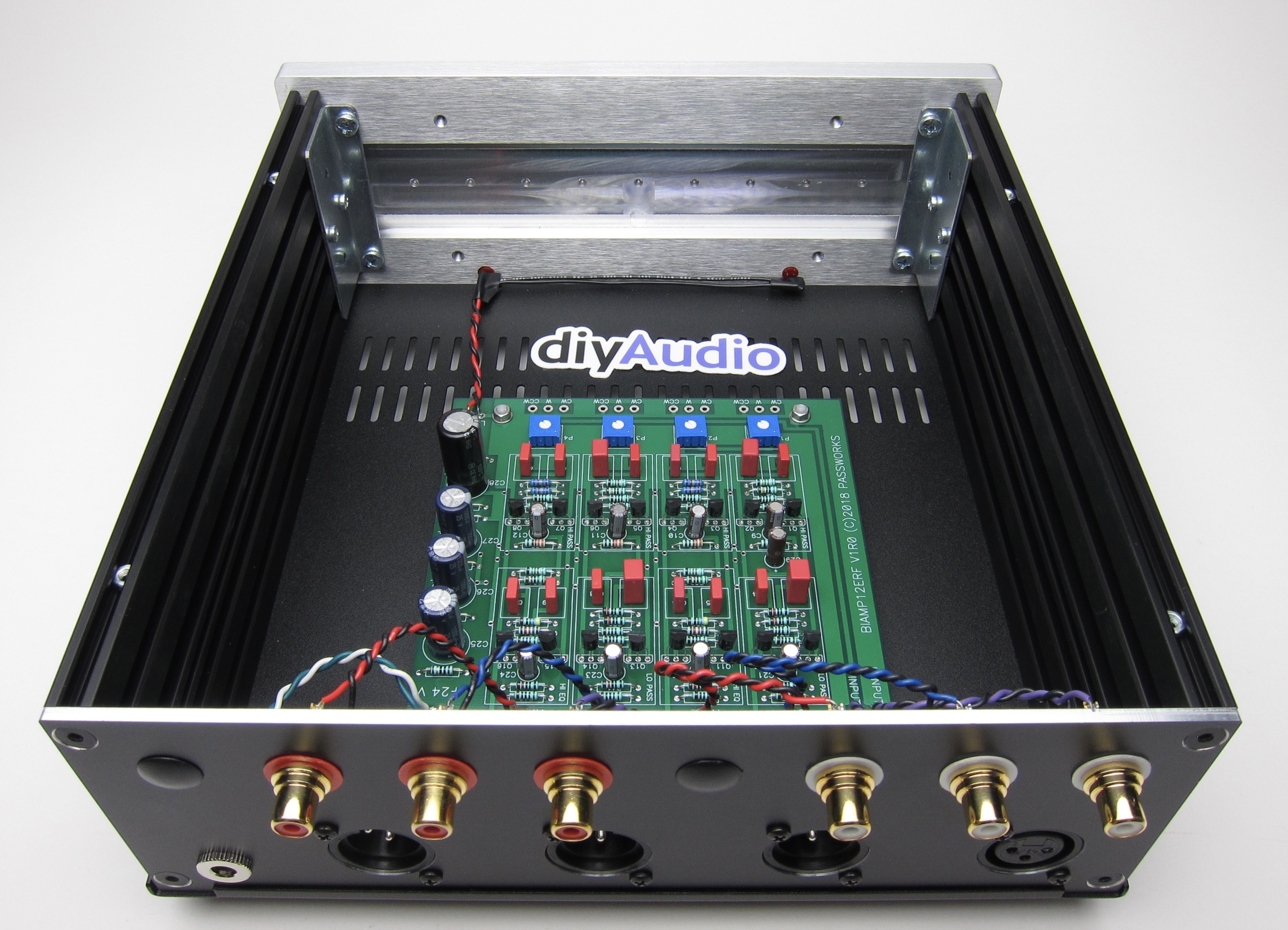

IMPORTANT NOTICE!!!!!
We just got word that the PSU included in the box with the chassis connectors is incorrect.
While it is 24v, the outside barrel of the connector which plugs into the chassis is positive, while our standard is to have the inside contact be positive.
Obviously you can cut the PSU cable to the chassis, strip, flip and solder the wires so the polarity is opposite, which is a way for you to try the crossover out and should work perfectly, but we’ll be sending out the correct PSU (wall wart) to people who have already been mailed their kits. At this time I don’t know if hooking up the PSU with wrong polarity will damage anything. Will update you.
The rest of the kits won’t be sent until we can order the correct part and swap them into the kits.
This will no doubt take more than a week to resolve. We are of course very sorry for this situation.
Mark

Not so easy.
Since the chassis mount power connector (-) is in contact with the chassis,
it's easier to cut the wall wart wires and splice them swapped.
Until the replacement wall warts arrive....
To answer the inevitable question "What happens if I just plug it in?"
Not recommended, but 6L6 did just that without damage, as the wall wart
has fold-back limiting.

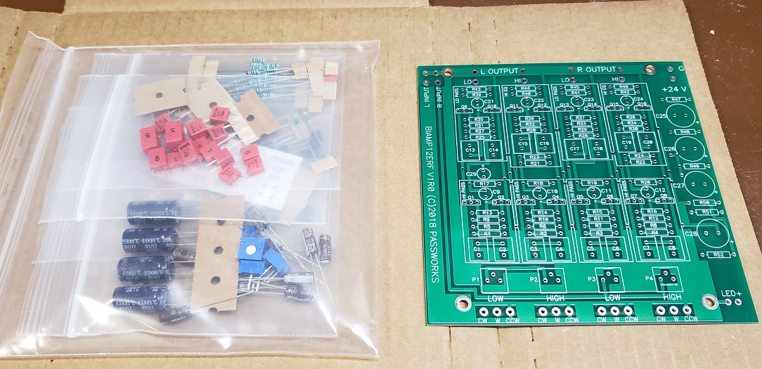

Just received my kits for the Pass crossover. Nicely done. I'll be putting the kit together in a bit. Not sure which chassis I'll put it in yet. I have a fair number of dead preamps that would be good for the purpose. A friend even suggested bringing my old Epicure M4 back from the grave and replacing the active circuits with some of the Pass preamp projects including the LX Mini crossover. I must say that the chassis of the unit was nicely made from black anodized aluminum. But, it is somewhat of a collector item so I dunno....
Finally I must say thanks to Mr Pass for a great kit and Jason and company at the diyAudio store. Filled and shipped the order right away and it was delivered in a few days. Nice.....

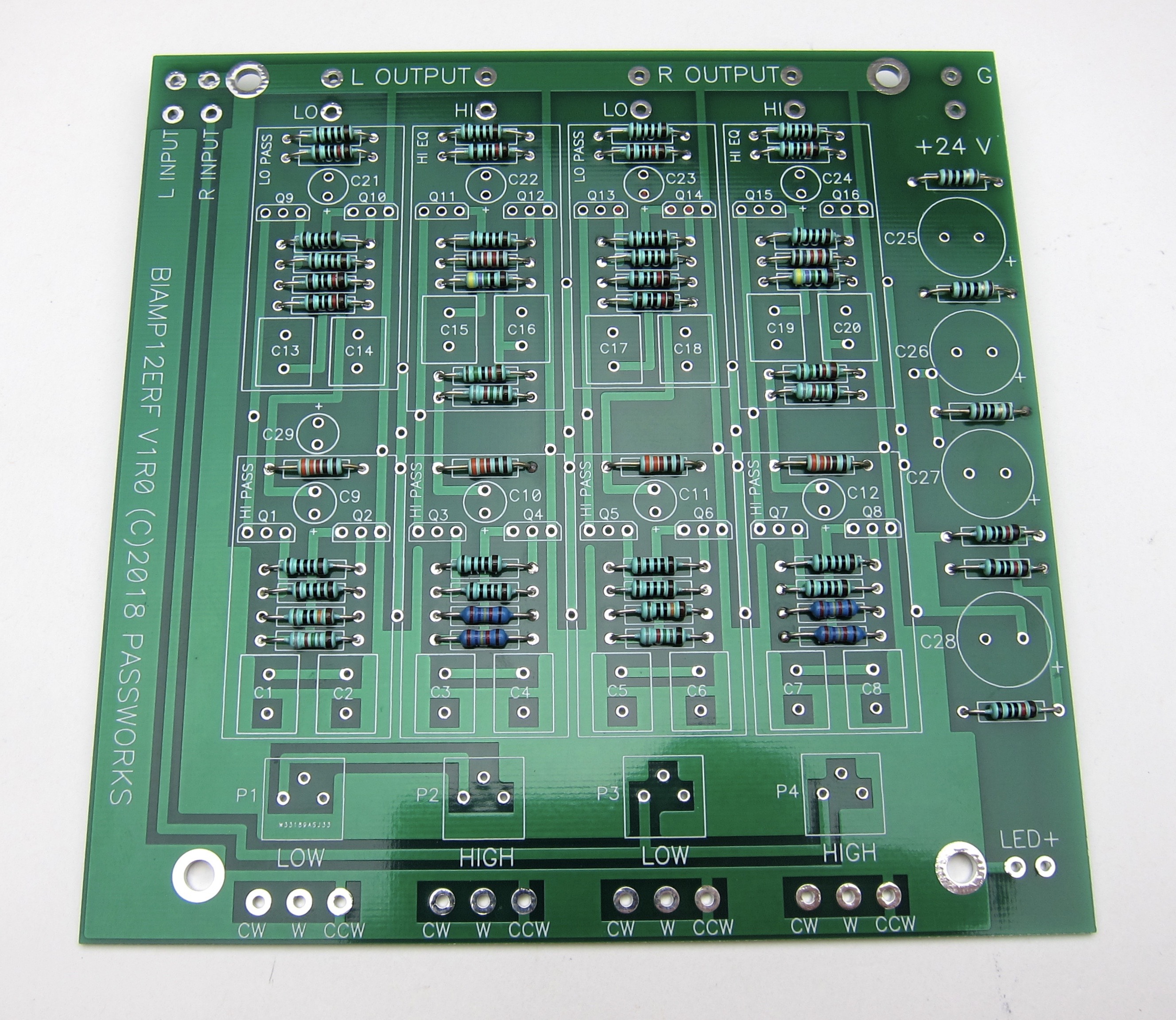

Ready to include this with Whammy as a preamp but can not find dimensions for active x-over board. Anyone?
I'll measure it tonight when I get home and post the dimensions.

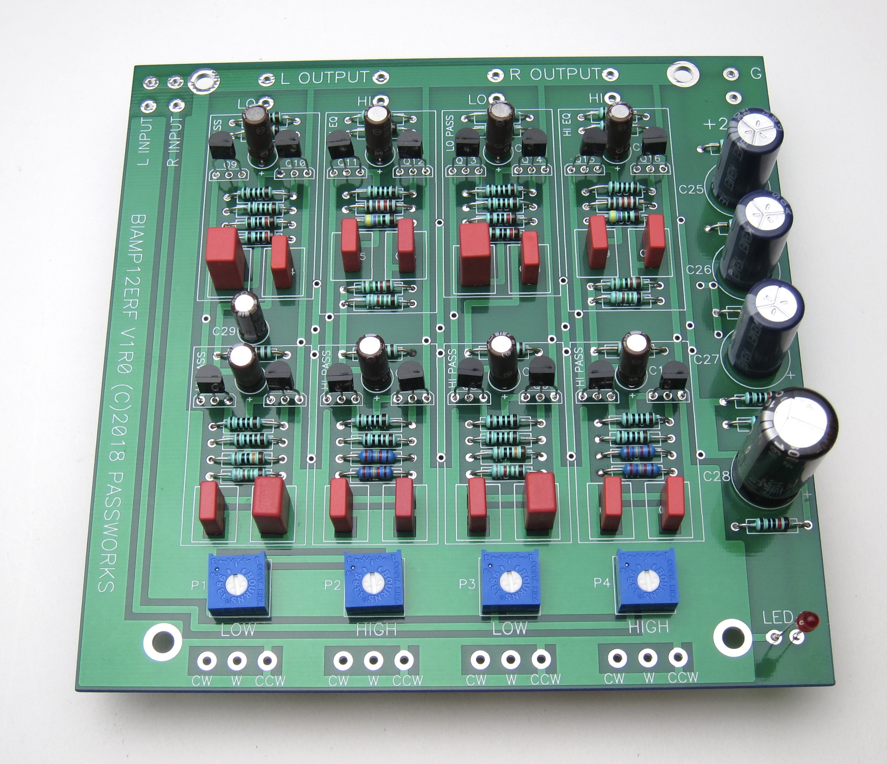

HexFET - You are asking about a PCB for the N/P buffers, using K170/J74 jfets. It, as far as I know, doesn't currently exist for sale. Nelson may have made a prototype that way?? Maybe he has a few laying around ? No idea...
The current PCB uses the J113 Jfets in an all-N channel arrangement with some neat tricks engineered by Nelson to run them right in their sweet spot and get distortion and noise numbers extremely close to the K170/J74 version. It sounds fantastic, and doesn't use $400 worth of Jfet for the 2-way version.
