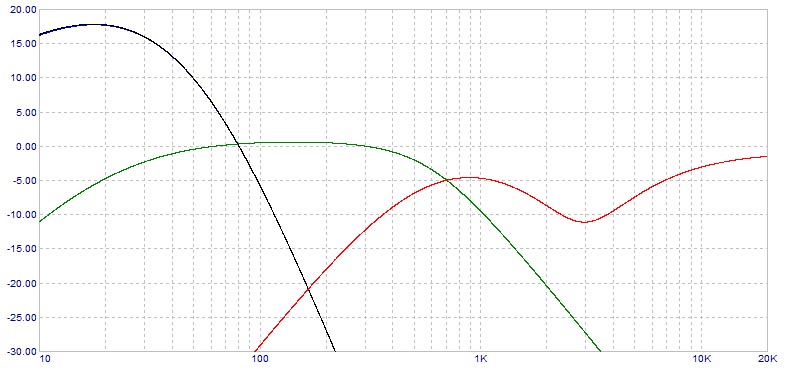

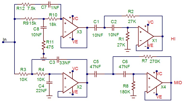

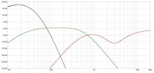

So if I was going to crossover to subs when running an Lx-mini, how would I adjust the lower end rolloff on the woofer? The subs have their own dsp, so I don't think I need the lx-mini + studio.
Thank you, that is such great news! Is it possible to use Toshiba jfets with these boards, as mentioned in the LXMini paper, or do the toshibas need a board with a different layout?
Toshiba's have the gate in the middle: DGS, J113 is DSG.
That's easy. You only need to change some values in the High Pass filter
of the woofer section. I will post something shortly.
Here you go.
On the left you see the target curve.
On the right you see a Microcap sim that delivers the curve for the
high and mid frequencies.
Ignore the part numbers, I don't think they match the boards.
To duplicate the sub curve, you will need a 24 dB/oct filter.
