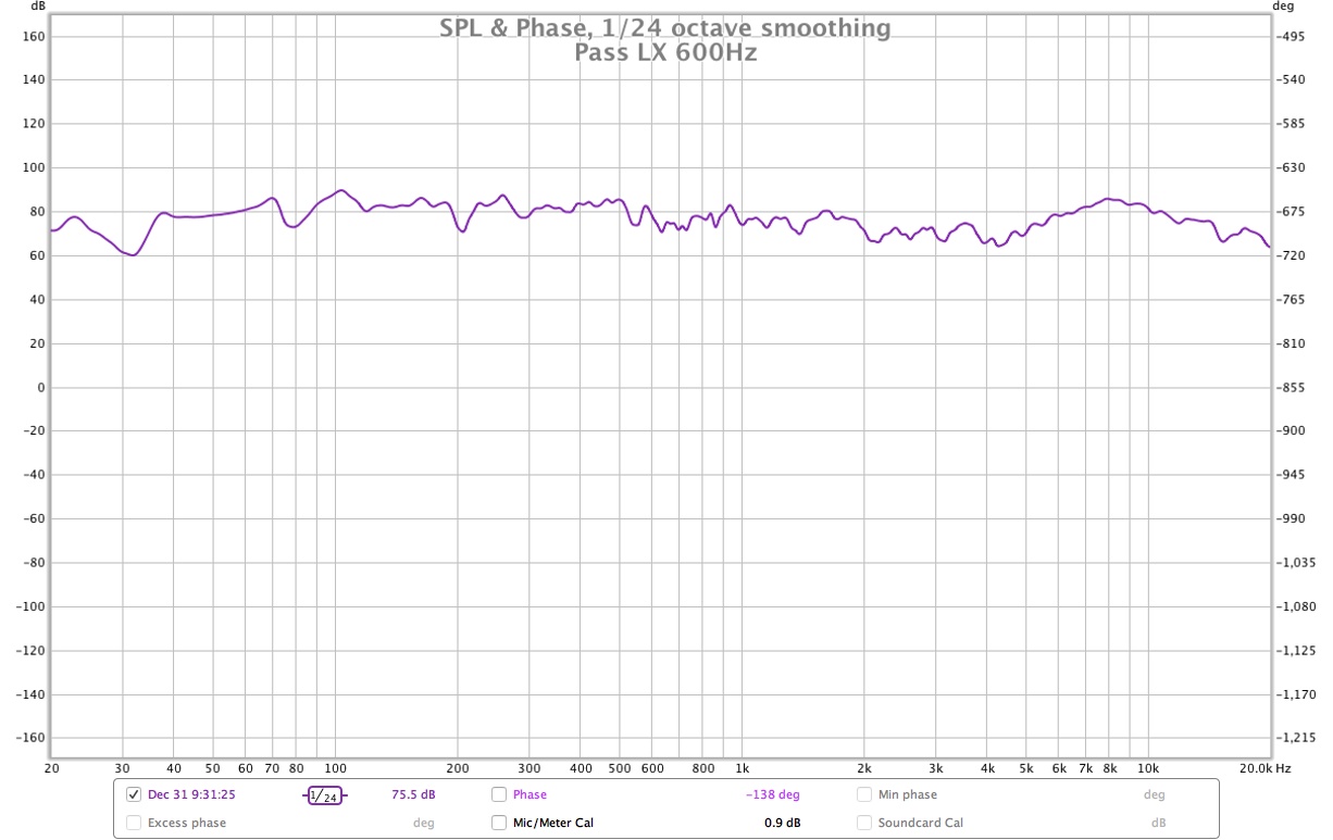

Ive had this little wonder installed in my system for a week or so and boy is it good. I had the time to take some measurements over xmas. The 7k rise is there (as Mr Pass spoke about) but just wounded how to lift the dip (if possible) from 1k - 6k ??
This is an OB trio setup = 2x Emenance 15" and the SAL Full range per side..
TIA
TIA
On the EQ circuit for the top end, there is a 475 ohm resistor to ground
which governs the depth of the dip in the region. Increasing this value
will reduce the dip. Start with 1K and go from there.
Ahh ha, Many thanks...Mr Pass

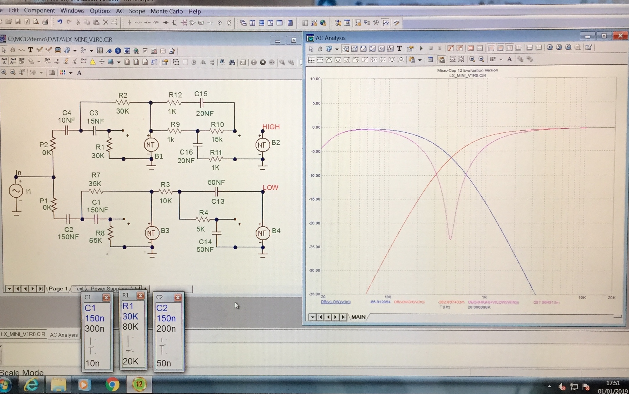

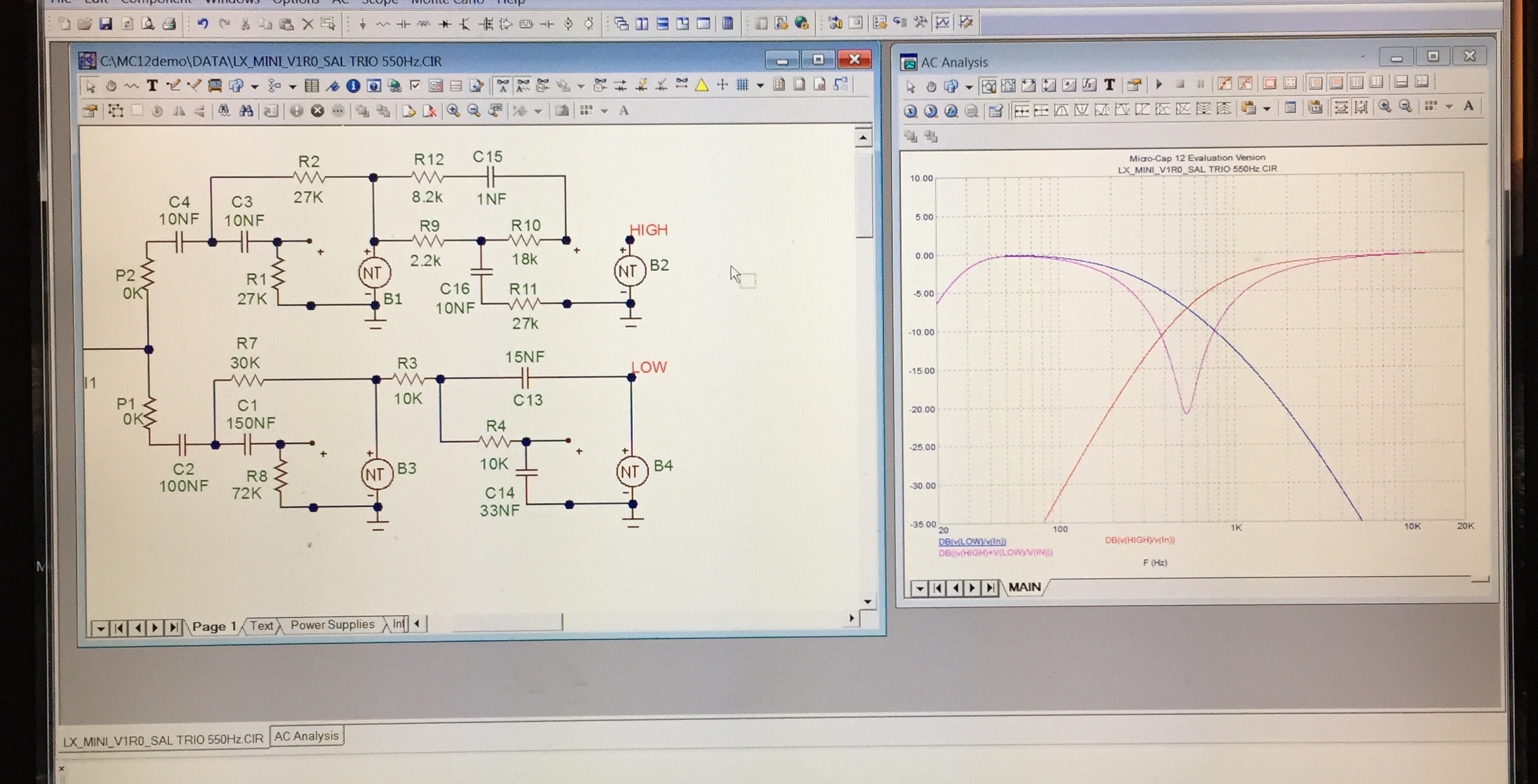

I have managed to produce this (see attached SIM) but am unsure if its up to snuff. This is very new to me and many others I would imagine.
I was aiming for a cross is 450-500Hz at -6db for a TRIO (2 x Em 15" + a SAL FR) All looks very good but the question is aimed at those in the know... will it be OK to populate this BOM.
Many thanks in advance.

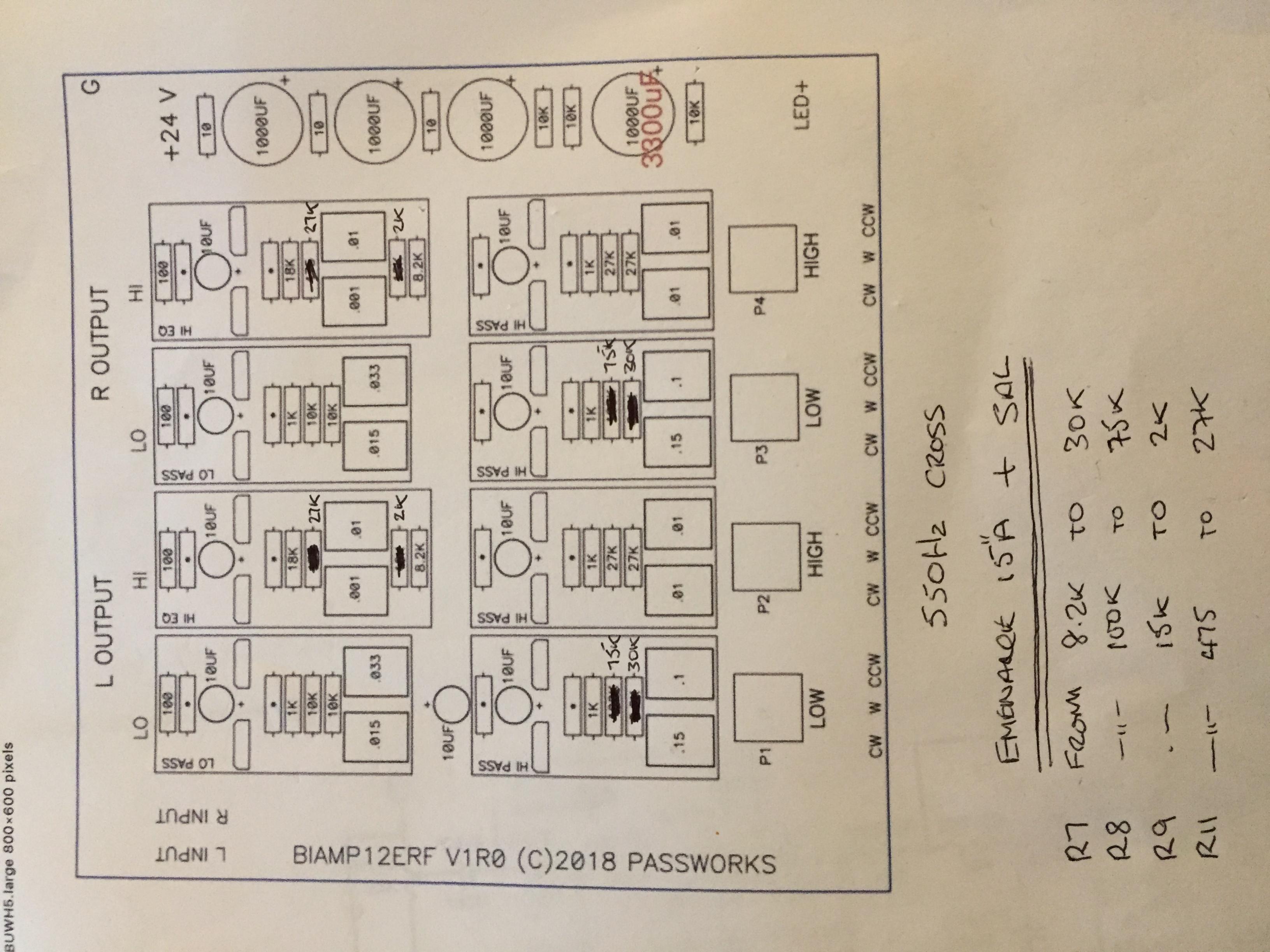

Moving on....By changing just 4 resistors I have a very very nice sounding (not measured yet though) TRIO setup with the SAL FR. Very musical and 'neutral' presentation. Still early days
Board layout added with component changes noted and locations.

Nice null.
I surmise that your summation curve reflects the need for phase
inversion on one of the drivers?
Thanks Mr Pass, low or high, or is it down to sonic preference upon inversion.
I look forward to measurements when I have time but ‘by ear’ it sounds just superb in fact ‘just right’.
