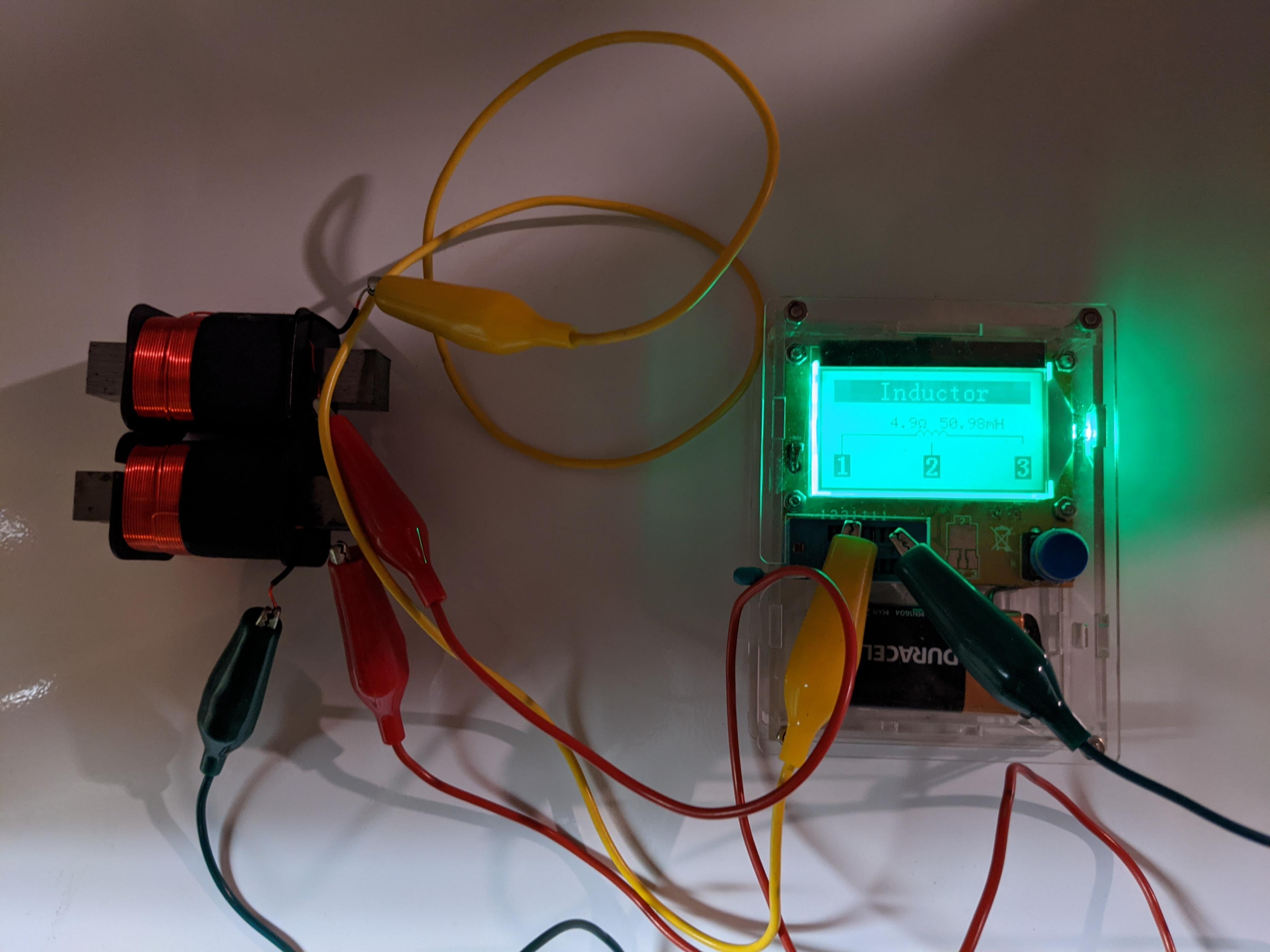

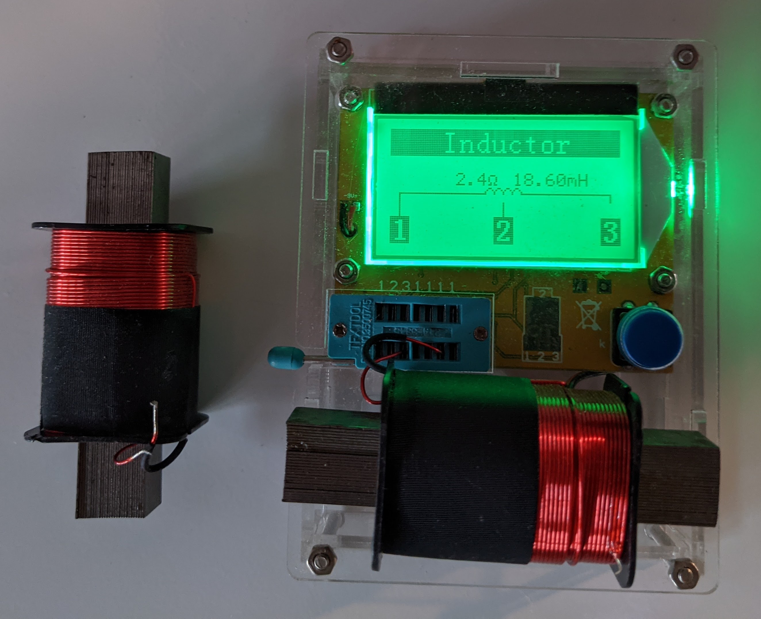

Yes. Those look good. I am surprised that they registered 2.4ohms though for an iron core. I would have guessed no more than 0.5ohm DCR. Give them a try and see how they work in series. Place them side by side with correct phasing.
Side by side. The complete crossover runs less than $17 each so it would be another relatively low cost option and I need something to do with the 50 LD1014Ds I purchased 🙂
I measured a Triad C-56U Inductor
Not sure how meaningful the results are as it's only a cheap Ebay 'transistor tester' gadget? Resistance looks a bit high but if I just put a wire link across the gadget it gives a resistance of 0.73ohms so the choke resistance would seem to be closer to 1.2ohms - if that's correct I wouldn't need any additional load than the choke to achieve my target bias current.
This looks perfect for your application! Nice result.
Thank you for sharing. Do you know what brand of inductor this is? They look like Dayton? I guess coming from PE they would be Dayton but I don’t see Dayton branded 18.6mH inductors in stock. These are custom units for a specific XO I guess.
The crossover is a PE branded product. I couldn't find them separately on their site either.
