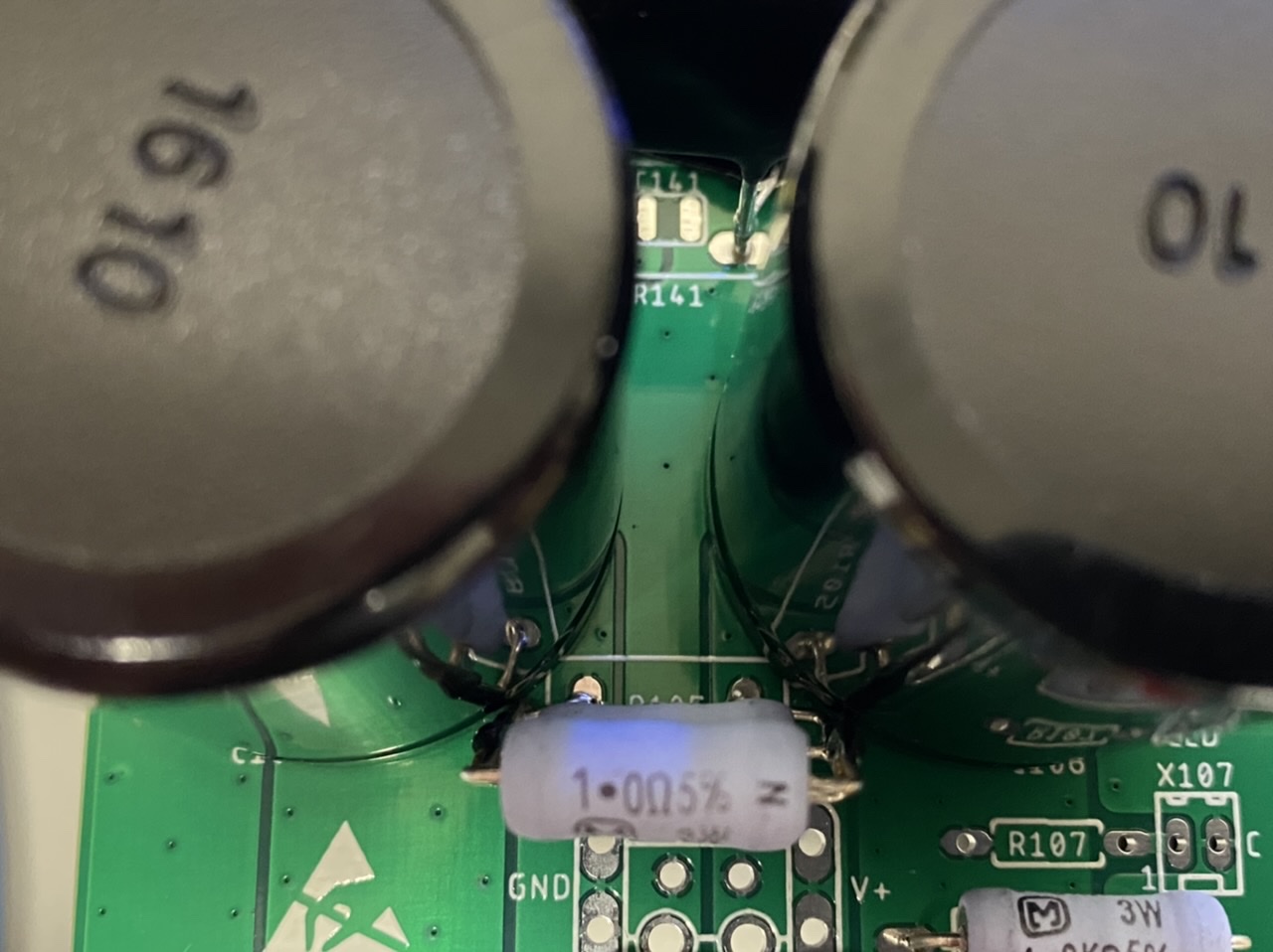

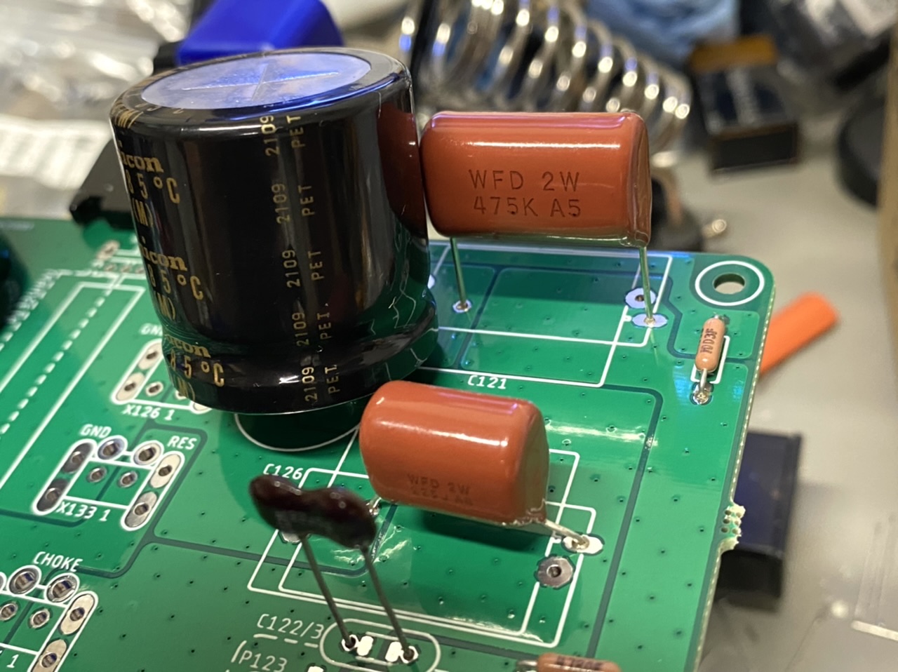

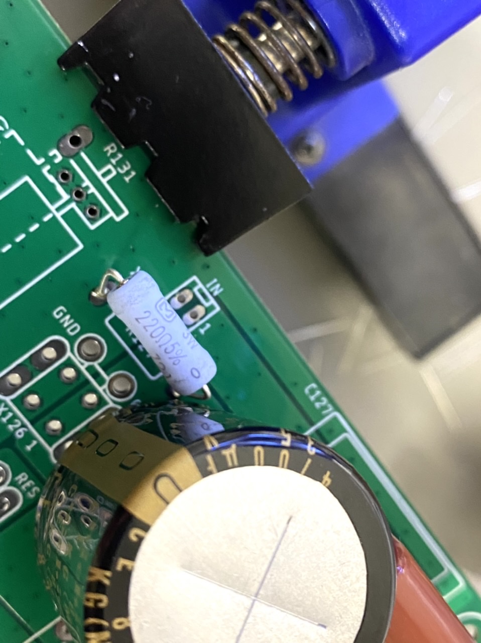

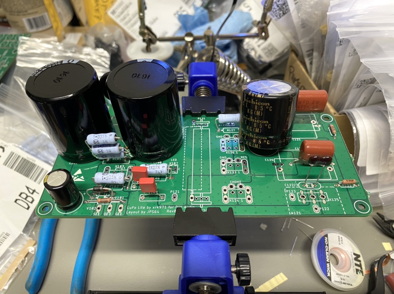

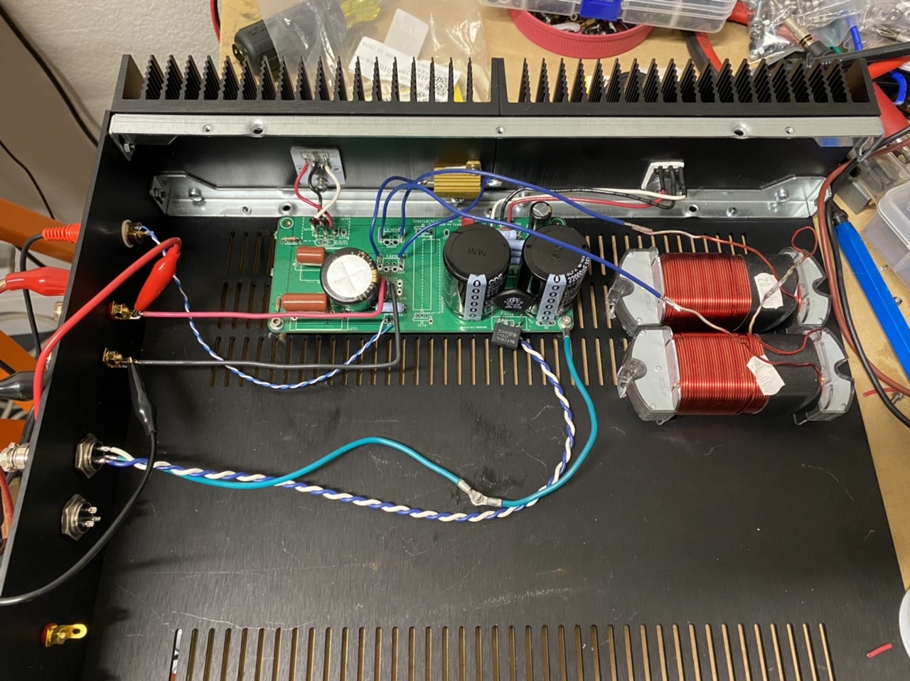

Started a verification build on the boards kindly supplied by Vunce and XRK tonight. Here are some photos of how the board is coming together. I have not applied any power yet so I can’t comment on it working just yet. IMHO, a few things I notice about the board and layout are:
1. The room for the 22,000uf filter caps crowds the space for R105.

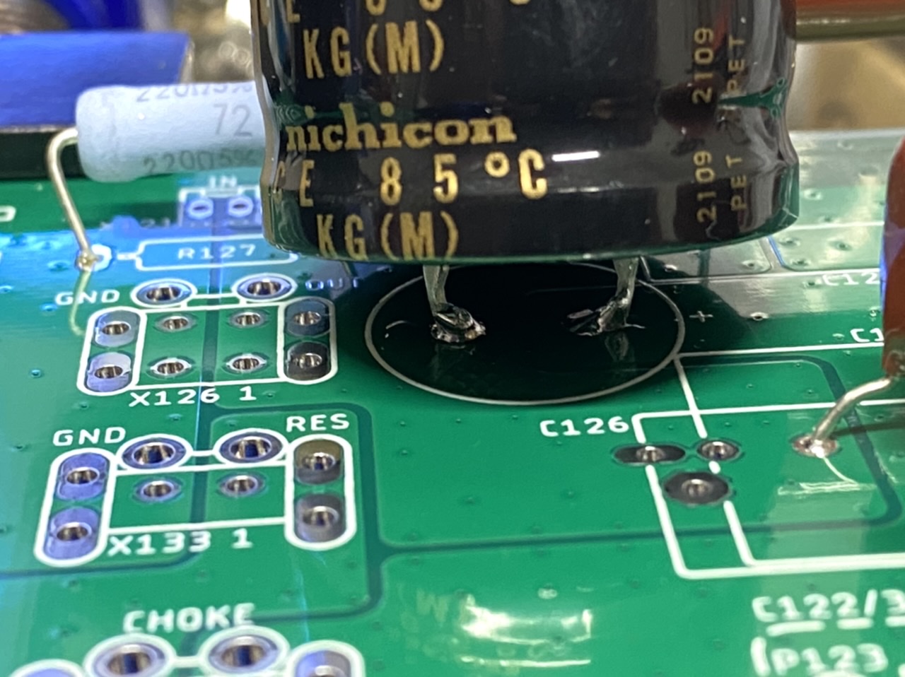

2. The holes for the 22,000uf caps are a tight fit. Maybe not the usual diameter for snap-in caps?
3. The output cap, C124, could really use a lot more real estate. I’m using a 4,700uf 35v Nichicon KG, which is a 10mm snap-in cap. So the leads don’t fit the board, which is 7.5mm lead spacing I believe? And a cap this size starts to bump into R127.
Overall, seems like a great layout JPS64. Just adding my two cents. Hope these comments help. Thanks to Vunce, XRK and JPS64 for the design, layout, and including me in the process!

@jwjarch
Please use suggested parts from the BOM and they´ll fit.
4700µ/35V --> dia. 18mm, RM7.5mm --> UFW1V472MHD
22000µ/25V --> dia. 30mm, RM10mm --> ELH229M025AS4AA (1.5mm holes as specified in the datasheet)
0R22 --> BR58 Series (BPR58CR22J in schematics)
All parts are available at mouser, especially take care about that point during layout.

Hi JPS64,
I think we know that you do choose the sizes carefully during layout, and thank you for fixing us such a fine layout. It’s quite compact and beautifully done. I think what Jwjarch is pointing out because he is using what’s typically already available on the bench, perhaps we can modify the final layout to be a bit roomier for more options. Indeed I have a lot of those bigger snap in caps myself.

Hi JP. I just want to apologize for any perceived negative comments I made about the layout. I know you certainly do your homework when it comes to parts selection and size was definitely a concern here. I was looking at it from a different perspective is all.
To X's comment, I was using what I had available in my parts drawer. The PSU filter caps in particular are the most commonly used for First Watt PSU boards, so I wanted to see if accommodating a 35mm dia cap would be possible. I am interested in helping and finding alternatives for parts based on my experience with past projects. All too often we all go to Mouser, Digikey, etc. and find parts out of stock, especially these days with the supply chain all out of whack. You never know when the stock of 562 capacitors that are there today will be gone tomorrow. I just wanted to point out that there may be a few small tweaks that could allow for a few different sizes of components. Just my two cents.
As for the Nichicon KG's, I purchased them when I was intending on just wiring point to point for this build. I wouldn't normally have such nice parts on hand at all times. 😉
So thank you JP for the beautifully laid out PCB's. Your talents and skills are, no doubt, a huge part of what makes this forum so great. This is probably my 6th or 7th set of your boards that I have worked on, going back to the ALPHA 20W pcb's. I really appreciate all you do for the community. Again, I sincerely apologize for any offense.

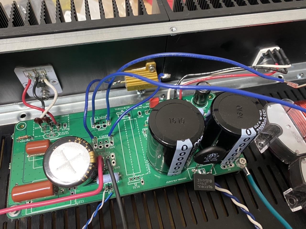

First channel is up and running. The cap multiplier circuit is working great to slowly ramp up power from the SMPS laptop PSU I’m using. It’s a 19.5v HP laptop supply. Voltage after the second filter cap is 13.1v measured at R107. I didn’t run it for long, but temps did not climb much on any components. I played a few seconds of music from a Bluetooth receiver directly in to the amp through my usual dual 3fe-25 mini-k test speaker. Sounded really good even though max volume is very limited with just the Bluetooth receiver. One of the best parts, I couldn’t even tell the amp was on even with a relatively high sensitivity speaker. It’s so quiet! I will plan on getting the second channel together very soon. Nice work JP and X! Seems to me the circuit is working perfectly!
I think that would be great for mounting JP. The placement of the LU, resistor, and IRFP240 are a leftover from my previously planned point to point build, hence the flying leads. It would be nice to get rid of those and clean things up a bit more.
One more note. I used a nylon stand-off at the corner of the board with the PE connection. I was worried about prematurely grounding the board to the chassis rather than the star ground and creating a ground loop. Am I over thinking it?
