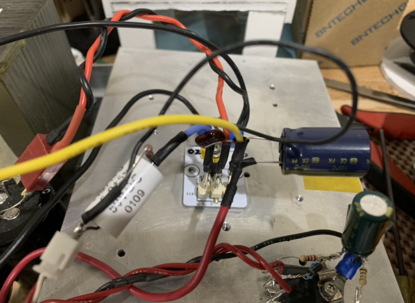

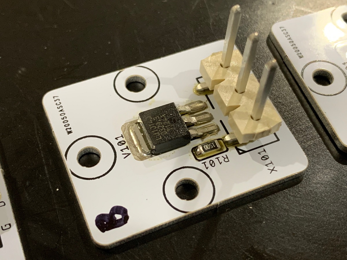

The amp was very simple and can be dead bugged on the 3 pins of LU1014D TO247 IMS aluminum PCB adapter board (Gerbers and PCBs available here).
Here is the LU1014D mounted on the IMS adapter board which makes it easy to use on a normal heatsink:
957971d1623053194-assembling-lu1014d-ims-247-adapter-ims-to247-assembly-closeup-03-jpg
In practice, there is something off with the model of the LU1014D in LTSpice and I needed to use a 2.5ohm resistor below the MOT to get the bias current low enough (1.5A). The circuit has been verified by myself and Jwjarch so far. The sound IMO, is very dynamic, natural, organic and transparent. Like nothing there but the muscle. It is very quiet - cannot tell it’s on. If you use the Cap Mx with a slow 20 second ramp up, there is no turn on pop sound either.

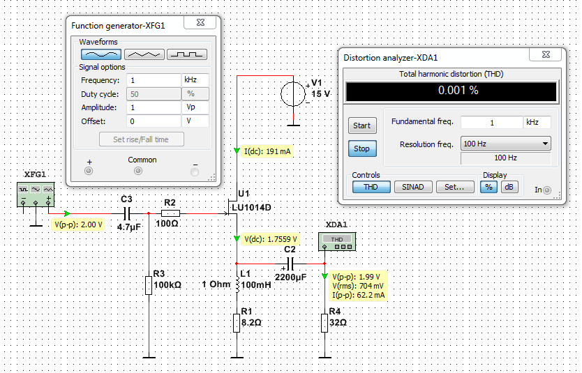

How good is your spice model of LU1014D ?
I have this:
Code:
.model LU1014D NJF(Beta=28 Rs=4.6m Rd=4.6m Betatce=-.5 Lambda=.9 Vto=-1.15
+ Vtotc=-2.5m Cgd=363p M=.3805 Pb=.4746 Fc=.5 Cgs=784p Isr=84.77p Nr=2
+ Is=8.477p N=1 Xti=3 Alpha=10u Vk=100 Kf=111.3E-18 Af=1)
And you have this:
Code:
.model LU1014D NJF(VTO=-1.8 BETA=29000M LAMBDA=0.18 RD=0.0065 CGD=363P CGS=784P VTOTC=-2.6M)
Which one is closer to reality?

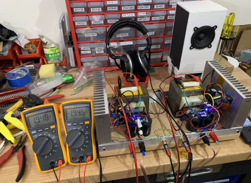

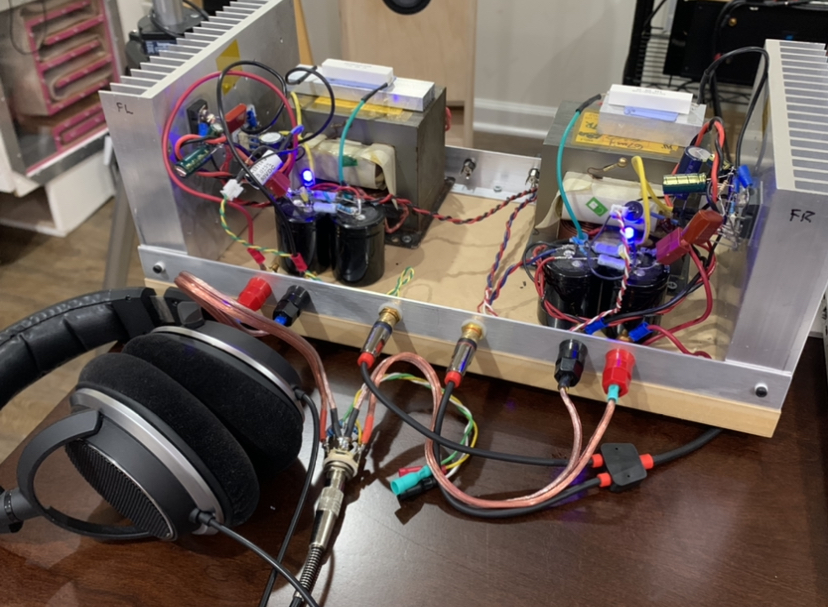

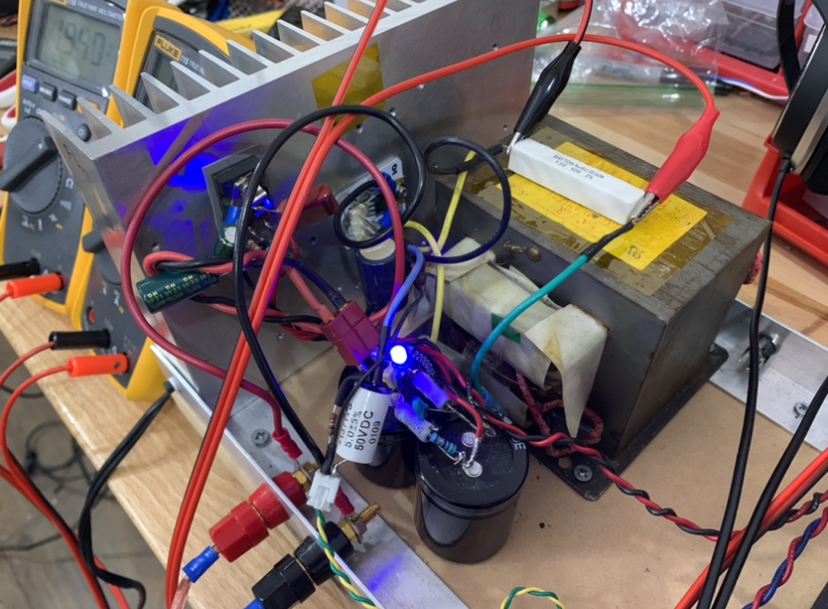

It’s through the help of all my friends that make all this possible. JPS64, Jhofland, Vunce, Zman01, and many of you out there on DIYA who give encouragement. This amp is an easy 1 hour experiment if you have a heatsink and a SMPS, the LU1014D, a MOT and a few components handy.
I finally assembled the LuFo Lite in stereo. I settled on 1.5ohm 2% 10w Dayton speaker crossover resistor below the MOT. This gave 1.3A bias current and using matched JFETs from the GB the bias currents are almost perfectly matched as you can see the voltage readings across the 1.5ohm resistors. It’s powered by a 12v SMPS from an SMSL Class D amp that I had lying around. After the cap Mx, the voltage at the drain of the LU1014D is about 8.0v. I think this is all that’s needed for most headphones as the output swing is about 85% of 2x Vsupply or about 13.6Vpp for this case. That’s good enough for about 700mW into 32ohms.
attachment.php
attachment.php
attachment.php
I connected it to my Khadas Tone Board DAC and playing Amazon Ultra HD tracks - I am immediately struck by how good it sounds. Very clear and transparent. Very dynamic and powerful. Being a zero feedback amp, it images very well. It is also absolutely silent. Cannot tell it is on if music is not playing.
I have this:
Code:
And you have this:
Code:

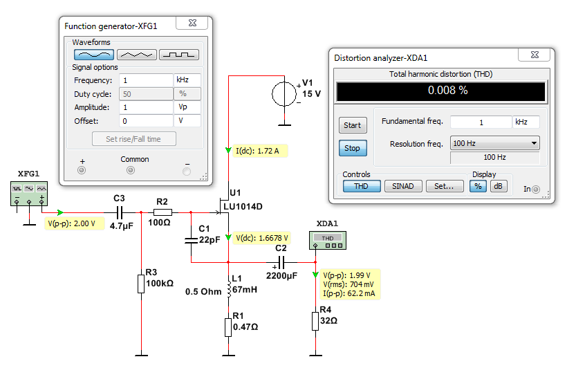

Hi Lineup,
Your model seems to give lower THD by about 2x less, and the bias current decreased from 1.7A to 1.1A. For the 8ohm case, I got 0.02% THD vs 0.04% from my model. I think previous measurements of THD with the model I orginally had was pretty accurate. Your model may be undersestimating the THD. Thanks for the model though.
I run your model now.
Possibly it gives closer to reality values.
May I ask why you run so much current, 1.72A ?
It is possible to increase the resistor values and get lower current and lower THD.
See image.
Hi Lineup,
I am running 1.3A in reality and it’s high in order to be able to use as a fleawatt amp for 8ohm speakers. Several people expressed interest in an application as such. For headphone applications there is a lot less power required unless we are talking about the handful of cases such as the HE6 which requires up to 3w at 32ohms. But that will be voltage limited and not current limited.
Thanks for running the sim at lower bias current.
