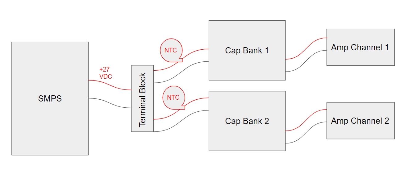

Thanks, xrk. Understood on the inrush current limiter. I’ll contact MicroAudio about options.
About how much capacitance should I be aiming for per channel with the LuFo (assuming SMPS)? Would ~20k uF suffice?
You could use an NTC between the SMPS and the caps. I did that with a MeanWell to charge a huge cap bank.Thanks, xrk. Understood on the inrush current limiter. I’ll contact MicroAudio about options.
Thanks! I recalled there was a simpler NTC option. I may ask you for some specifics down the road when I get to building.
I’m not fixated on maximum output of the amp, so a little voltage loss (~1.5 V?) and heat at the NTC is fine with me, especially for the sake of simplicity.
And don't forget. You probably can't switch the amp on and off without waiting for the NTC to cool off first.

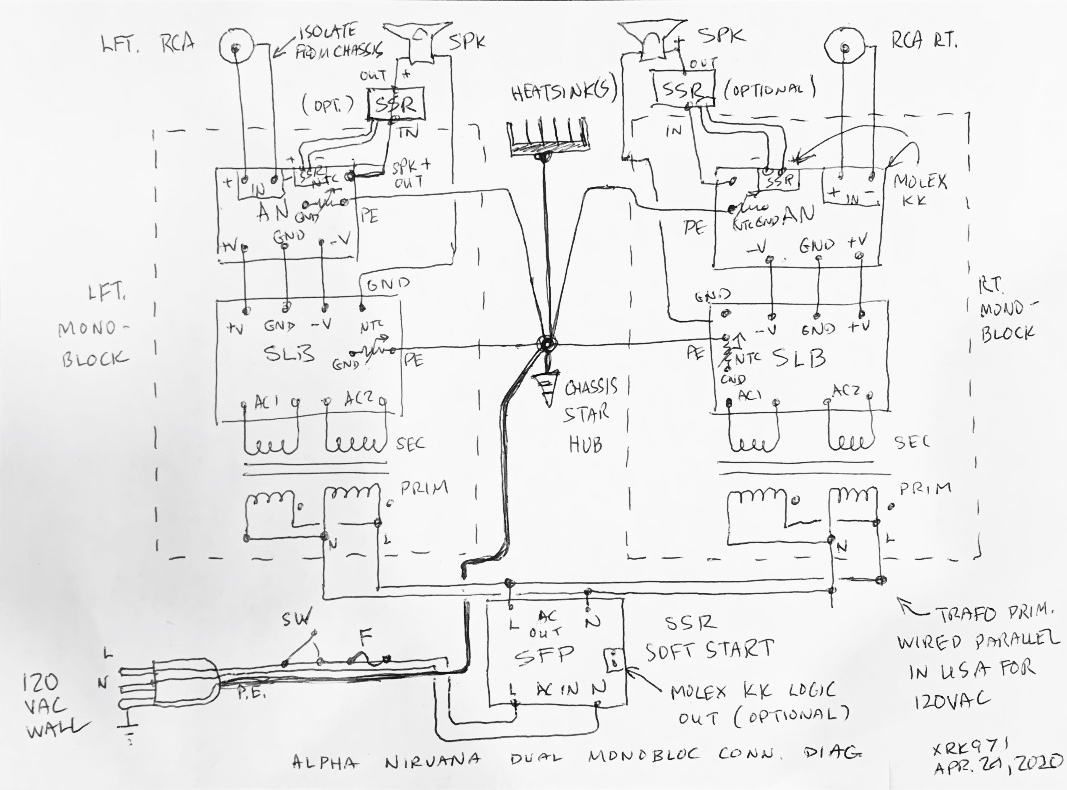

Dual PSU’s make for a monoblock. In general better imaging and soundstage due to perfect stereo separation (limited by source).
No, as long as they only common ground between the two side is the chassis dirty ground star connect point. Always use NTCs to separate clean and dirty ground.
This is the Alpha Nirvana amp with linear PSU but much of the same principles of keeping separated grounding and idea of monoblocks apply.

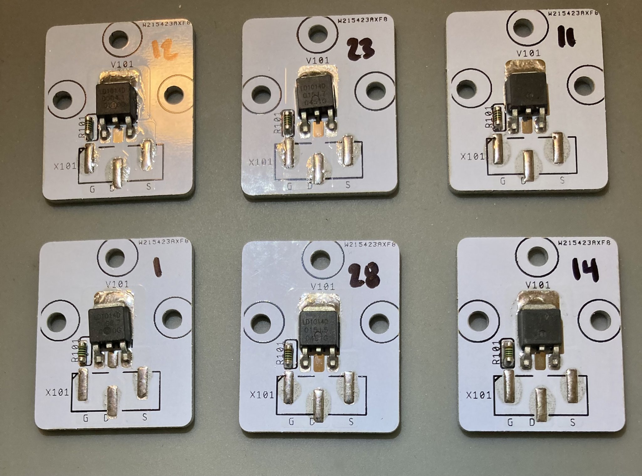

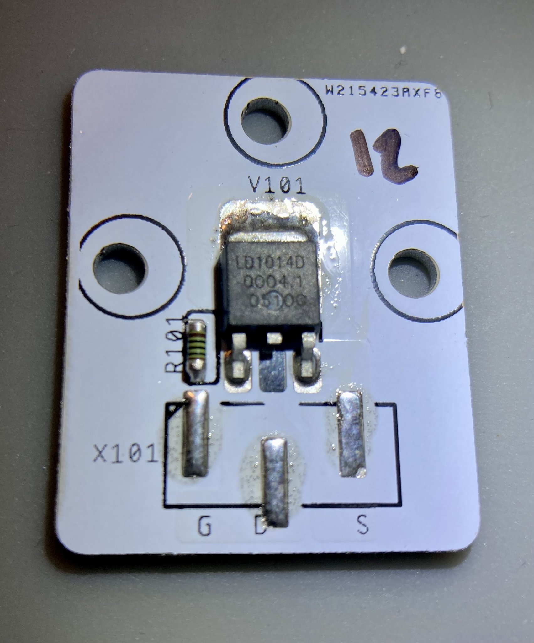

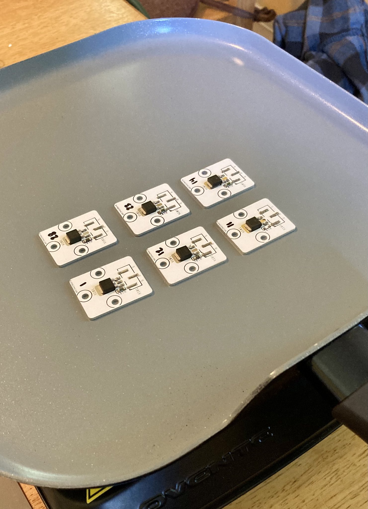

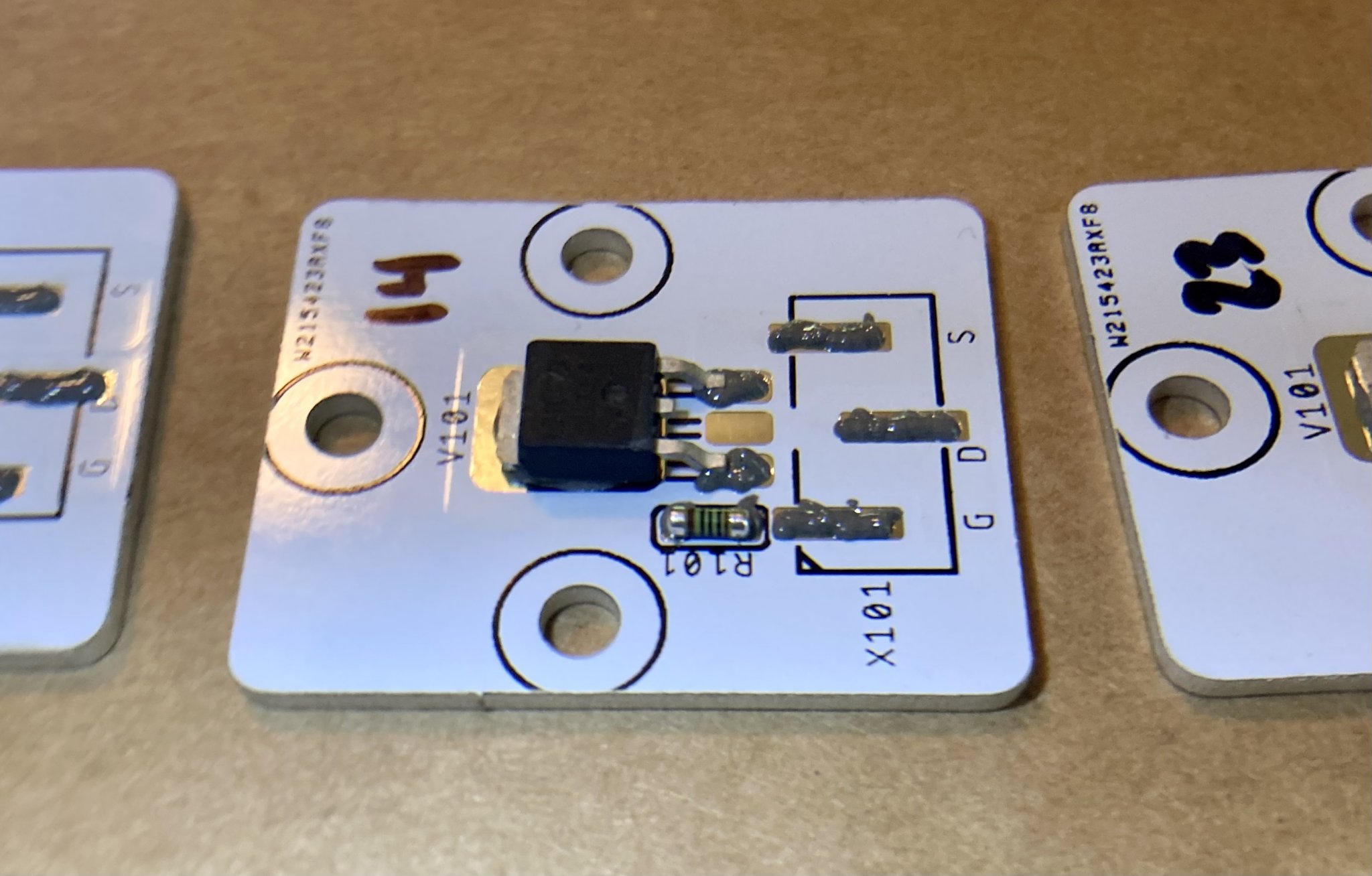

SMDs conquered! First time soldering tiny things with paste and hot plate. Went perfectly as far as I can tell. Thanks to xrk971 for the great videos and suggestions. 😎
Thanks, all. I hope I didn’t cook any of them. I pulled the pan off to a damp towel soon after all boards were flowing and shiny. One took longer than the rest. I’ll have to improve my technique to get more even heating. Although the only other SMD task pending so far are the Lender preamp boards for the LuFo. So many little pieces. 😳
I‘ll use the little transistor tester on the LD’s tomorrow. For now I’ll celebrate the success for not burning myself or the house. 😊
