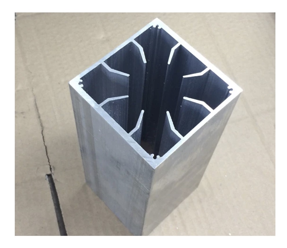

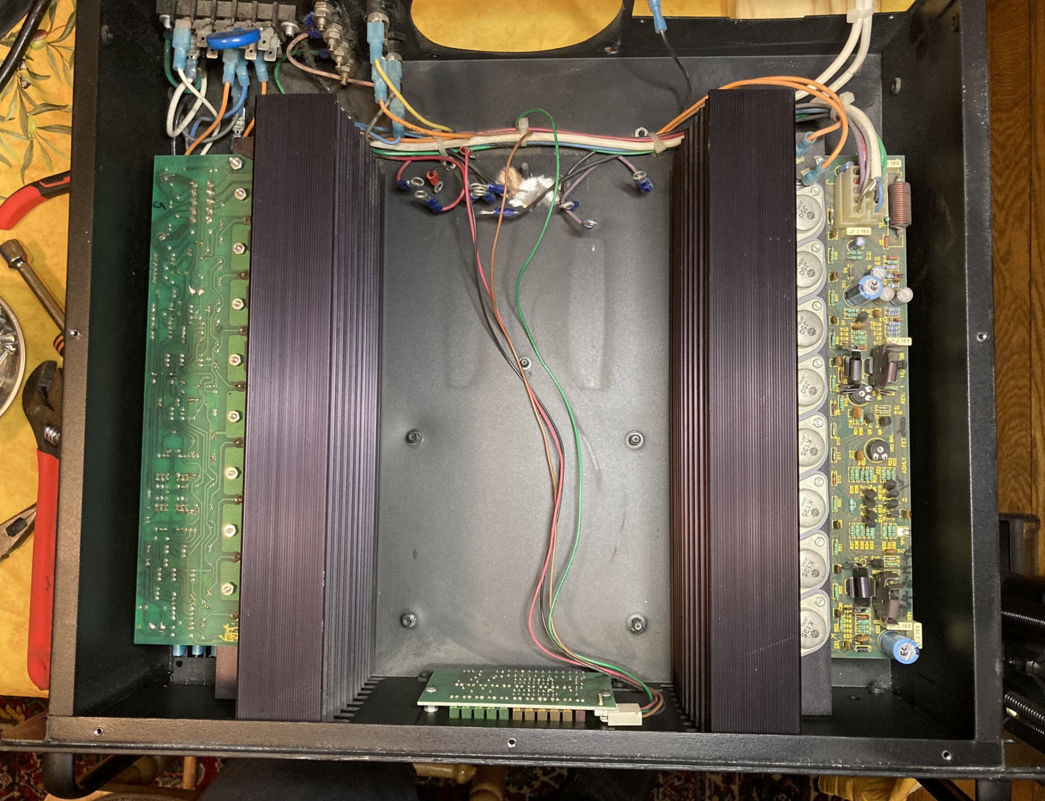

Thanks, all! Looks like I’ll go with the shoebox monos. It will be a little tricky securing everything, but that is all part of the fun.
There will be opportunity for some kind of babysitter under the heatsinks if needed.
I had started planning this build with a cooling tunnel in mind, but my AliExp order got cancelled, so I moved on from that.
Another idea was to dismantle and repurpose the sinks from this PA chassis…

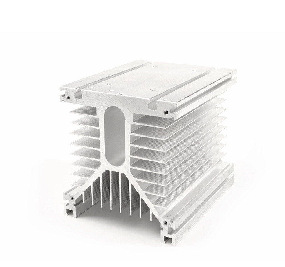

Hi X,
it's time to work on this project 🙂
I'm planning (maybe) to build the version with the single IXTK, and would use one big heatsink for it and another one for the LU. The heatsink is 150x140x130 mm - would it be big enough?
A further question, can I use the boards I bought?
Thanks in advance!
Hi Plott,
What is the W/deg C rating for that heatsink? It might be fine for the IXTK and another one for the LU1014? So 2 of the same ones?
I think this amp dissipates 3A x 28v = 84W. Only about 15W is on the LU1014 so the bulk of it is on the IXYS at about 70W.
A Noctua fan on top of this will certainly let it handle up to 200W.
if you bought the boards already, sure they will work. Those are the latest version.
I just can't let go of the idea of an IXTK. I have never used a fan so I would like to know if an airflow of 74 m3/h (about 2600 cubic feet) would be sufficient? I found a Noctua with only 8dB noise level. Or another with 115 m3/h and 12 dB noise level.
Many thanks in advance.
Get a $5 PWM fan speed controller and set it to lowest air flow rate that cools the amp sufficiently to keep heatsink below 55C. This has a temp sensor you can stick in heatsink air flow and it boosts speed if needed. You will have plenty of airflow at max capacity. The Noctua’s are inaudible at lower speeds and barely audible at their higher speeds. 12dB is inaudible I think as background noise in a normal home when quiet is about 35dB.
