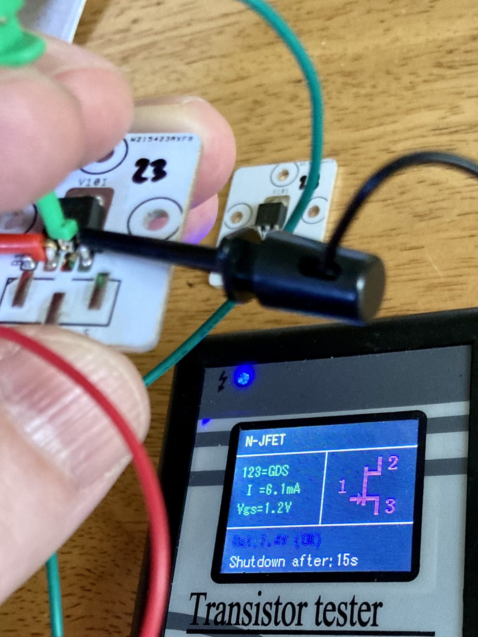

Nice work Von Ah! How did they check out? I bet they are fine as these are robust little devices. I just sent off 600 of these to the board house for robotic pick and place installation onto the IMS boards. Then they come back and Woofertester will do the characterization and matching for me with a new dedicated auto-test rig.

Thanks, x.Nice work Von Ah! How did they check out? I bet they are fine as these are robust little devices. I just sent off 600 of these to the board house for robotic pick and place installation onto the IMS boards. Then they come back and Woofertester will do the characterization and matching for me with a new dedicated auto-test rig.
I merely measured them with the transistor tester and they all were similar in the values in the picture, so I deduced that they were all ok. It's possible I cooked all of them, too, but I thought that was unlikely. 😀

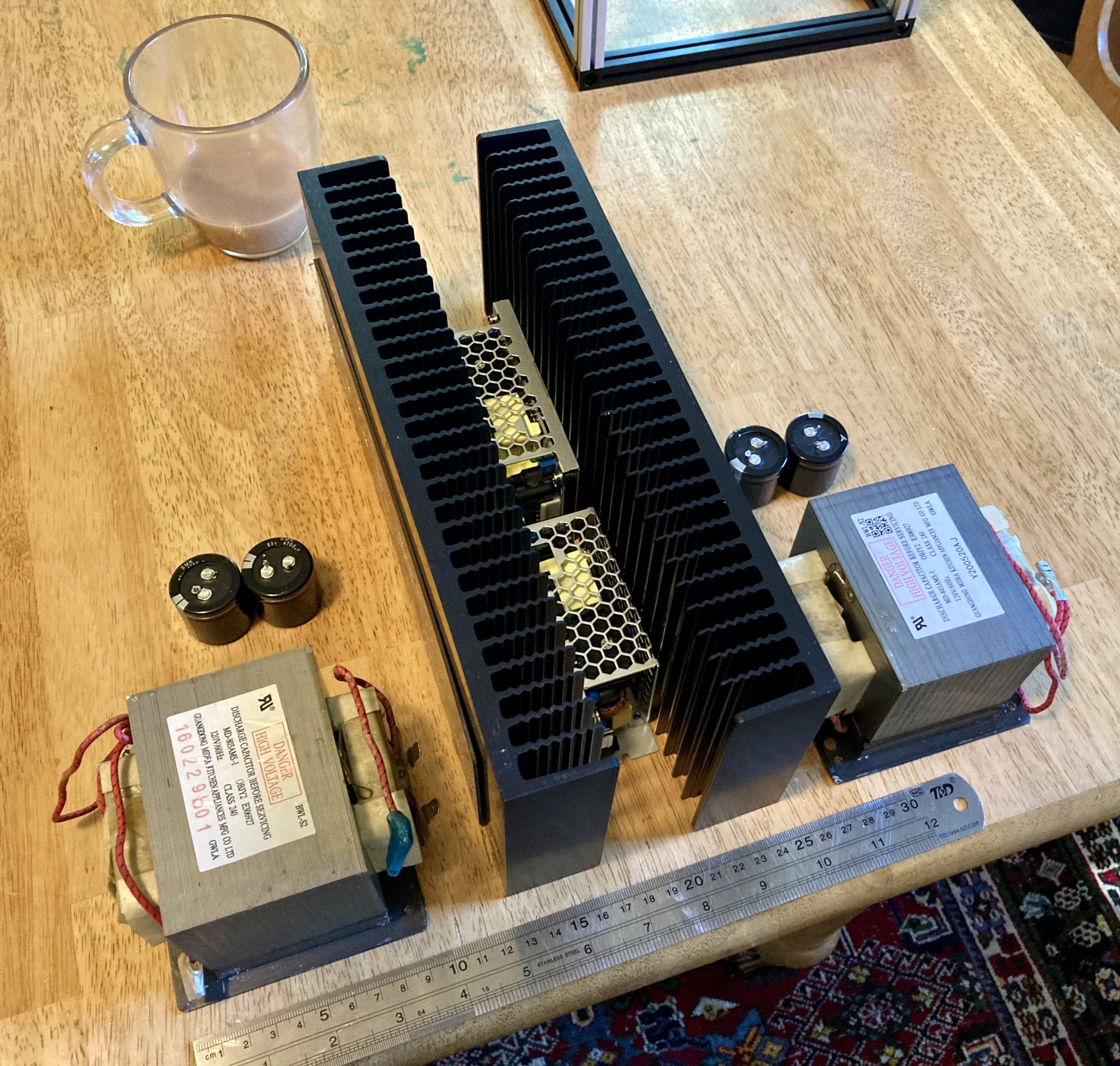

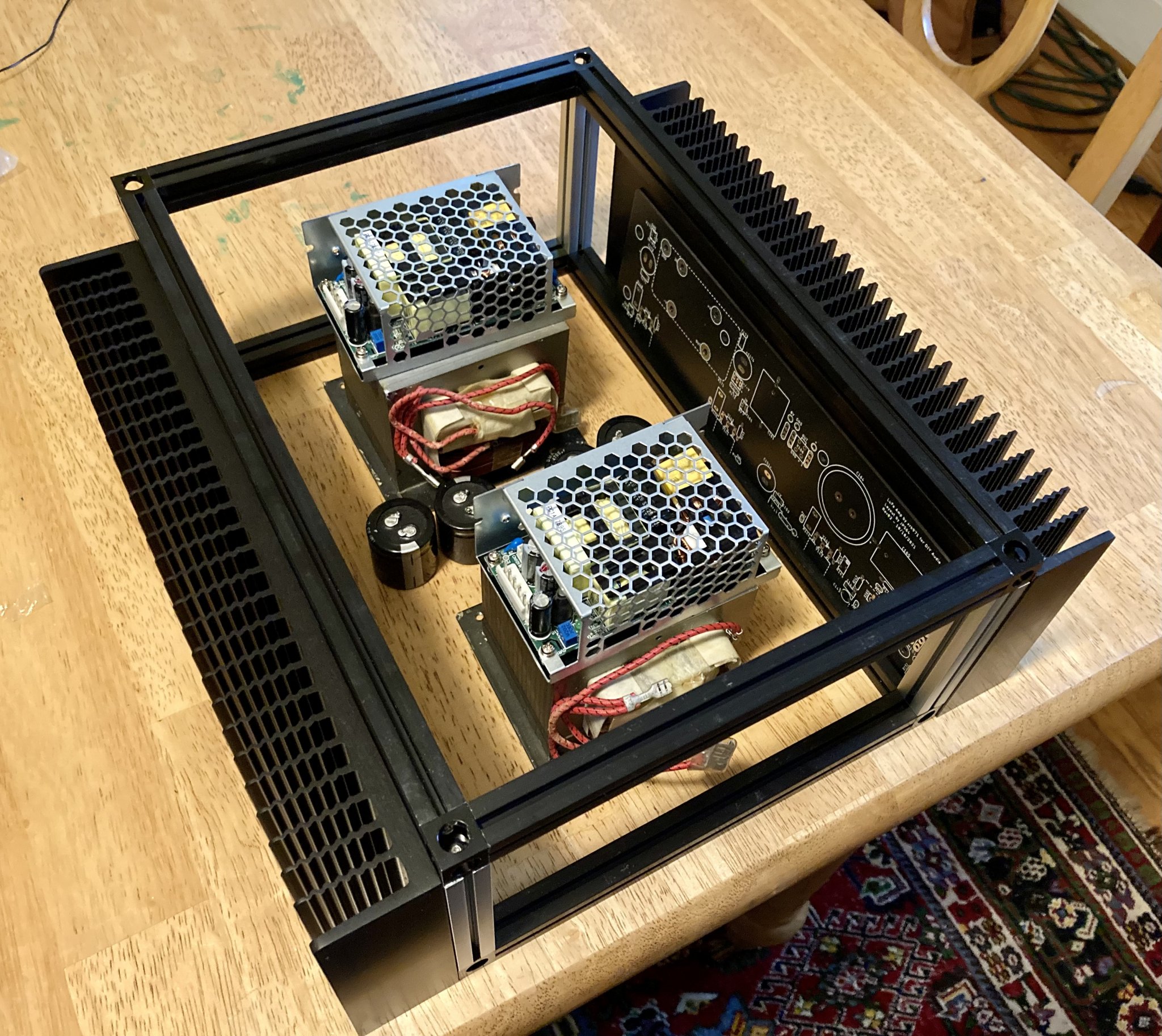

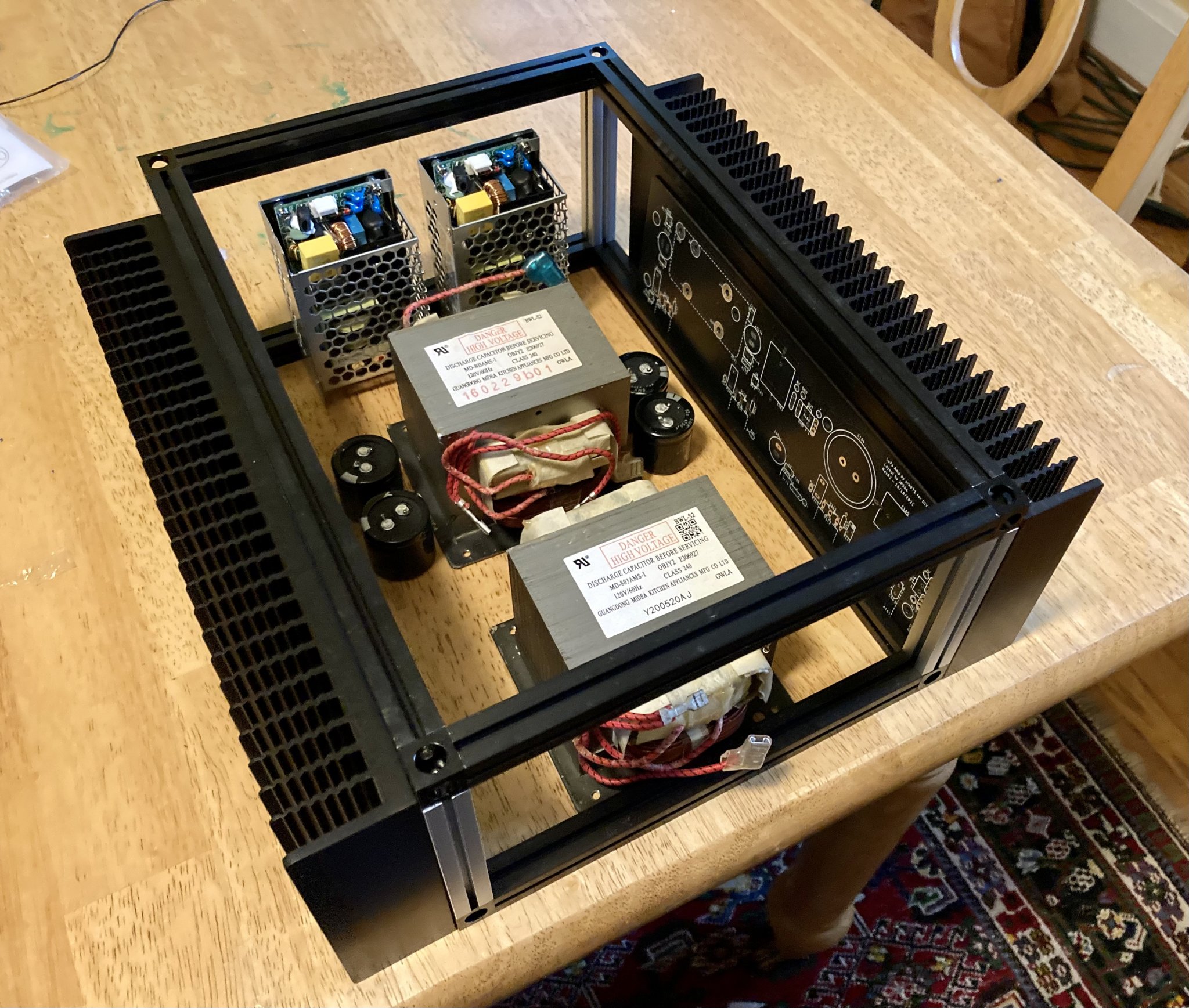

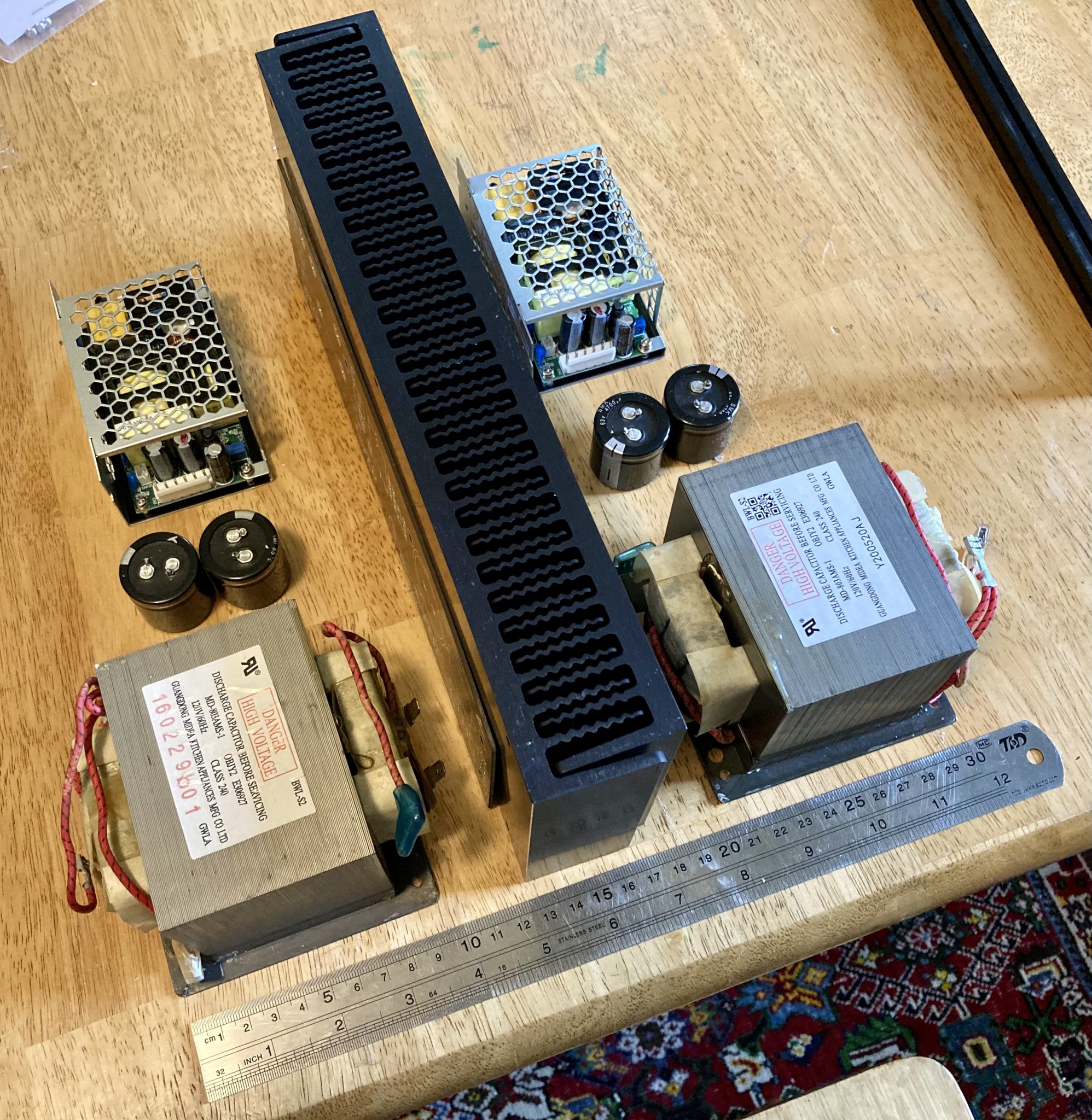

My SMPSs arrived (Meanwell RPS-200-27) so I'll do some more LuFo planning and part ordering today.
Playing around with some placement options, using makerbeam for testing. Heatsinks are 3U300.
More elaborate ideas include a central spine of heatsinks with fins pointing at each other, with fans below or above.
The caps here are just concept placeholders, not the ones I’ll use for the amp.

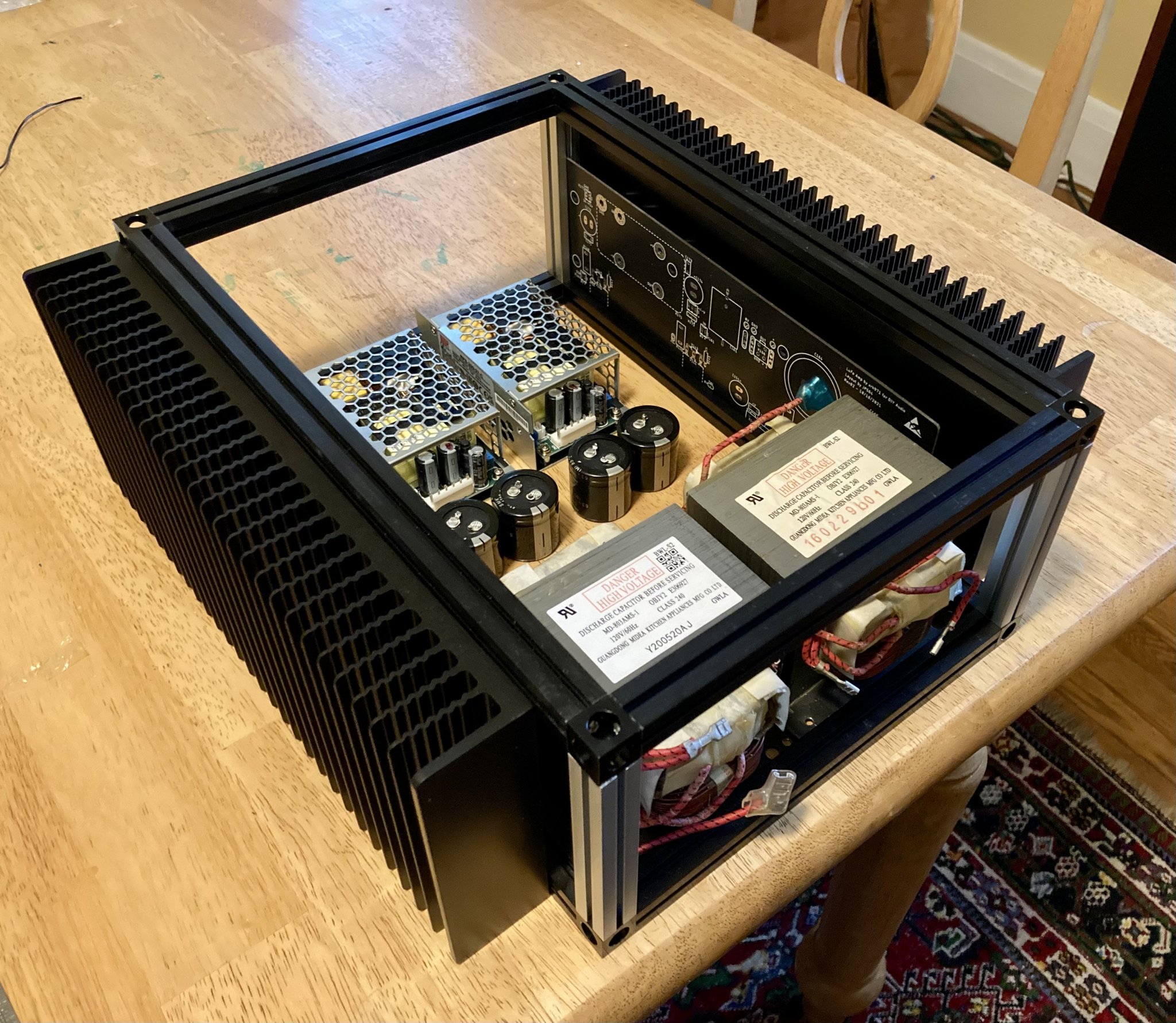

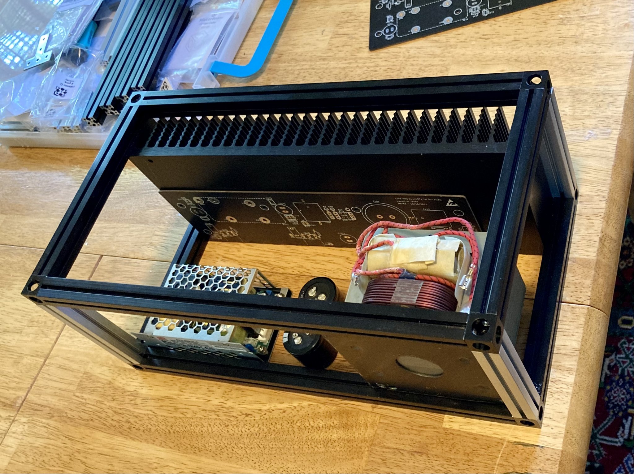

Yep. Just a makerbeam XL box 330x230x130. I love working with it, too. Every time I play with it I think all my diy builds should use it. Even speaker cabinets. 😆
I like this with smps in slim side verticalPlaying around with some placement options, using makerbeam for testing. Heatsinks are 3U300.

Thanks, nicoh. Like this?
It’s a bit wider than I was aiming for, (over 300mm wide), so that leads to monoblocks. Plenty of options/configurations for compact mono’s, but I wanted to try to hurt my back first. 😆 Makes me think of those very cool Kenwood L-series monoblocks from the 80s…

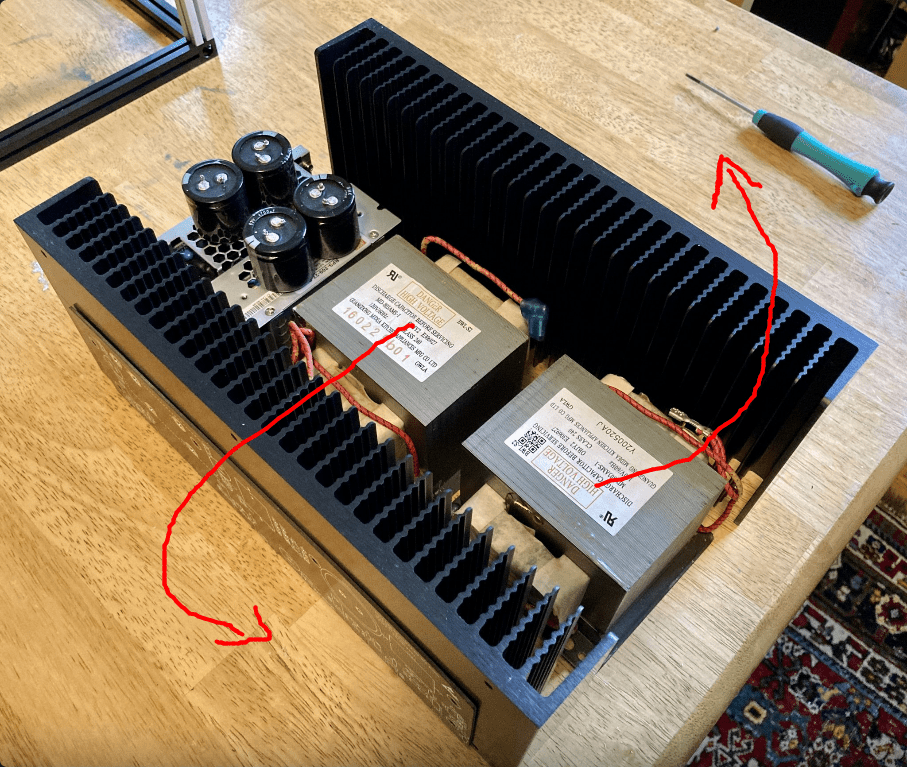

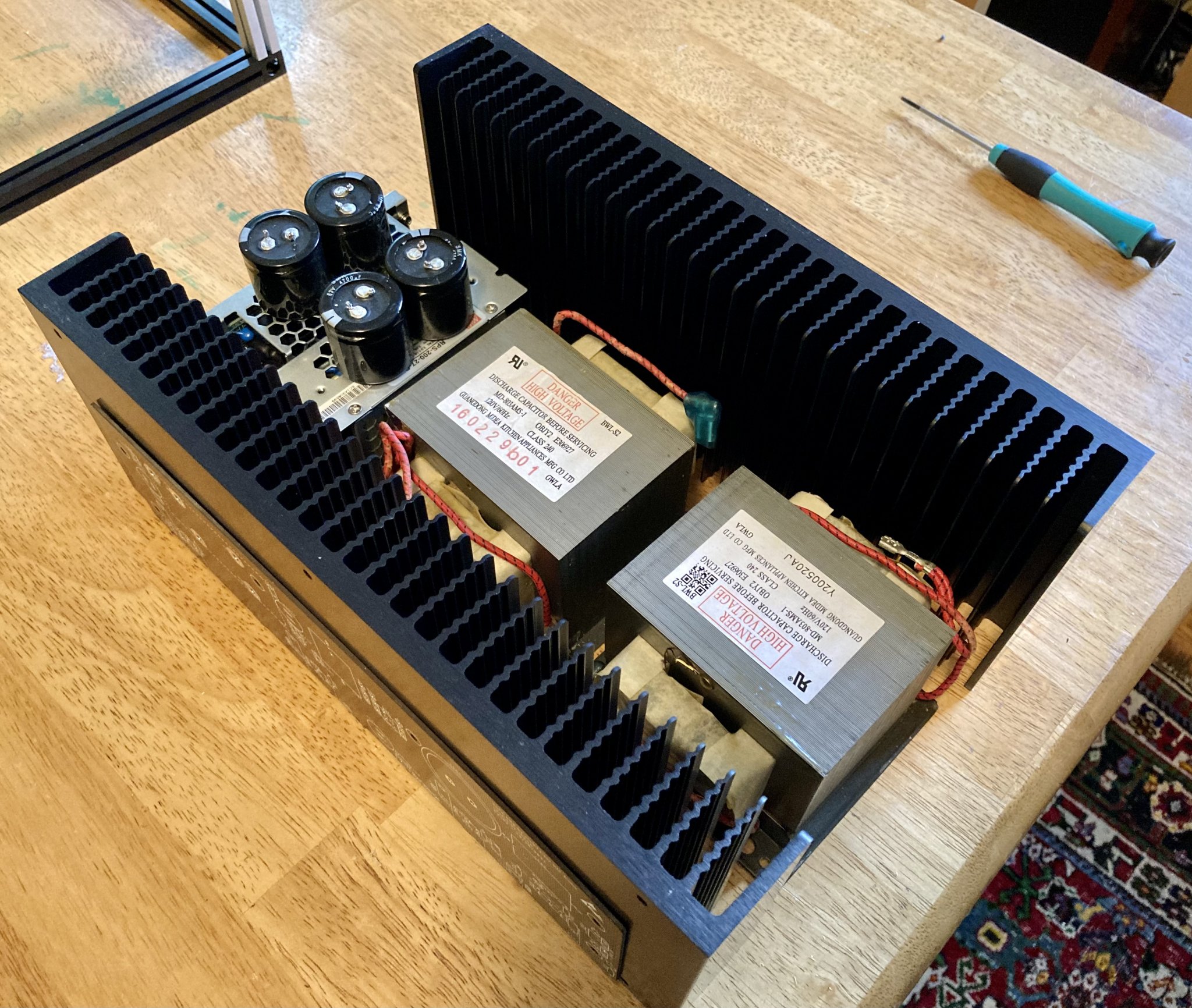

My vote is for Pic#1
https://www.diyaudio.com/community/attachments/2c7399e8-b73e-4306-b6ea-4d1e08090db6-jpeg.1058510/
Shouldn’t be too heavy since your going with SMPS for power. Will those MeanWells power-up with the added capacitance at the outputs?
Must avoid choke magnetic coupling ..... are cubic the choke ? just to gain some cm.....Thanks, nicoh. Like this?
PS I have had a stereo xo in a single box and one disconnect channel sound without to the amp ! 🙂
pic4 is nice too and the 2 for classic design but with one choke turn 90°
I was thinking the same thing. You can rotate one of the chokes 90 by mounting it on a bracket to get orthogonal plane. Not sure how big a problem with EI cores. With air core it was audible. I got sound without amp even connected when one XO was near the other. My video on XO crosstalk.
EI psu iron have a lot of magnetic gremlins vs toro or Rcore.....btw he the filter better AC as have low bandwith
Pic#1 would indeed be simplest, with rotating one MOT 90 degrees. I intend to test an inline NTC with the SMPS output for each channel first. I’m optimistic that will work. If not I can incorporate a more elaborate soft start scheme, or change to a different SMPS like MicroAudio or Connex.My vote is for Pic#1
