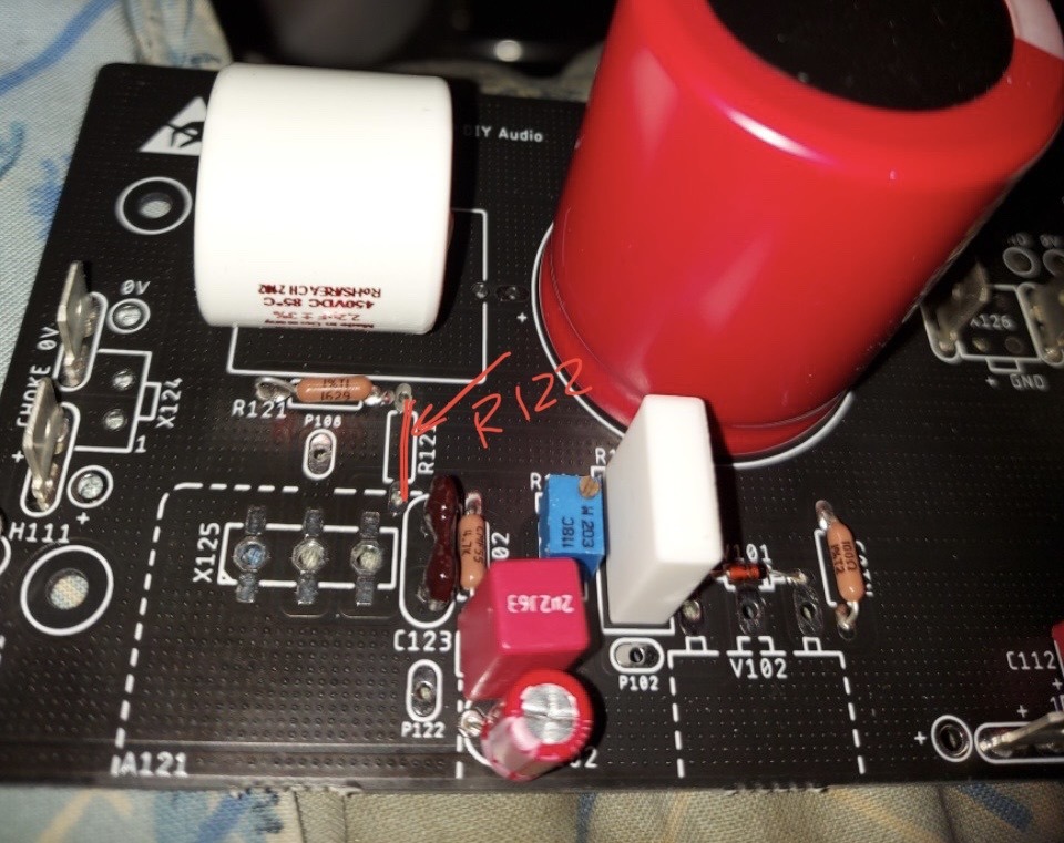

There are 2 R121 on the board,is it where the unpopulated R121 the 0 ohms "resistor" should be?
Sorry, that’s a silk screen error on Gen 1 boards. It should be R122 (0R) and use a wire jumper if you are using the aluminum IMS TO247 adapter which has a 100R gate stopper resistor on board already.
Many thanks X, I will try to figure it out.

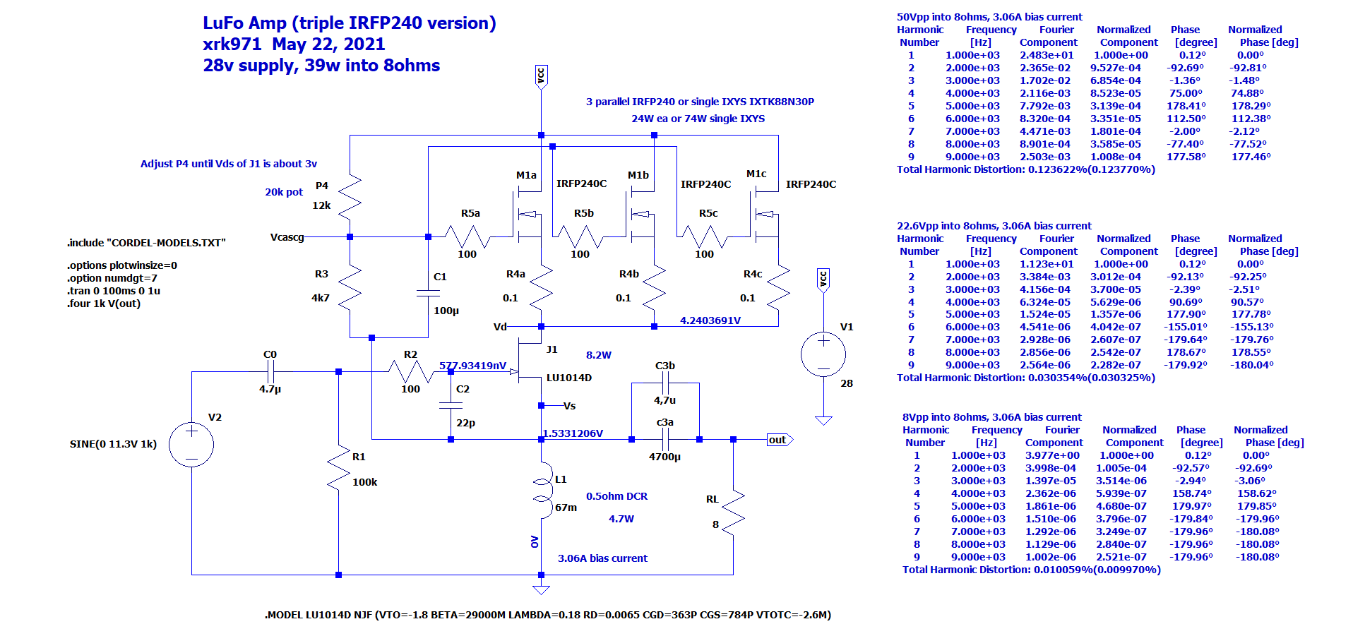

you can run a simulation in LTSpice and see how independent R and ESR affects power dissipation. Those were the results when we ran simulations of the CRC used in cap multiplier for Class A. The specific capacitor used was an important consideration based on results of simulation.

50.5Vpp for 40w into 8 ohms. So preamp will need a few extra volts since amp is slightly below 0dB gain.
50.5Vpp / 2.83 = 17.85 Vrms
17.85^2/8ohms = 40wrms.
One sets the bias current and the other sets the gate voltage for the JFET. The two are linked so it requires iteration. I have not personally tried myself as my boards did not have the second pot. I think Mbrennwa used it to set exactly the current and voltage independently.
