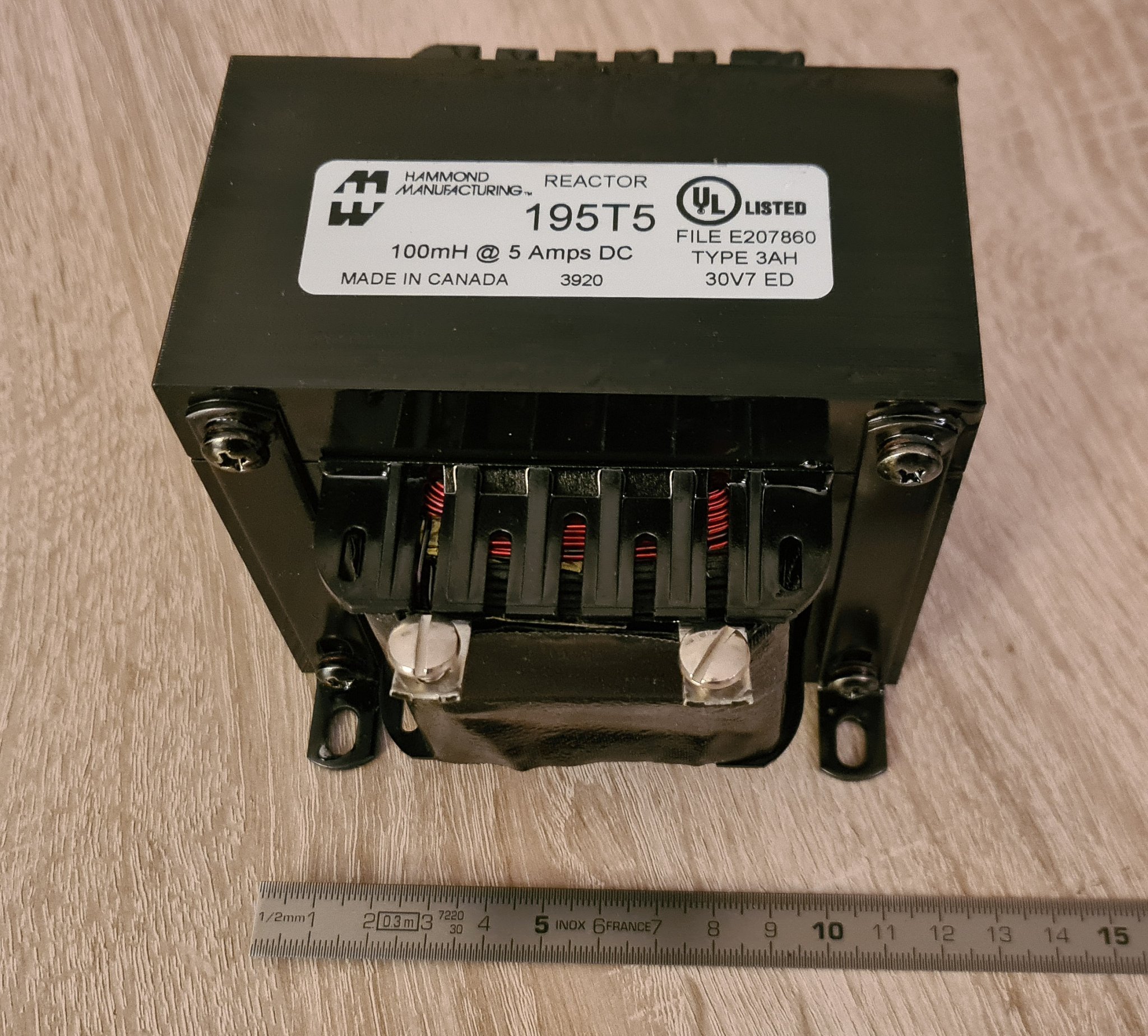

Hi Vunce,Just curious, has anyone tried the Hammond 195t5 inductor with LuFo?
I will use it as soon as my boards arrive. This inductors are huge 😱
Thanks Vunce, fun is guaranteed😀 But I need a forklift for that piece 😵Great looking beefy inductor Plott!

2 MOT’s, 600va trafo and a large chassis with 3mm steel base plate for my LuFo. Not quite forklift territory, but maybe a pallet jack to move mine around 😂
