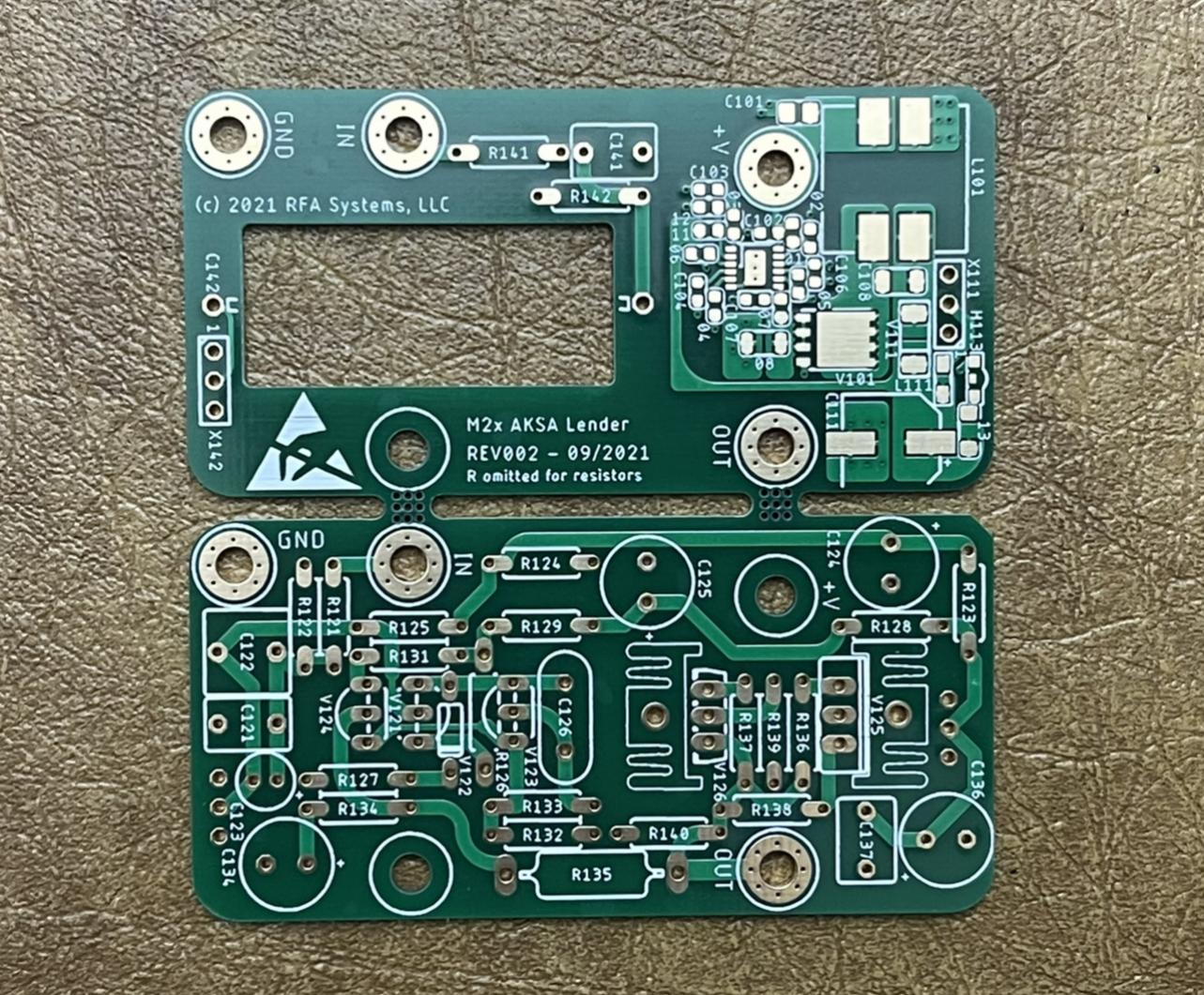

Just ordered a set of the LuFo pcb from your shop X but did not see any specific front end cards for it. Is there anything still abailable?
It accepts the standard Yarra/M2X daughter boards. The Melbourne, WBA18, and ACP+ are probably the most practical candidates to generate the required output swing. They are is discrete amps so less susceptible to supply chain for single part bottlenecks. The ACP+ has an optoisolator that might be tough to get. I have the OPA454 HV opamp versions available and need to make them available in the shop. However, they use a DCDC converter that is really hard to get with the supply chain issues.
I totally forgot that JPS64 made an Aksa Lender front end for the Yarra/M2X format with a built in HV DCDC PSU - this would be ideal for the LuFo actually. PM me if you want to be the verification builder for it.
It uses the LT8357 DCDC converter and an external MOSFET for the step up. Schematic attached.

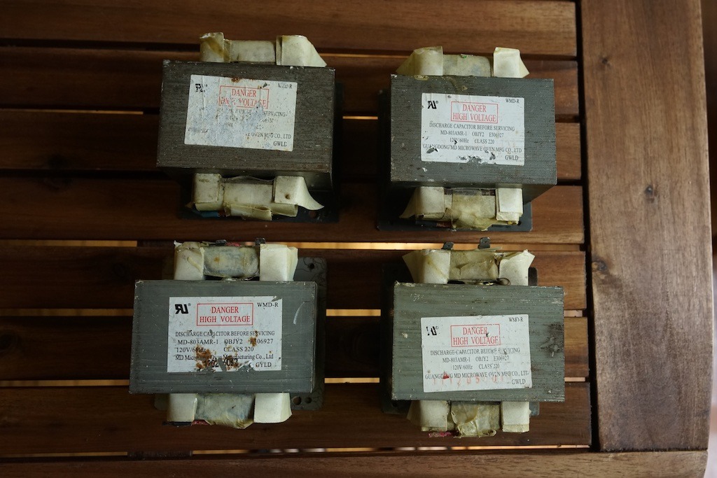

I have (4) MD803 for $80 including free shipping to continental US, or please make an offer.For the price, it’s tough to beat MD-803. About $30 with shipping.

Thank you. I will figure out how to test these MOTs (I have two others) and choose the best two for my LuFo build.
You can run a sweep with a DATS to see which has the most linear impedance vs frequency.Thank you. I will figure out how to test these MOTs (I have two others) and choose the best two for my LuFo build.
DATS what I will do, then. 😀

My two MOTs measure 87mH/2.2R and 66mH/1.7R with DATS. So I think getting 4 more will help me select two similar ones.
Naturally, they measure differently with different methods:
- DATSv3: 87mh/2.2R; 66mH/1.7R
- TrTester: 115mH/2.1R; 88mH/1.0R
- DMM: 1.2R; 1.2R
- LuFo Amp - 39w SE Class A from 28v Rail
