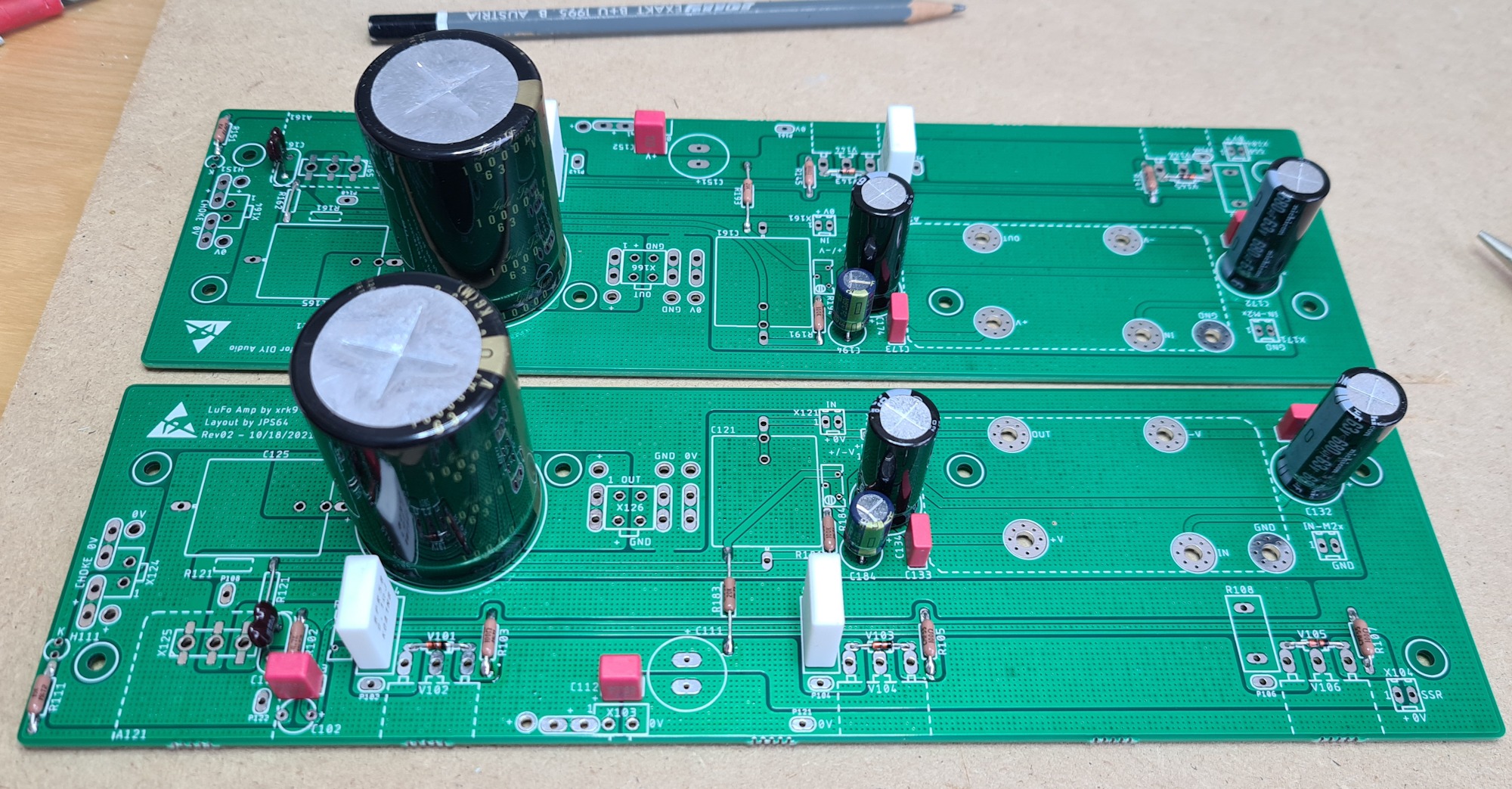

Some slow progress after restarting the project, and some missing parts (missing, because not available and missing, because ordered and paid, but only delivered 4 pieces instead of 6... 7 months ago, so it's too late now).

- for the 22pF there is a "normal" (upper side) and an smd soldering position (under side) on the board - is this an option or a requirement? I soldered the normal one with 22pF/500v.
- are there recommended preset values for the trim pots?

You can use one or the other on the 22pF caps. No difference sonically that I can hear. Pot position - leave in middle as that was where it was sized for and adjust up or down to achieve correct voltages and currents. Be sure to have several DMMs installed to monitor voltage setpoints and currents across resistors initial during turn-on. Have a finger on the shutoff switch in case you detect excessive voltage or current. Excessive is current above 5A and loud hum from trafo, smoke or smells. You will know in 2 seconds. And if it gets past 2 seconds stand back for at least 1 minute to make sure electrolytic caps are good and don’t explode if improper polarity or “dud” infant mortality. Wear safety goggles.

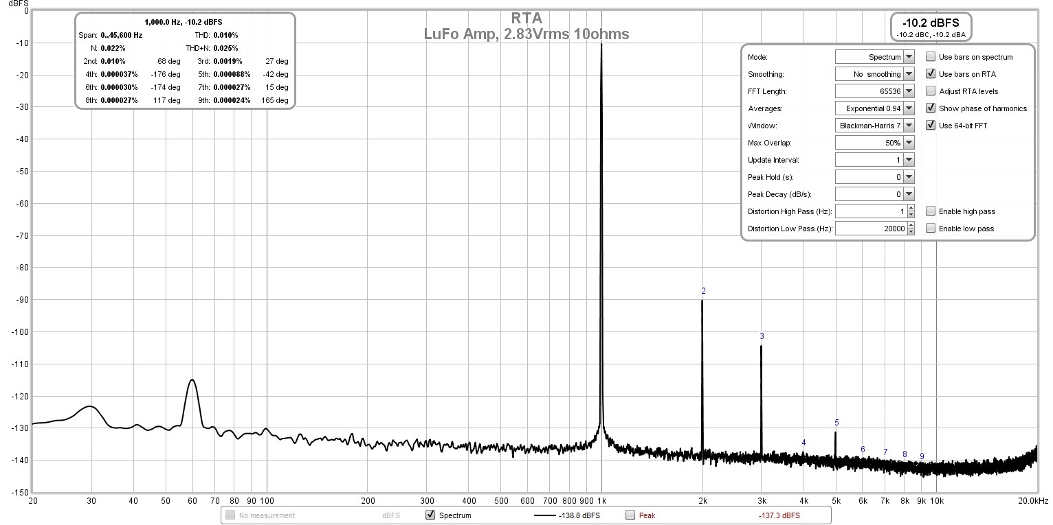

Good question. Based on my listening impressions, I felt that the LuFo sounded more clear and had more bass authority. The clarity comes from having less harmonic distortion. The voltage is less of an issue if we compare the FFTs at lower output voltage well within supply rail. These are not at same exact conditions but you will see that LuFo is lower THD by maybe 20x less. Bass authority is improved because of the topology as it is a master JFET driving slave cascode MOSFETs.Hi there,

Here is LuFo at 2.83Vrms into 10ohms:

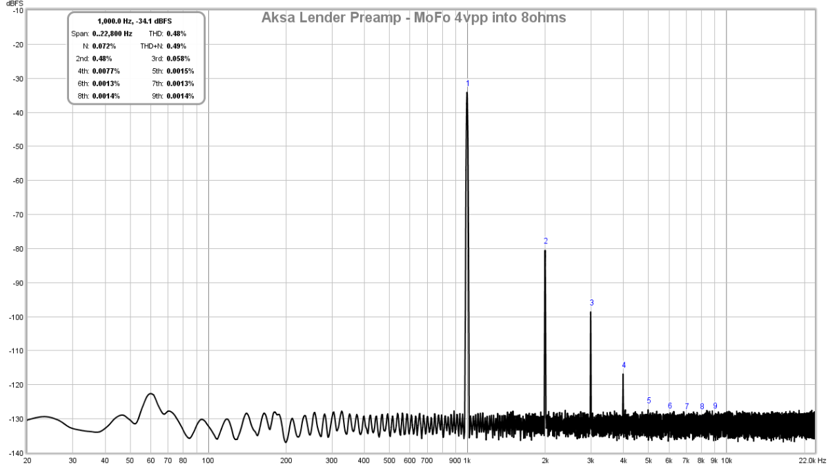

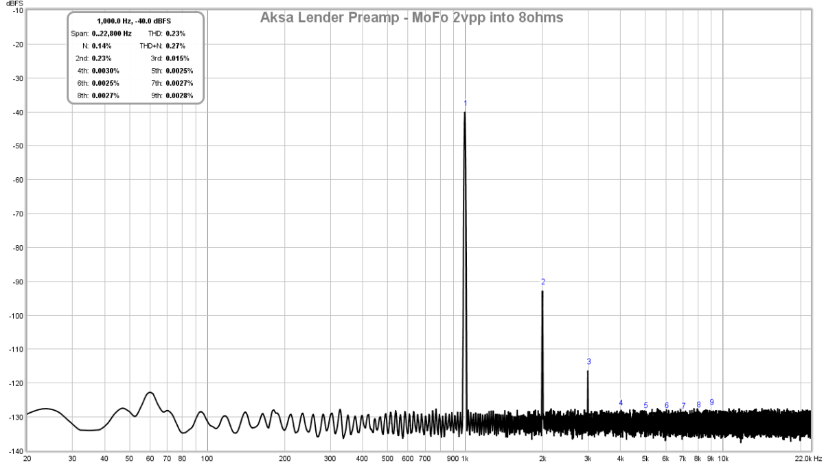

Here is MoFo at 2Vrms and 4Vrms at 8ohms, 2.83Vrms would be somewhere in between:
Vix is looking to utilize the MoFo psu which is lower voltage and bias current than LuFo. Would the above LuFo measurements be accurate in this case?
1.7A and 19v is well below the point at which current or voltage limit is an issue which is why I only compare at 2.83vrms. The MoFo should be able to do about 11w. The LuFo would have even more advantage at higher power but at lower powers the comparisons are not current or voltage linited and comes down to intrinsic distortion.
