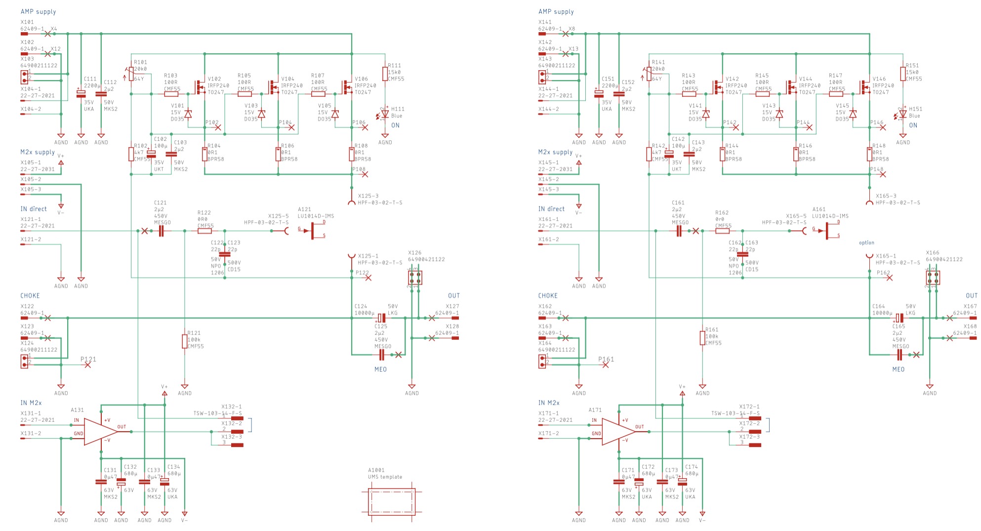

These parts below exist in LuFo-BOM-Rev02b-Nov-02-2021 (#756) but I ordered parts with the shared mouser cart by Vunce (#195) already, then I missed these and I must order these additions.

I've select parts for these.
R181, R191 <= 71-CMF55100K00FHEA
R183, R193 <= 71-CMF5520K000FKEK
R184, R194 <= 594-64W102
C184, C194 <= 667-EEU-FC1J470BJ
C121, C125, C161, C165 <= Mundorf EVO Silver Gold Oil 2.2uF 450V are so expensive. Any other recommending parts?
C122, C162 <= 22p ?? or 10µ ?? What is value of this? Could you recommend for this part?

C122/162 is 22pF - use NP0 SMT or alternate silver mica.
Instead of Mundorf use any quality 2.2uF MkP - Wima, Vishay, Audyn, etc.

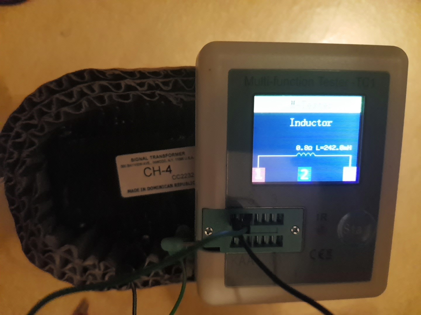

Can I use this CH-4 choke as it is?
These values is far from its' own specification ( 600ohms DCR, 70mH )
This LCR meter is cheap one, but this inductance value is so high.

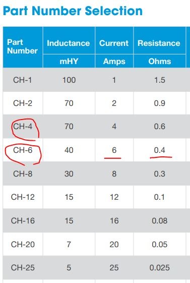

That works fine. Too high of mH is not a problem. Low 0.6ohm DCR is excellent. Make sure it can handle continuous DC current on 4A range.
If continuous current is more important than inductance, CH-6 looks better than CH-4.
Is it right?
CH-4
https://www.mouser.kr/ProductDetail/Bel-Signal-Transformer/CH-4?qs=0/2GmT7MRM9RsVUzZKxOJw==
CH-6
https://www.mouser.kr/ProductDetail/Bel-Signal-Transformer/CH-6?qs=0/2GmT7MRM9L5fKGGIdMww==
