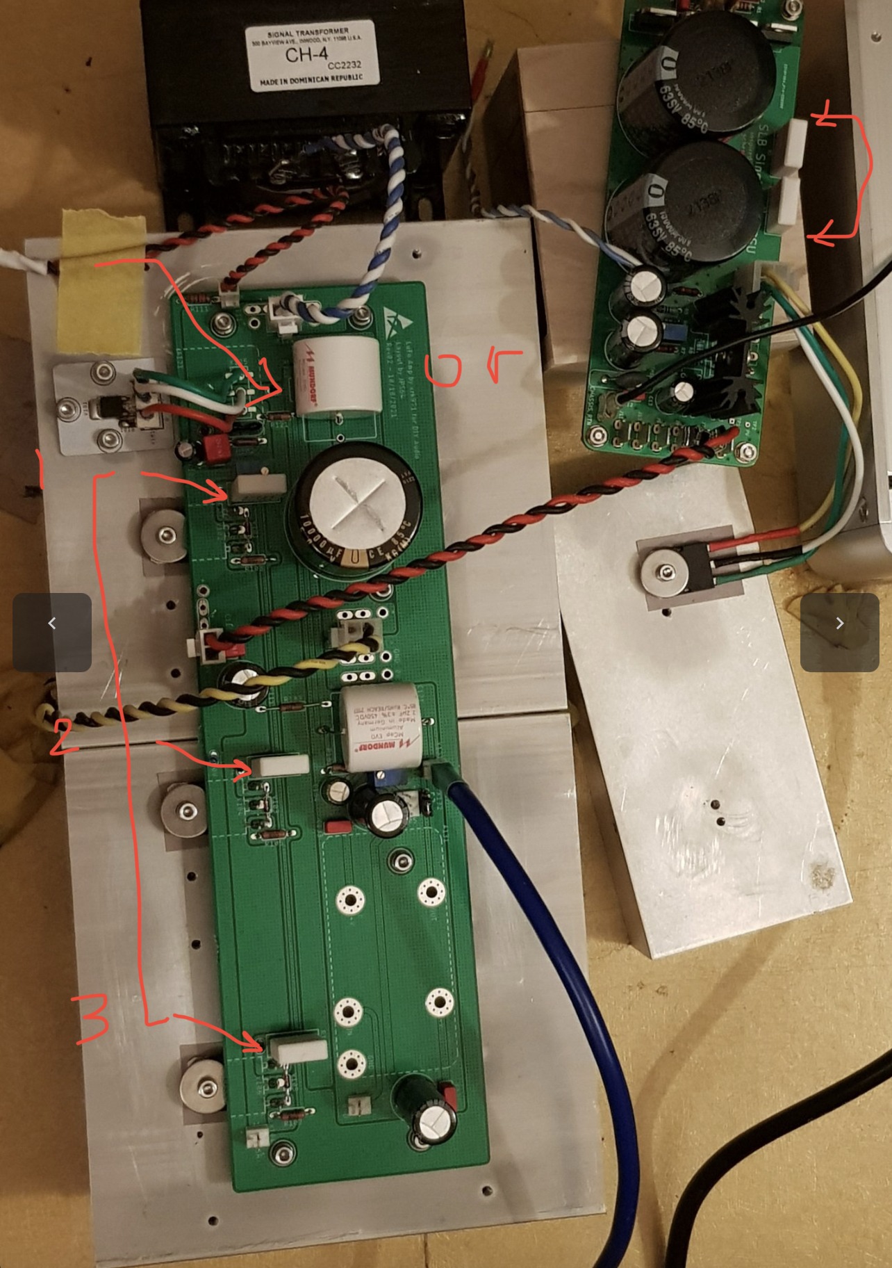

The power voltage is 30V from single rail SLB and 400VA trans without load.
I'm using curve tracing matched LUs from @mbrennwa.
I using 300x150x75 heatsink per channel for testing.

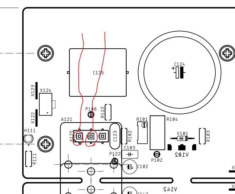

There are test points on pcb.
What voltage range between these test points is acceptable ?
P102 - P108
P104 - P108
P106 - P108
Is R101 trimpot for adjusting bias?
How can I check bias?
Is R184 trimpot for adjusting Vds of LU?
How can I check Vds?
What Vds range is acceptable?

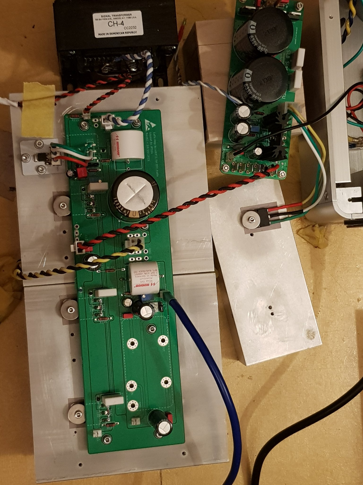

I powered it up ... and no smoke.
I measured these test points.
P102 - P108 : 0.089V
P104 - P108 : 0.104V
P106 - P108 : 0.135V

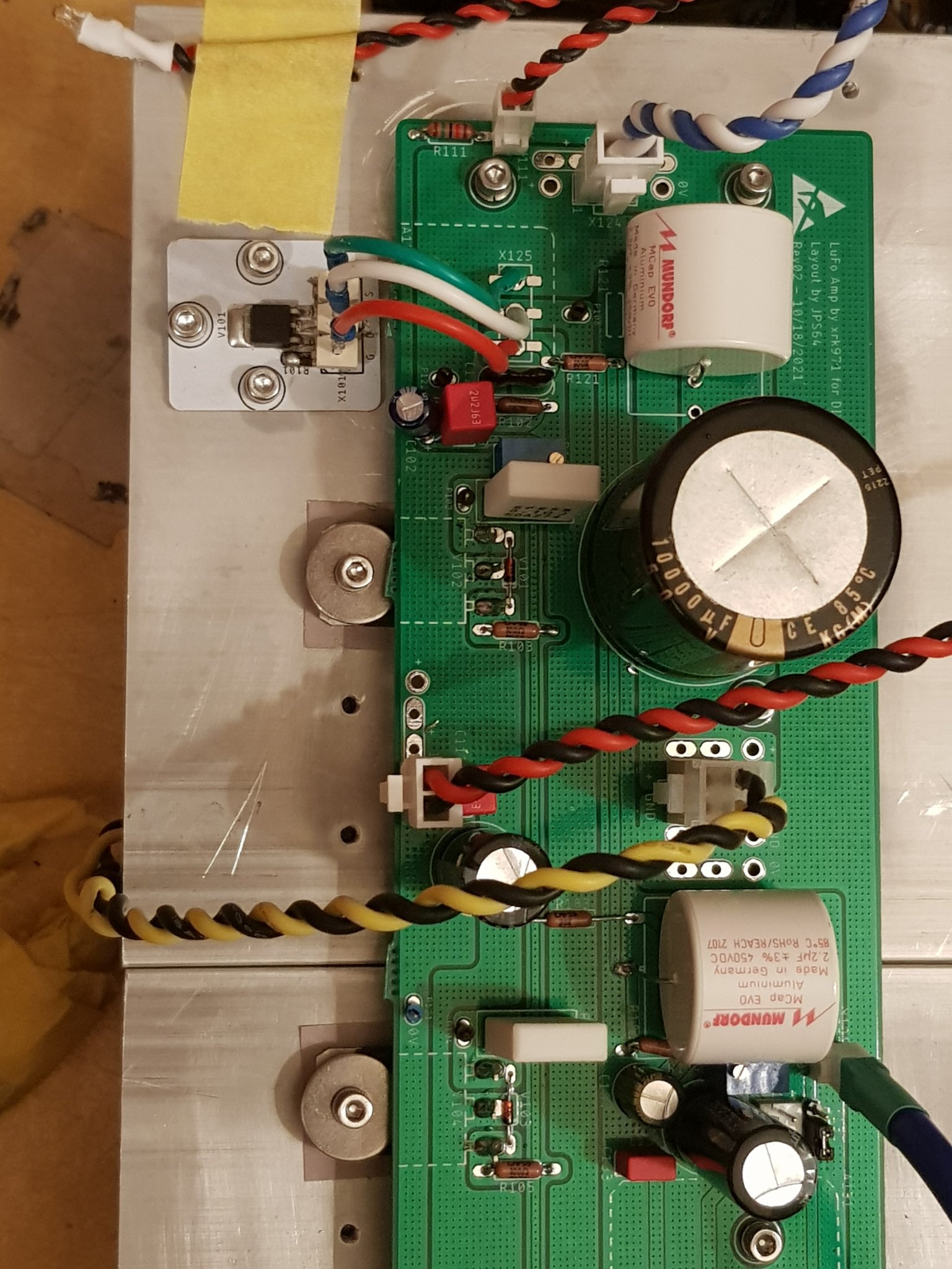

Can I measure vds by connect two leads of voltmeter to drain source pins of LU?
DC offset : 1.78V
some wrong.
I measured the voltage drain - source pin with two leads of voltmeter directly, and it shows me 0.09 ~ 0.16V wiggling.

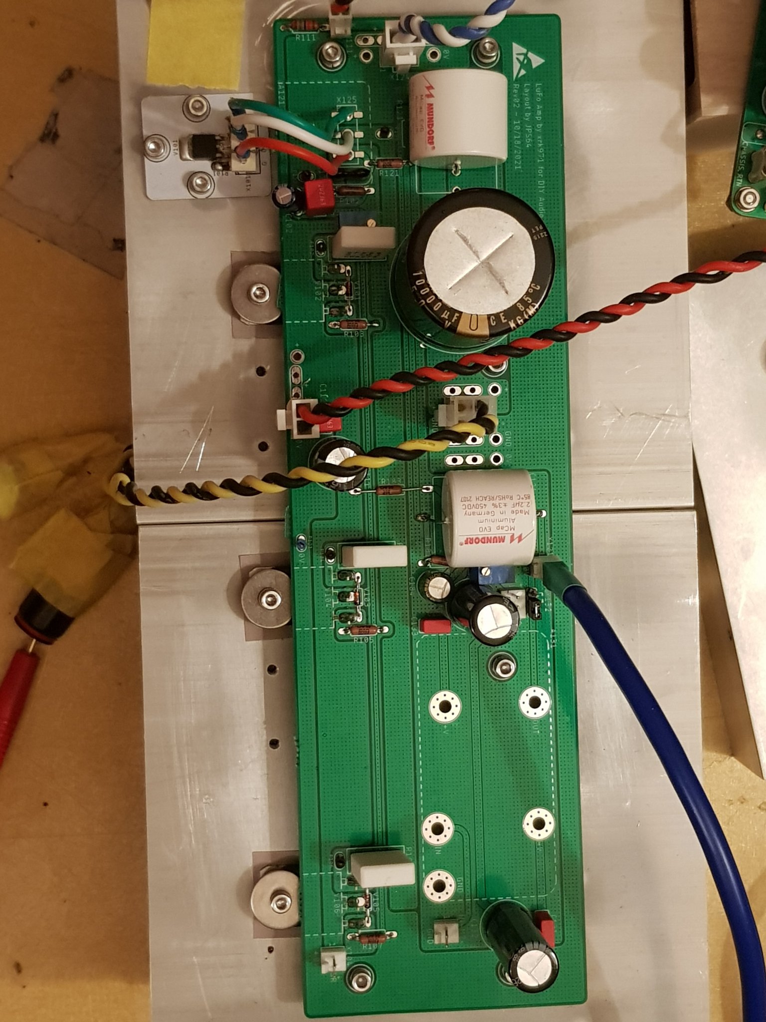

I measured again with 8ohms 50W resistor.
DC offset below 0.1mV.
Vds of LU : 2.27V
P102 - P108 : 0.098V
P104 - P108 : 0.110V
P106 - P108 : 0.144V
... and I adjusted Vds to about 2.6V with R184 trimpot.
Vds of LU : 2.70V
P102 - P108 : 0.063V
P104 - P108 : 0.093V
P106 - P108 : 0.120V
I'm using two heatskinks with no heat spreading part. 55 C of one heatsink and 25 C of other heatsink.

Ohms law apply to each to calculate current then add all three since in parallel. Assuming the three big white resistors are 0.22ohms:
P102 - P108 : 0.10V —> I=0.1v/0.22ohm=0.45A
P104 - P108 : 0.11V —> I=0.11v/0.22ohm=0.5A
P106 - P108 : 0.09V —> I=0.09v/0.22ohm=0.41A
0.45+0.50+0.41A = 1.36A
But if you have 0.1ohm resistors then current is about 3A. Or if your inductor DCR is 1ohm vs nominal 0.5ohm per design then currrent is 1.5A.
What is DCR of the CH4 signal transformer used for inductor?
attachment.php
Looks like you are measuring across correct test points.
Or measure voltage across the two white BPR resistors on SLB. I think these are 0.1ohm+0.1ohm = 0.2ohms.
