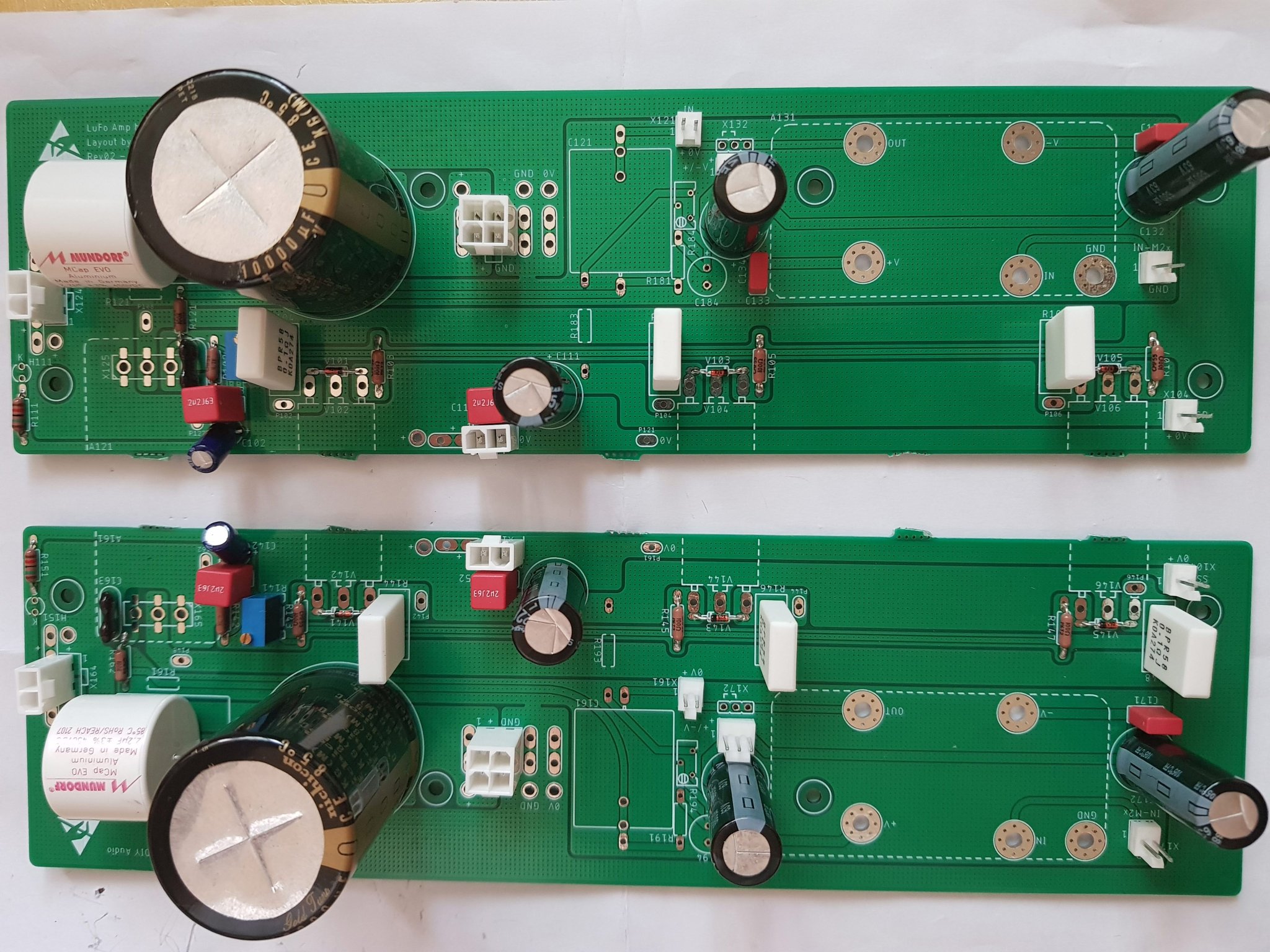

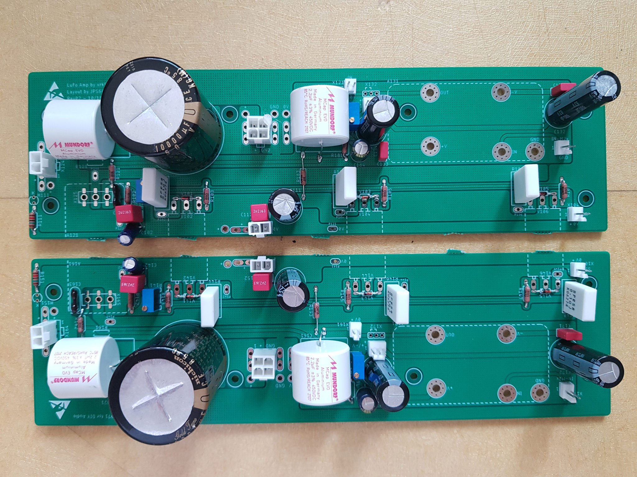

I have some progress.
I've ordered parts with the shared mouser shopping cart by Vunce.
I noticed that shopping cart was not latest version later.
I've reordered and installed C132,134,171,173 as 680uF ones.
V122,V162 was not necessary.
I need to order these.
  • latest BOM missing parts (R181,R191,R183,R193,R184,R194,C184,C194)
  • test point pins (534-5001, 534-5117)
  • MELF Resistors 0.4W 100ohms (594-MMA02040C1000FB0) on LU1014D adapter board.
  • Samtec terminal (200-HPM0301TSVS) on LU1014D adapter board.
  • and most important matched LU1014D 2pcs.
I have a question.
C122, C162 - C1206 22p, 15V or 50V or 100V. Which voltage is correct?
I installed a 100V one already. https://www.mouser.kr/ProductDetail/KEMET/C1206C220J1GACTU?qs=0o7GJvaaAD5Q2XtoystSpw==

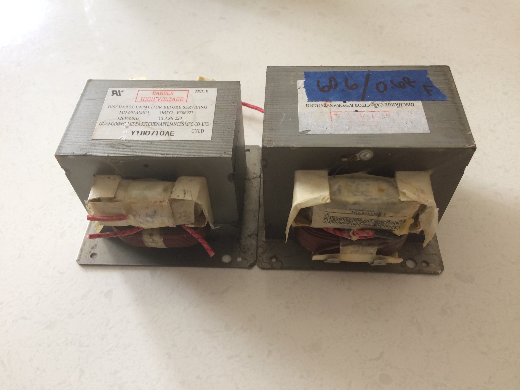

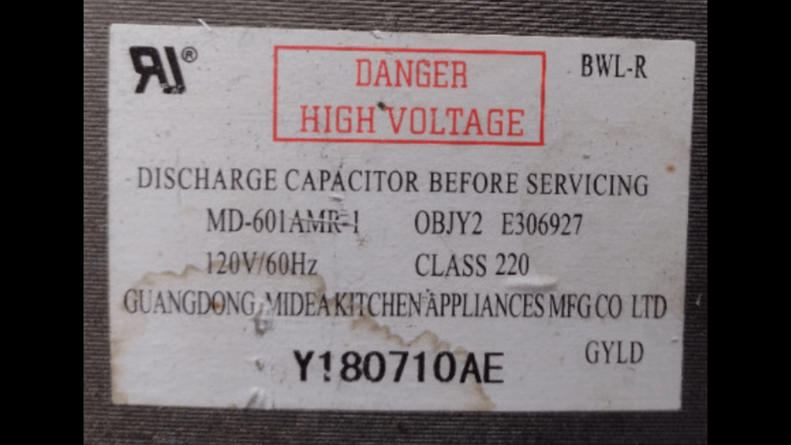

Hi
Many choke have been listed inside this thread. I have an opportunity to buy a pair, model is MD-601AMR-1
Since the seller can’t verify the small DCR value, as anyone used that model and if so did it work properly in the amp.
Eric

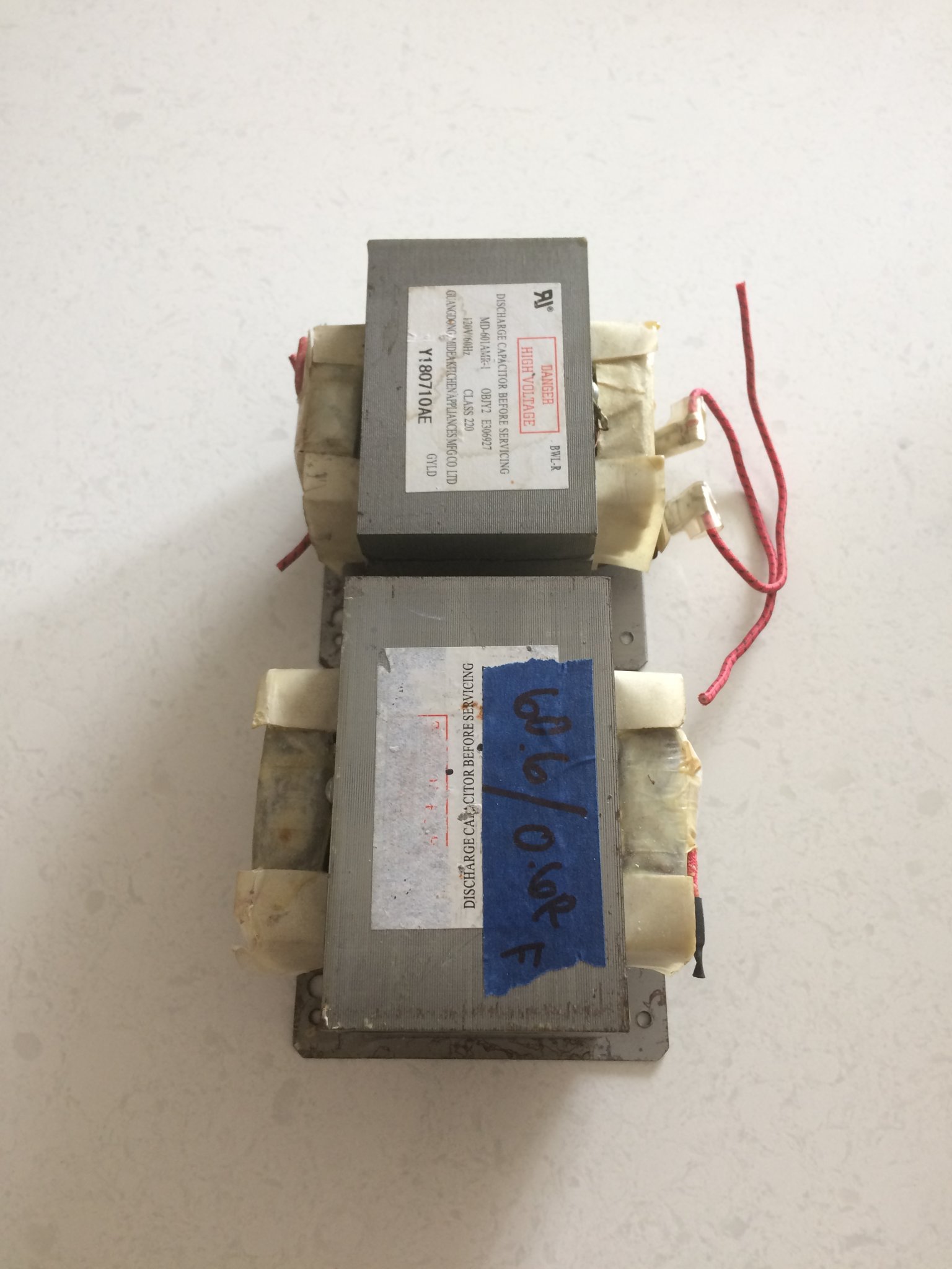

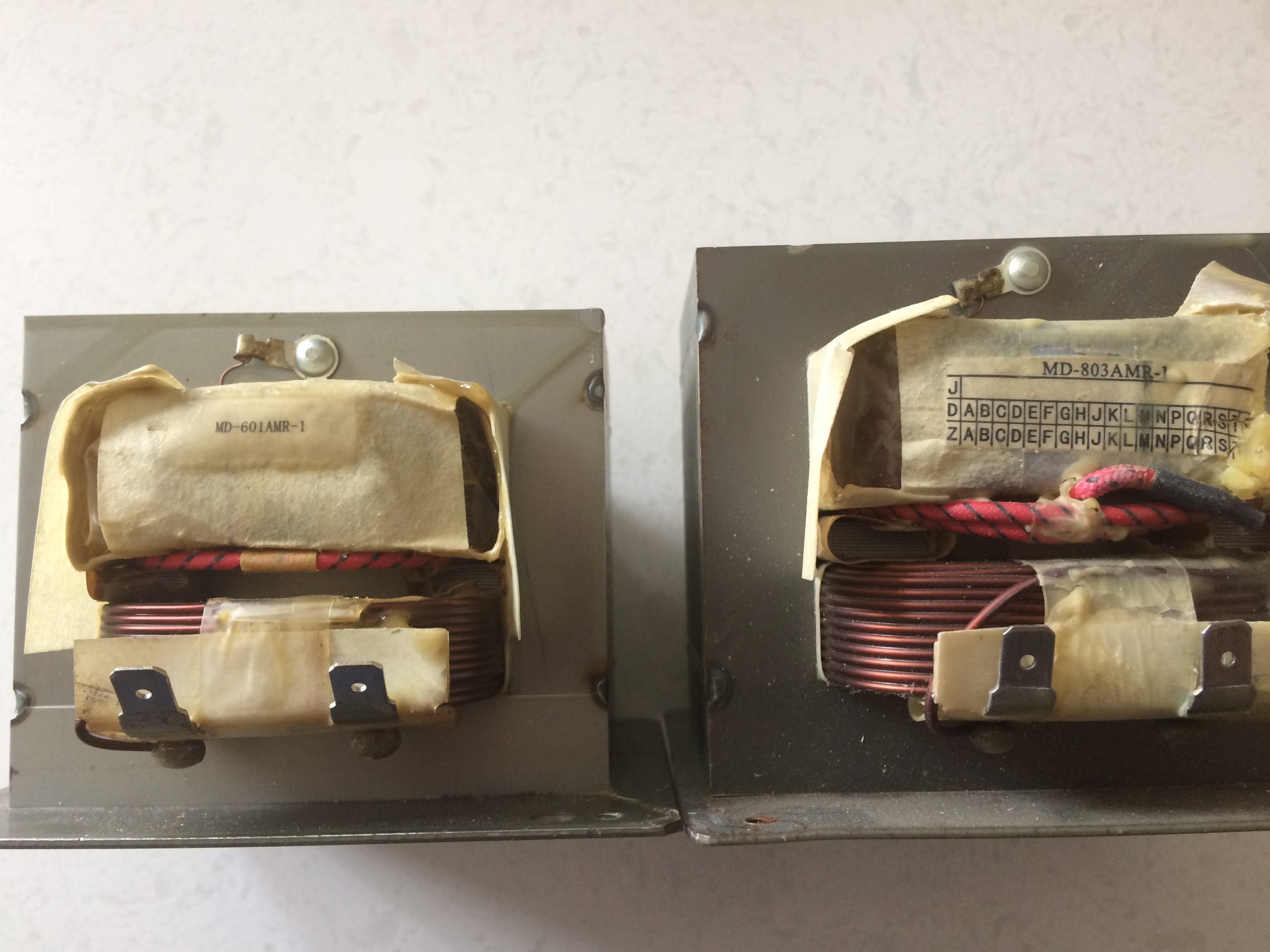

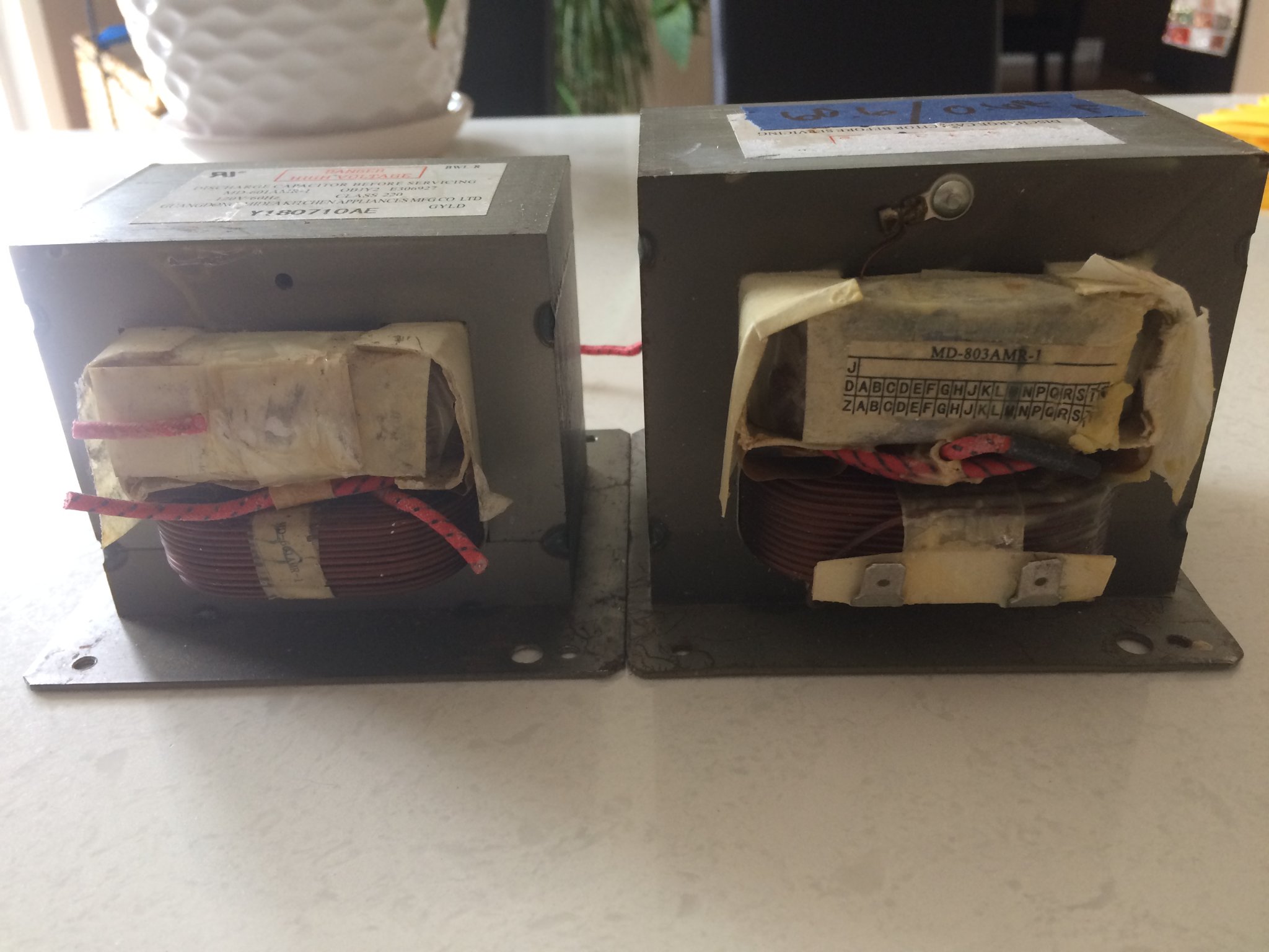

Ok, I received my 2 MOT which are the same model but read differently...
MOT no.1 DCR 0.5 ohm, L 50mH
MOT no.2 DCR 0.5 ohm, L 130mH
What could cause such a difference?
Could I still use them although the L value is very different?
BTW, I was expecting much bigger MOT, these are for 600W oven.
Eric
The difference in L won’t matter. That just means it has deeper reserve for more bass in that channel but 50mH and 0.5R is perfect. There might be something different on the airgap of the one with the higher L. It may have been bumped and gap is smaller, and hence inductance higher due to better efficiency of the iron core.
