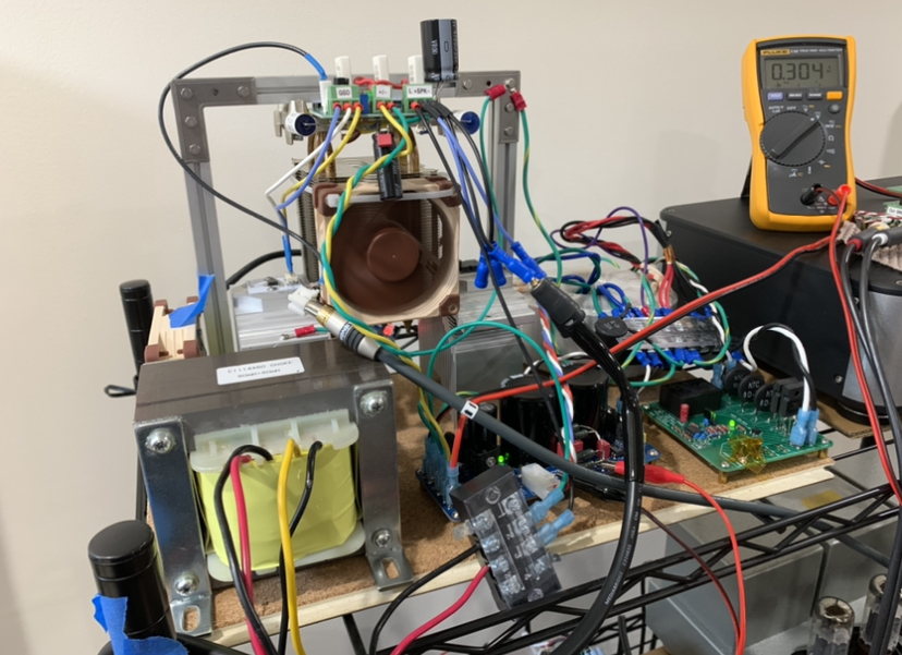

I tried something interesting. I connected the free winding to a speaker and it sounded great! Basically a transformer output coupled SE Class A amp with choke load. Maybe sort of like the Zeus but running full Class A. I guess one avoids the output coupling cap this way too.
Hi Mgb1965,
Yes, connect that winding to speaker. You don’t want to short it. It would be like driving a shorted 0ohm speaker.

How much output can you get from that side of the transformer? Still 39W?
It’s using the same stored energy so not sure if one could make a balanced output amp with the half the signal from the cap coupling and the other half with the transformer coupled output.

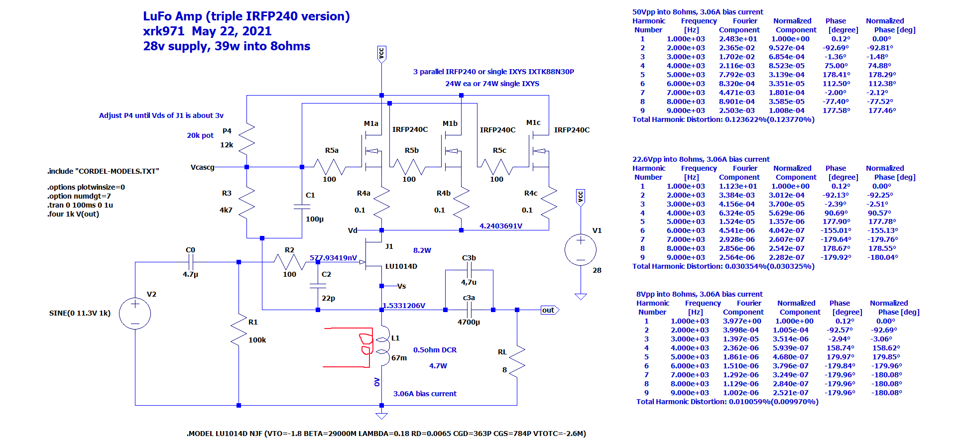

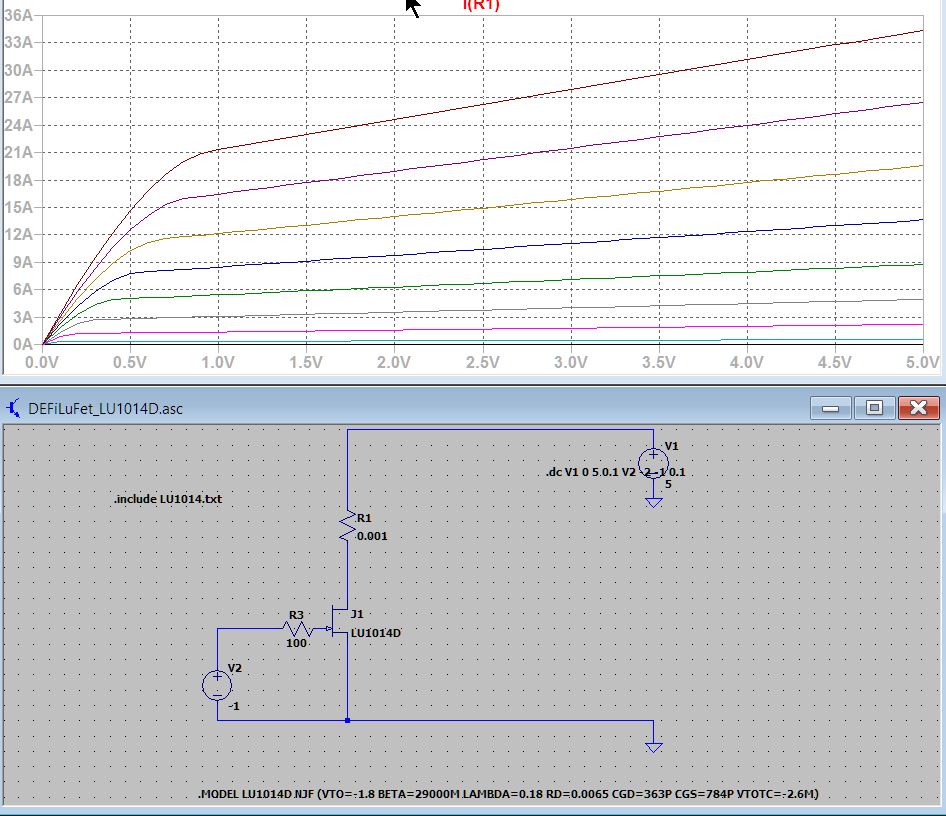

I might be wrong.
But the LTSpice model for LU1014D used in Post #1 might be problematic.
I couldn't get the wished Id-Vds curve with the model.
Sorry, I don’t know much about ability to predict the “wished” Id-Vds curve, but the model predicted the DC setpoints and measured distortion of the LuFo amp almost spot on.
