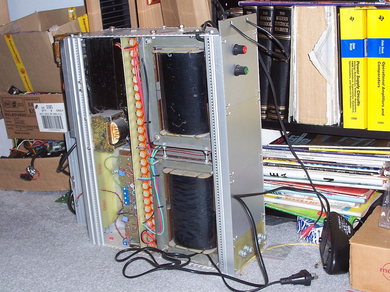

Hi Circlotron,
I remember your huge amp now. Those are some inductors you have there! 28v and 3.5A sounds familiar. 🙂

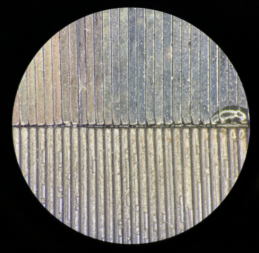

Thanks dBel. The laminations moved a bit during transport. They were packed in foam but this is such a dense object I think an impact just made the choke push through the foam and hit whatever it was hard. The measured inductance seems within spec. The DCR is a bit high at 0.88ohm though. They are just samples so we may have to refine the specs and construction before the final order.
Hi Hugh,
Thank you. These inductors turned out nicely I think. That impedance sweep looks very good. The manufacturer tells me he is very confident about the DCR - measured with professional bench LCR meter at 0.484ohms. I will check my DATS calibration to make sure it’s good. 11lbs 5oz is a heavy dense object though.
Here is the air gap under a microscope. The spec was 0.1mm - I am told there is paper used inside to set the spacing before it was glued and bolted together.
Hi Meanie,
Here is the airgap (I forgot to include in the earlier post):
970298d1627438010-susylu-91208aa9-1bea-4171-bf47-888cf49d08d6-jpeg
The air gap helps to prevent saturation from a DC field. If you don’t have DC then air gaps are important. Such is the case of a toroidal transformer. Air core inductors don’t have the saturation issue but are huge for the same value of inductance.

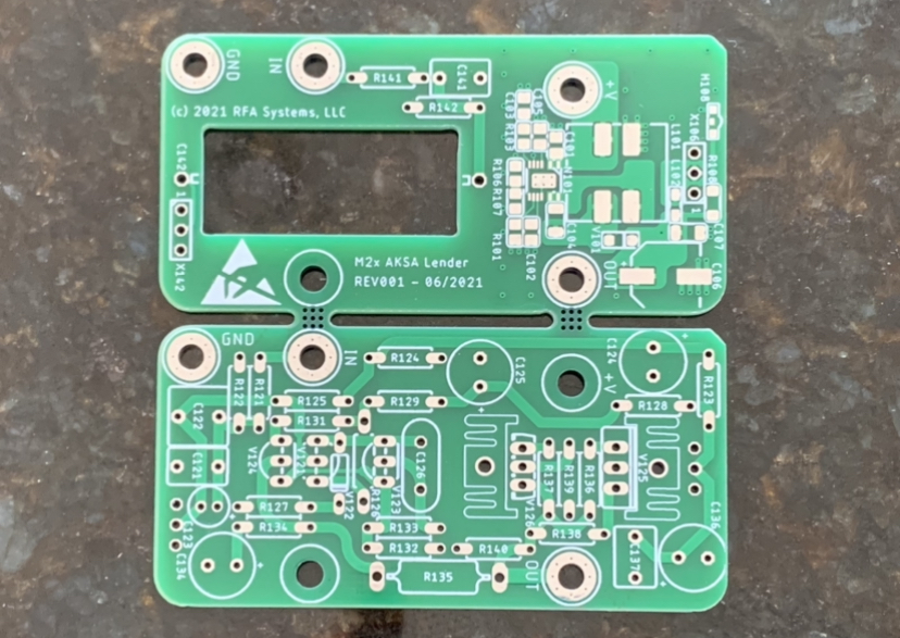

The prototype for the latest preamp board, the Aksa Lender in Yarra/M2X format has just arrived. This has an on board DC-DC booster to 55v from lower voltages circa 12v to 32v. Another beautiful layout by JPS64. Thank you, JP!
attachment.php
