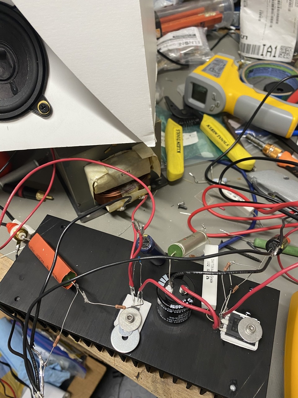

With all connections re-flowed I’m getting music! Having temperature issues though. The 2.2ohm 10w resistor after the MOT keeps climbing in temp. I shut it down at 100C. I’m also measuring about 3.5v at the jfet source. Other than that, sounds great!
Awesome news Jwjarch! It’s a simple circuit and not much to go wrong but things do go wrong. I had the same issue with a bad connection. Once that was fixed, music came out. Maybe what we need is one of those aluminum heatsinked resistors? Or maybe two 4.7ohms 10w in parallel and that should take the temps down. Those cement filled resistors can run hot but are a hand burn danger. As long as they don’t run above their 10w spec you are ok. They turn brown and smell funny when they run above their spec.

The sound was very clean and detailed as far as I could tell. In true XRK style I played some Metallica over a dual 3fe25-16 Mini-K. Worth building another channel for stereo I would say. I have some beefier resistors that I’ll try out, X. Here’s a photo of my current dead buggery.
Way to go with playing Metallica on Karlsonators! Btw, try the 0.68mH and 4.7ohm BSC mod on the dual 3FE25-16’s. They round out the sound and give it some true bass.

I love simple amps. I think 3 of the gold anodized aluminum 8ohm 25w resistors in parallel would be 2.7 ohm load and would be perfect for spreading the heat out.

The gold resistors are doing their job well. Overkill? Maybe... But it sounds fantastic! Running nice and cool. Each resistor is at 23.5C. Heat sink is about 30C.

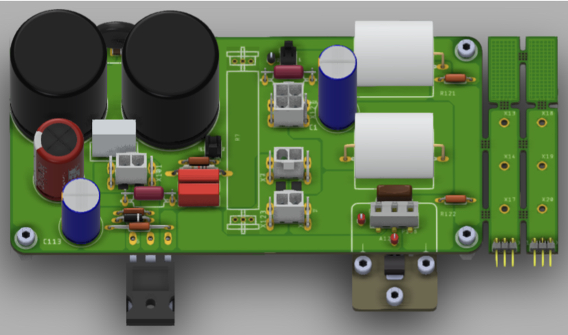

As suspected, JPS64 was already on the prowl making a new LuFo Lite board 🙂
It looks wonderful, thank you, JPS64. There are a lot of options on this board such as Fastons, flying leads, or Molex MiniFit connectors for power, speakers, and MOT. There is an option for external heatsink mounted resistor or use the on board “fence post” style triple elevated resistor mount. Having a built in cap multiplier and CRC will give this amp excellent low noise performance and built in slow ramp up to prevent startup speaker pop.
