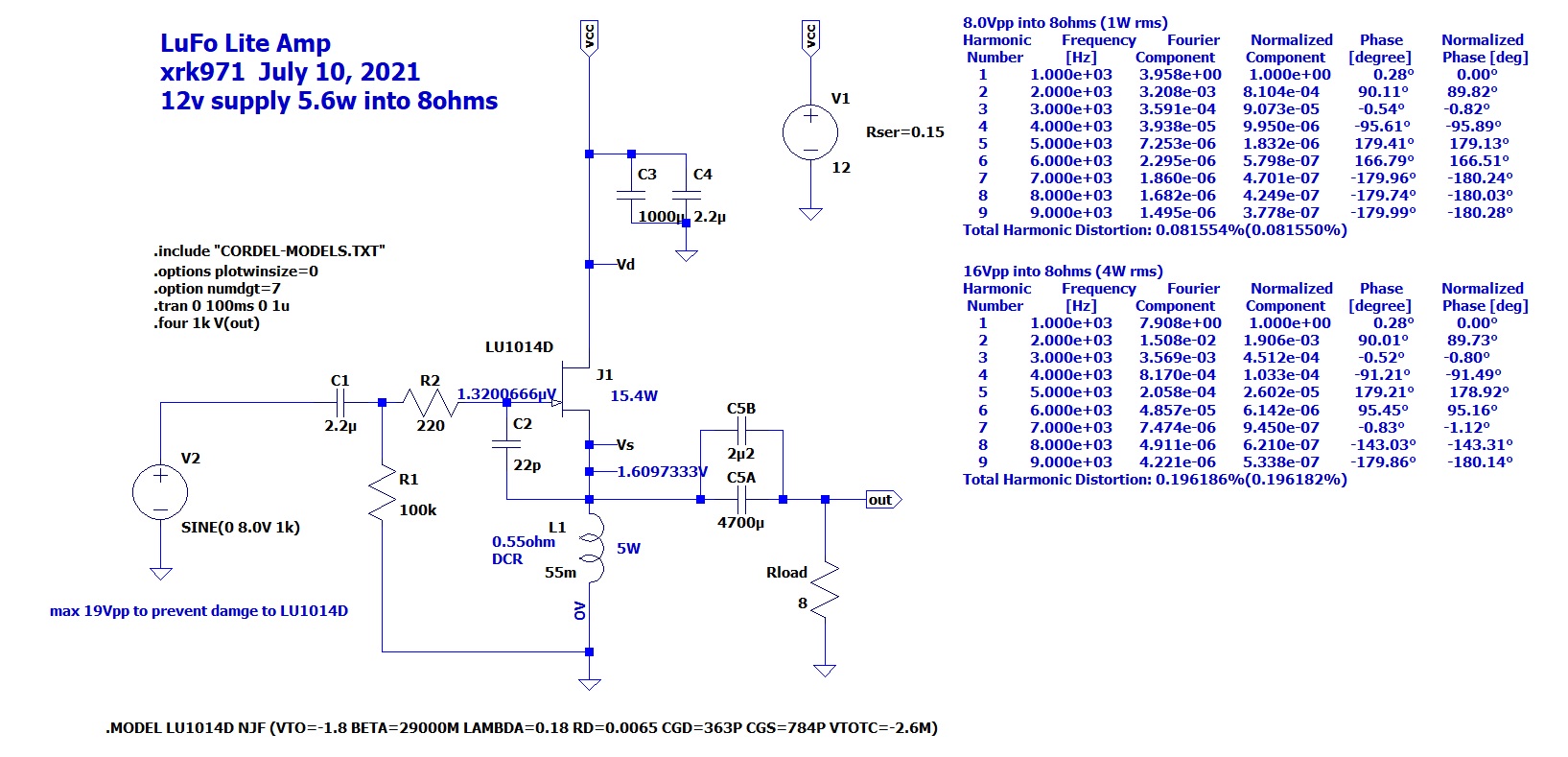

Let me see what I can get out of a LuFo-Lite simulation. So let’s make rail 20v and skip the cascode. I think bias current circa 2A should be good. Same MOT - typical 55mH and 0.55ohm DCR.
Let’s assume a cap multiplier is used so supply is 24vdc and 3.5v drop across the cap Mx, and another 0.5v drop across the CRC.
PSU is 24v 5A SMPS brick.

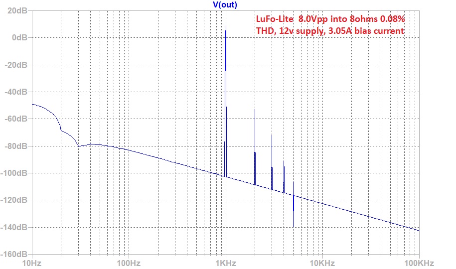

I tried it with a 20v rail and you can theoretically get 20w out of it. But wait, ... without the cascode, the LU1014D is limited to a maximum of 20Vpp swings or it will self destruct. So to keep things safe, let’s say 19vpp. With that, only a 12v supply is needed and max power is 5.6W. However, the amp is very simple and has a great harmonic profile. Should be a fun fleawatt amp or a superb and very powerful headphone amp. The 12v lends itself to battery usage schemes for very low noise PSU's. Or certainly there are some very capapable low noise 3A 12v supplies floating around. Total dissipation is only about 15w so not a big heatsink. Bias current is automatically set at around 3A based on DCR of your choke. If you have 1ohm DCR choke, this can work well too as the bias current will drop to about 1.5A and heat output will drop in half.
The Hammond chokes will work well for this I think. As you can see there are no bias current adjustments - this is an adjustment free amp. Turn it on and it should stabilize. At 1.0ohm DCR, bias current is 1.65A, but the dissipation in the LU is still about the same, the dissipation in the choke is less, and the THD actually goes down to 0.06%.

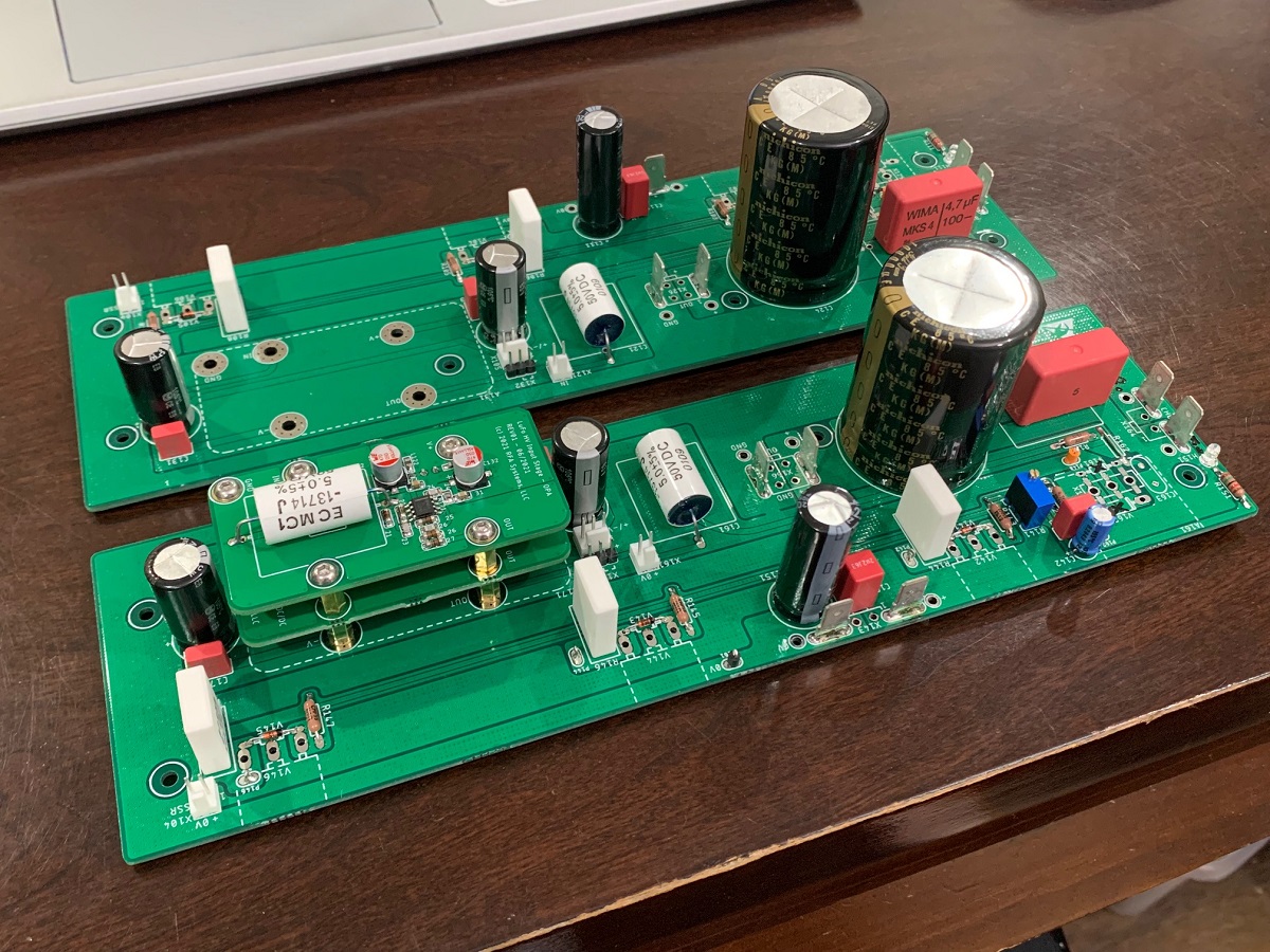

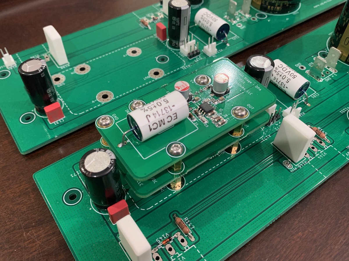

I finally found some time to assemble the LuFo amp boards. I will need to build the other channel of the OPA454 front end board. Then drill and tap holes in a heatsink.
attachment.php
attachment.php
attachment.php
This is a really roomy board with not so many parts to solder. It went pretty easily and quickly.

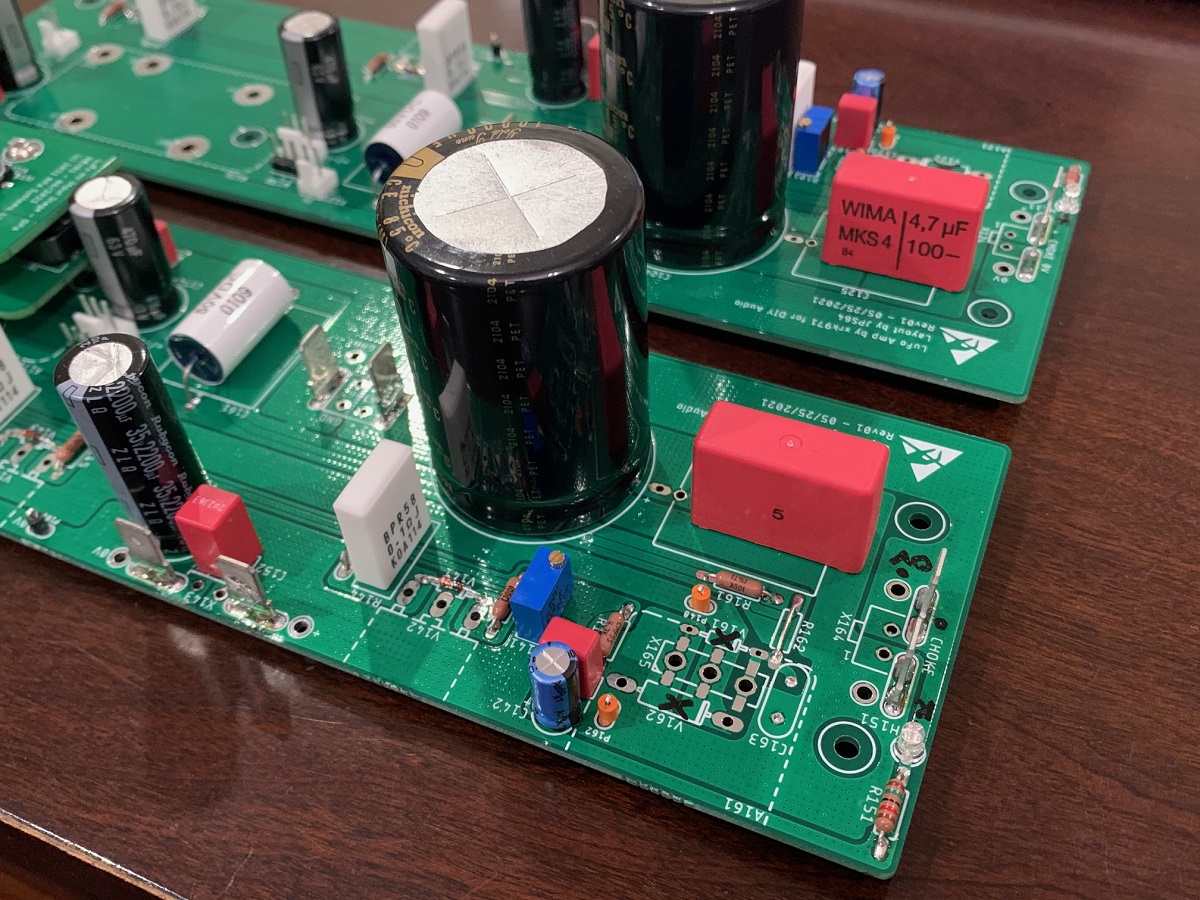

I looked over my build notes, the polarity labeling for H111 is reversed. Anode should face R111. Do not populate V121/V161.

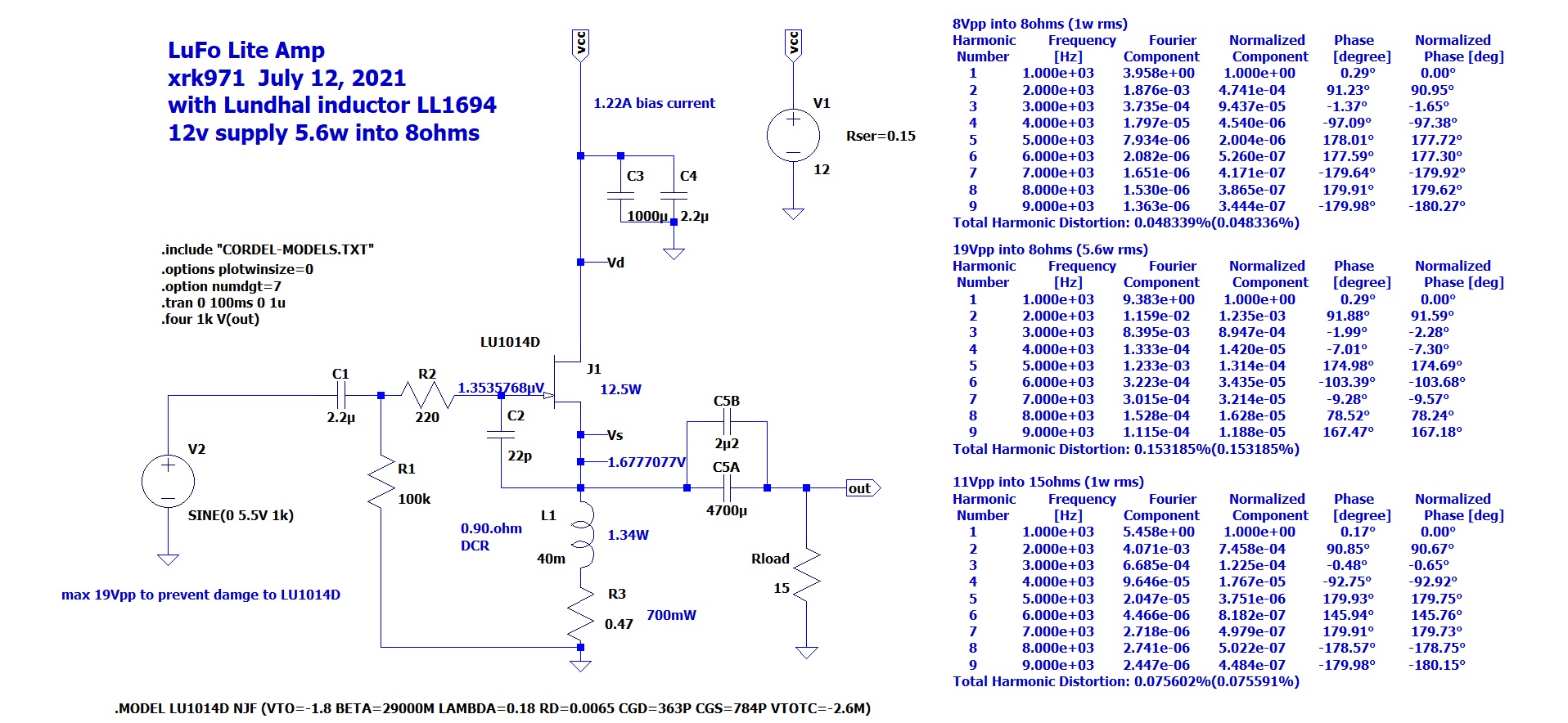

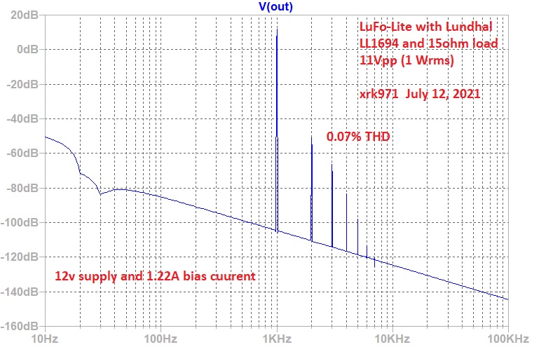

Hi X, regarding the LuFo-Lite simulation you posted, I have a pair of Lundahl LL1694 filament chokes, with the windings paralleled they are good for 3A with an inductance of 40mH and static resistance of 0.45ohms. Any chance of you substituting those values into your simulation with 8 and 15ohm speaker loads? Output cap values can probably be halved with 15ohm load.

Thanks for the build notes! I think I got them all. I took a Sharpie and made notes on the board and X-out the Zener on the JFET and also caught the A vs K error on the LED. There is also a misplaced + sign on one of the inductor terminals. One thing that needs to be changed is how close one of the 0.1ohm resistors is the pot on one channel. Literally 1mm away and that thing might get warm. The painful process of drill and tap on the heatsinks is near. I still need to assemble the second channel front end and assembled the second channel monoblock chassis.

Hi Nautibuoy,
I think if you want to use this at low power for your Lowther horn or a small full range OB, there’s no need to run at 3A. So let’s use a single Lundhal at 90mH and 0.9ohm and see how that works. I will simulate for 8ohm and 16ohm load. Note that 16ohm load needs more voltage to get power out. You may be better off with at least a single cascode to get more voltage swing. Otherwise 19vpp into 16ohms is only 2.8w rms.

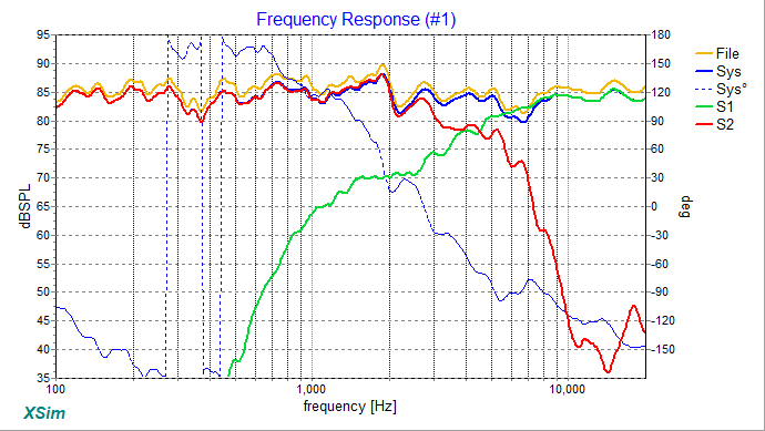

Great idea to use 4ohm speakers! Sorry I couldn’t get to the sim yet, I was busy developing a new speaker crossover which happens to be nominally 6ohms but dips to 3.6ohms - LuFo Lite territory! Predicted is blue and measured actual is orange. Another passive Harsch XO.

Here is the LuFo Lite sim for the Lundhal inductor, for 8ohm and 15ohm load. FFT plot for 15ohm load - I think the Lowthers would sound good. This is 11Vpp so there is still 19Vpp max for some headroom. 96dB is quite loud at 1w.
