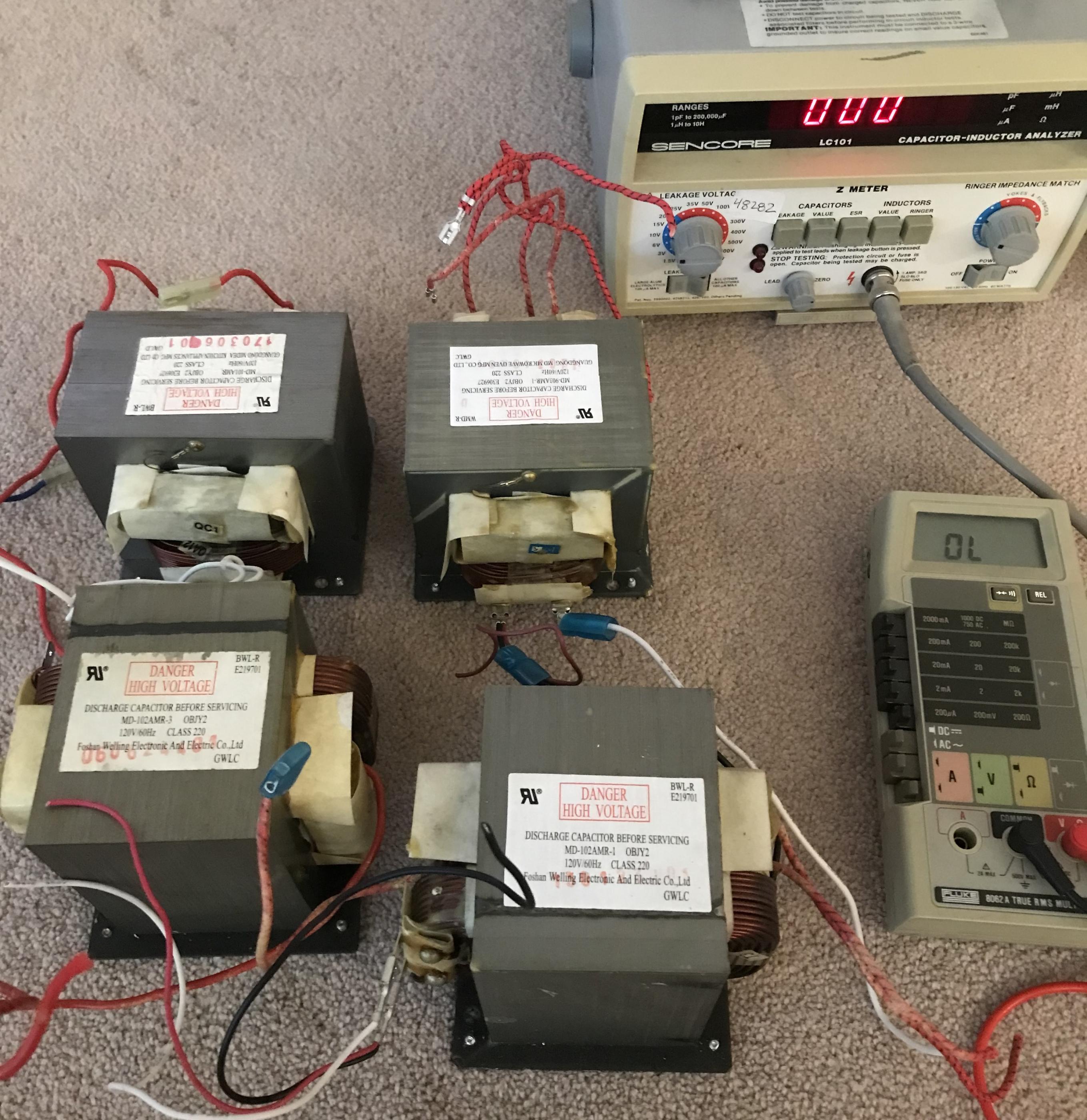

I managed to get off a bit early from work and got several broken microwaves on the way home. Spent a couple hours in blazing heat in the garage to extract the transformers.
Resistance test was using Fluke 8062A
Inductance test was using Sencore LC101
Both testers were not recently calibrated.
Results:
MD-101AMR 0.42ohm 23.9mH
MD-102AMR-1 0.41ohm 24.8mH
MD-102AMR-3 0.40ohm 26.4mH
MD-903AMR-1 0.47ohm 26.3mH
Not too sure whether these are still good for this build.

TH,
Were these MOTs from a 220-230 mains?
I suspect they are 120V however.
Not really enough inductance. We need a minimum of 50mH for 8R speakers, and 100mH would be ideal, but such monsters are very large, expensive and heavy.

Nice work TagHeuer!
Those MD-102’s are massive. There’s no way it’s only 25mH unless it’s broken or your LCR is off calibration. Those are all 120v units from the label and as you are in Canada. Did you happen to drive by curbs on trash pickup day?
Extracting them is a b!txh - a lot of sharp corners and sheet metal to deal with.
See if you can get another measure of L - do you have a DATs or a $15 transistor tester with LCR?
Those transformers are 120V.
The Sencore LC101 is primarily used for measuring capacitor leakage and values and so far it has done pretty good jobs.
However it is most likely out of calibration for measuring inductance. Sorry guys for providing inaccurate results.
As for source of those transformers, I was searching local ads from kijiji (similar to craigslist) for free microwave and there were several of them in the area.
Unfortunately I don't have other meters to measure inductance at the moment. I'll see whether I can borrow one from my friends/colleagues.

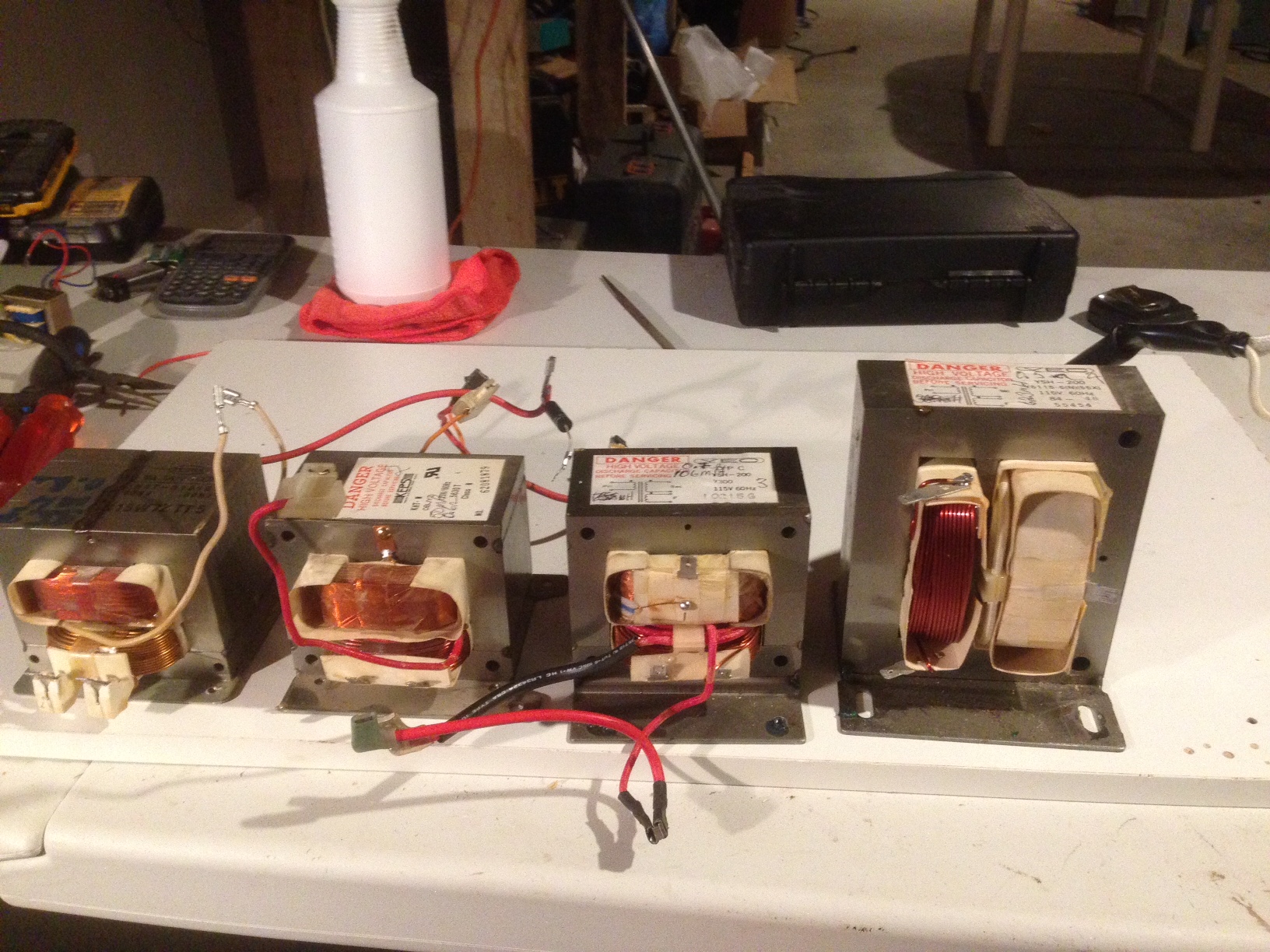

Hi X,
These are my 4 MOT's
From L to R I measured the static inductance and the resistance of each using my transistor tester. I measured the inductance of each MOT until the readings did not vary much.
MOT - Left: 94.73 mH, 1.9 ohms >>> 91.13mH, 1.2 ohms after 25 readings.
Next - 97.33 mH, 0.9 ohms >>> 93.23 mH, 0.9 ohms after 25 readings
Next - 271 mH, 1.2 ohms >>> 261 mH, 1.0 ohms after 25 readings
MOT - Right: 103.9 mH, 0.9 ohms >>> 102.2 mH, 0.9 ohms after 10 readings
From my LCR meter:
MOT - Left: 56.8 mH, 0.9 ohms Next: 51.2 mH, 0.6 ohms Next: 124.8 mH, 0.8 ohms MOT - Right: 63.9mH, 0.5 ohms
Any reason for the difference in the inductance readings from the LCR vs the Transistor tester? Both test units have good batteries. Which one to believe.
I do have a DATS V3 that I could fire up to also check measurements.
Thanks for the help,
MM

MM,
The measurements are static.
However, unlike resistors and capacitors, inductances are not constant.
Inductance varies with frequency and amplitude of the test signal (to name the most important variables).
LCR meters measure with small signals like 0.5 V at 100 Hz.
More expensive meters also measure at higher frequencies, for example 1 kHz.
You would measure different inductances at different frequencies (the core looses permeability at higher frequencies).
So in general a measurement only gives a clue of what inductance is available, and as stated before, when DC current is applied the situation is very different again.
Static measurement of inductance is mere speculation.
The only way to check the suitability of these MOTs is putting them in the amp and measure low frequency bandwidth, check for core saturation.
The only useful spec is DCR of the MOT as it biases the LU, assuming that DVM's are accurate enough.

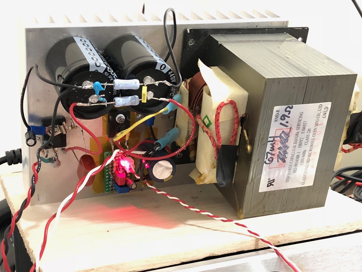

I just ordered another MOT to try out. This one is an MD-103AMR. It measures statically at 68mH and 0.56ohm DCR. It’s much heavier than the MD-803AMR that I have been using and weighs in at a whopping 10.25lbs. Hopefully that equates to more tolerance to saturation at higher currents. Will test and find out.

You could run the LU1014D as a straight follower (no cascode) like the Mofo with a 20V supply and an inductor. Probably get about 11w out of it. Use a 24v SMPS with a MOSFET cap Mx to drop 4v and get 20V of clean slow soft start power. There will t be any speaker turn on pop with a cap Mx PSU.
On my Mofo, I just dead bugged a cap Mx right onto the same heatsink and added a CRC after it.
Thanks X. Something to think on, (especially with your adaptor boards and my small stash of the LU1014D devices that is the result of the GB for Papa's donated trove) - perhaps a bi-amp solution with a LuFo for the bottom end and a Lufo-Lite for the top? Could perhaps drive both from the same preamp driver module. Will obviously have to adapt the biasing circuit if the cascode is removed.
A Lufo-Lite would be less demanding with regard to inductor selection too.
