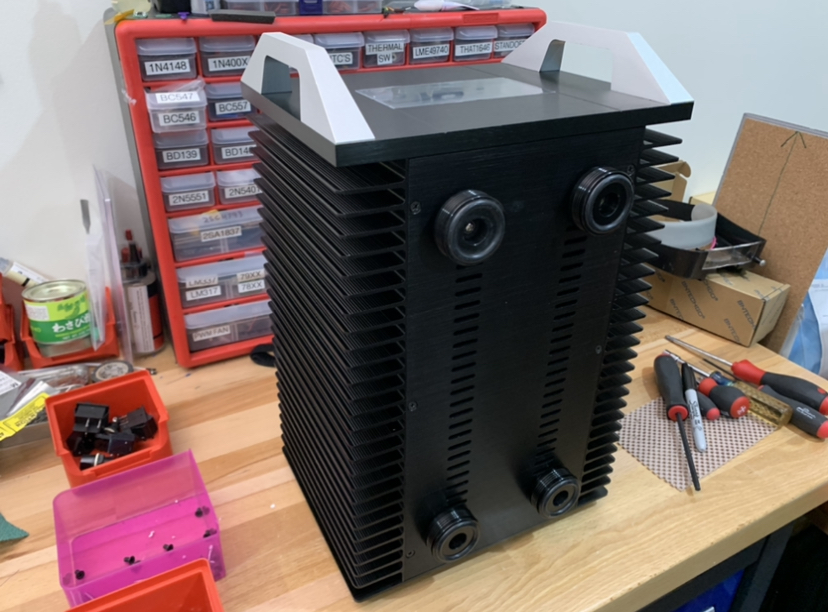

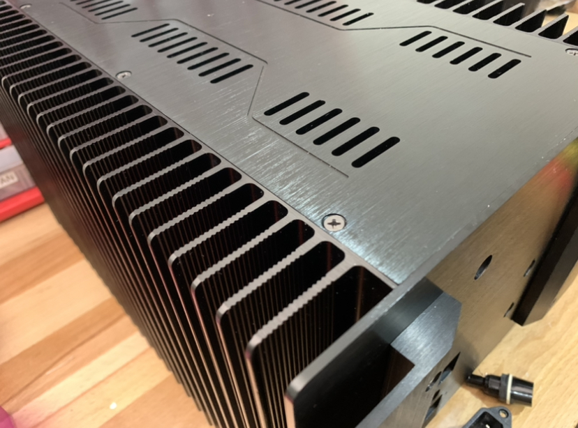

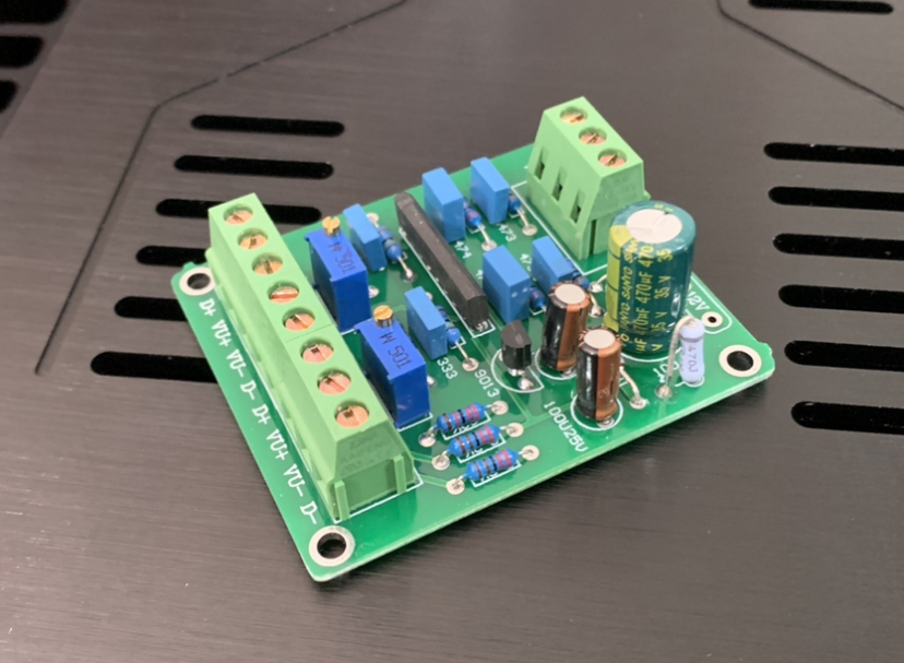

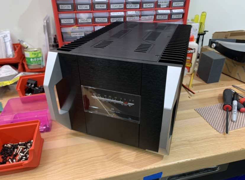

I finally had a chance to assemble the chassis (1 channel). It all fits together precisely and solidly. Very nicely made all CNC chassis. No instructions of course, but easy to figure out. The hardware was nice too. Socket cap screws and black finish bevel Phillips screws for the top and bottom panels. PC board for the VU meter driver. IEC, power switch, and fuse holder included.
So far so good. Now I need to drill and tap threaded holes for mounting the MOSFETs and LU1014D.
