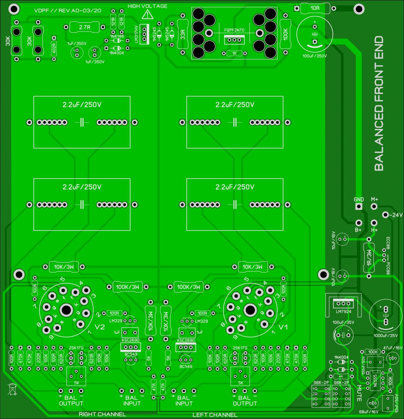

I was working on the front end to drive a source follower amplifier. Initially, I wanted to go for balanced F4 amps and my idea of design was to have the FE in a separate case and connect them with XLR cable.
Here is the PCB layout I have in mind. The PCB was not made yet. I also put a pot to adjust 2nd order harmonic distortion (as Nelson Pass suggested for F5)
It has Voltage regulator for B+ and muting circuit with delay for output.
It can accommodate E88CC and PC88 tubes.

I did some small modifications to previous layout. Removed the SiC follower (not required for this application). More flexibility on size and pin distance for output capacitors.

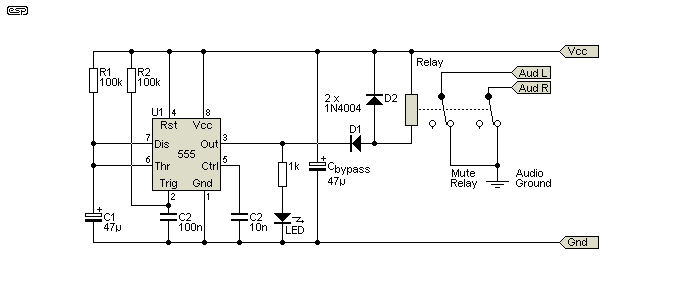

Can you share schematic? How does mute function work? Are you using two MOSFETs as SSR’s to clamp to ground?
For mute circuit I'm using Rod Elliot - Relay mute circuit, with NE555 for time delay (set up for 10 sec or more), to avoid noise and high voltage on the output until heater voltage for tubes are steady. Signal stays connected to ground until relays are powered on. Easy and effective. SSR with mosfets can work nicely as well.

In practice, if we use separate case for tube front end, the same PCB can be used, and only positive signal will be used to drive the LuFo. If we want to put the FE in the same case (tubes can pick up noise and hum from main transformer), then I can remove the voltage regulators and use DC/DC booster. If xrk971 can share the schematic for booster, I can start making a layout. The other option is to have a separate transformer to power up the tube front end.
I prefer the FE in separate case. It gives more flexibility. One can try different power followers, SE, Balanced...
If two channels are contained on a single PCB, what are the provisions for ensuring separate Anode voltage to each channel?
I ask in the interest of getting the best stereo separation and imaging.

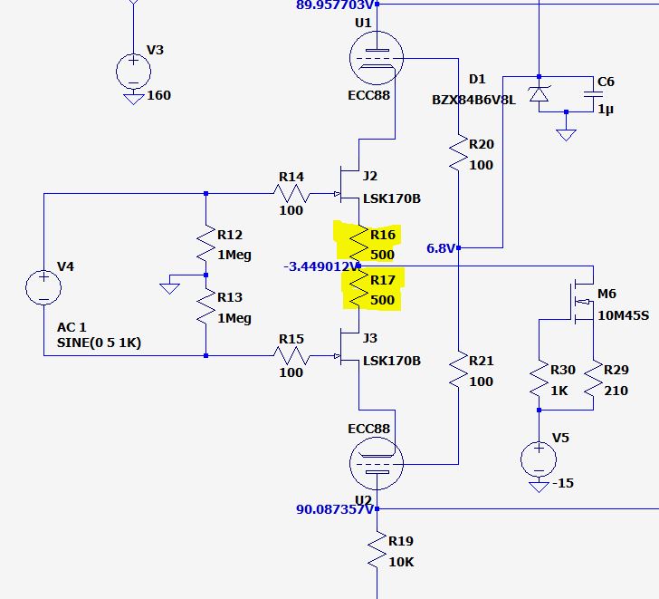

Since this hybrid tube front end has great potential to be used with other amplifiers, some way of adjusting the gain might be very useful.
This PCB design has only one voltage regulator for B+. Modifications can be made to have separate supply for each channel, heaters included. It will require different power transformer, with more windings, more parts and space.
Gain can be easily adjusted via R16, R17. A dip switch can be mounted on PCB to adjust gain, but complicates the H2 adjustment.
Perhaps, with just one B+ regulator, there can be separate RC filtering for each channel? An intermediate solution that wouldn't require a different power transformer.
Thanks for the tip on adjusting the gain with R16 and R17. No need for a DIP switch. Only looking to decrease the gain to about 20 dB, perhaps 18 dB. The 20 dB gain setting would be for an F4 and the 18 dB setting for a VFET amp.
