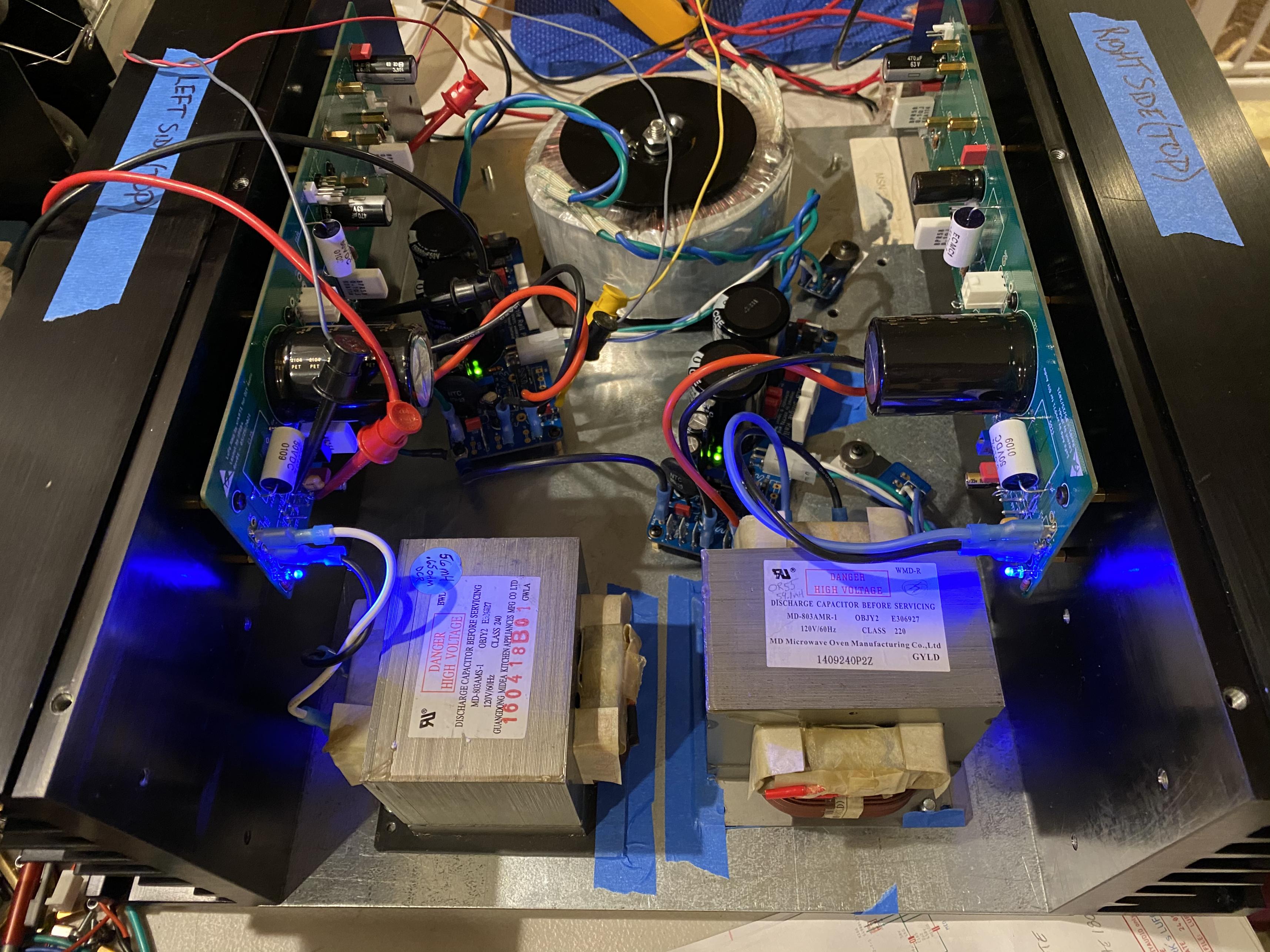

Each heatsink can handle the 75w from 3x MOSFETs plus 12w from LU114D easily. Circa 90w max - similar to what a 4Ux300mm can do. This is 345mm deep by 200mm or 4.5U so plenty of capacity.
The SuSyLu is bridge tied load (balanced) amp with choke load so is actually quite thermally efficient.
Up to 100w/(87w x 2) = 57% thermally efficient at full power (or better as the dissipation. Actually decreases when the power goes to the output at higher power. I have measured that a SE Class A amp runs cooler when playing at high power. Almost approaching Class AB 67%.
But terribly inefficient at low power - same 87w x 2 dissipation.

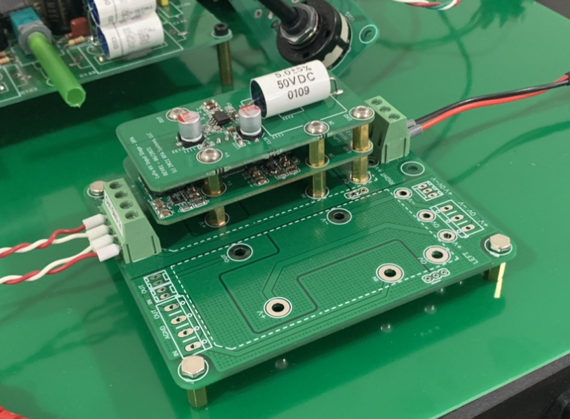

Some progress on making the +/-35v DC/DC converter for the LuFo OPA454 front end board. The LT8364 takes the +28v input and converts it to a dual rail isolated supply via a coupled inductor in a single ended primary inductor converter (SEPIC) topology.

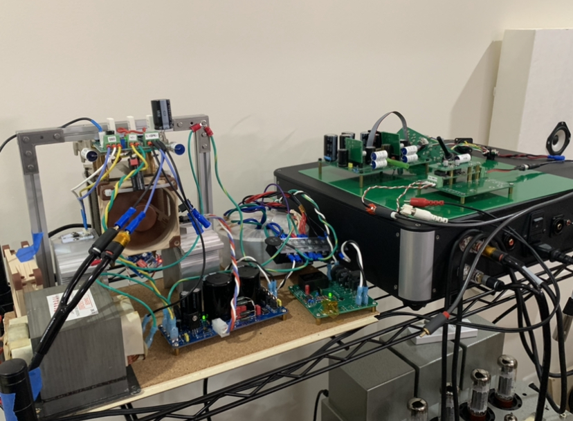

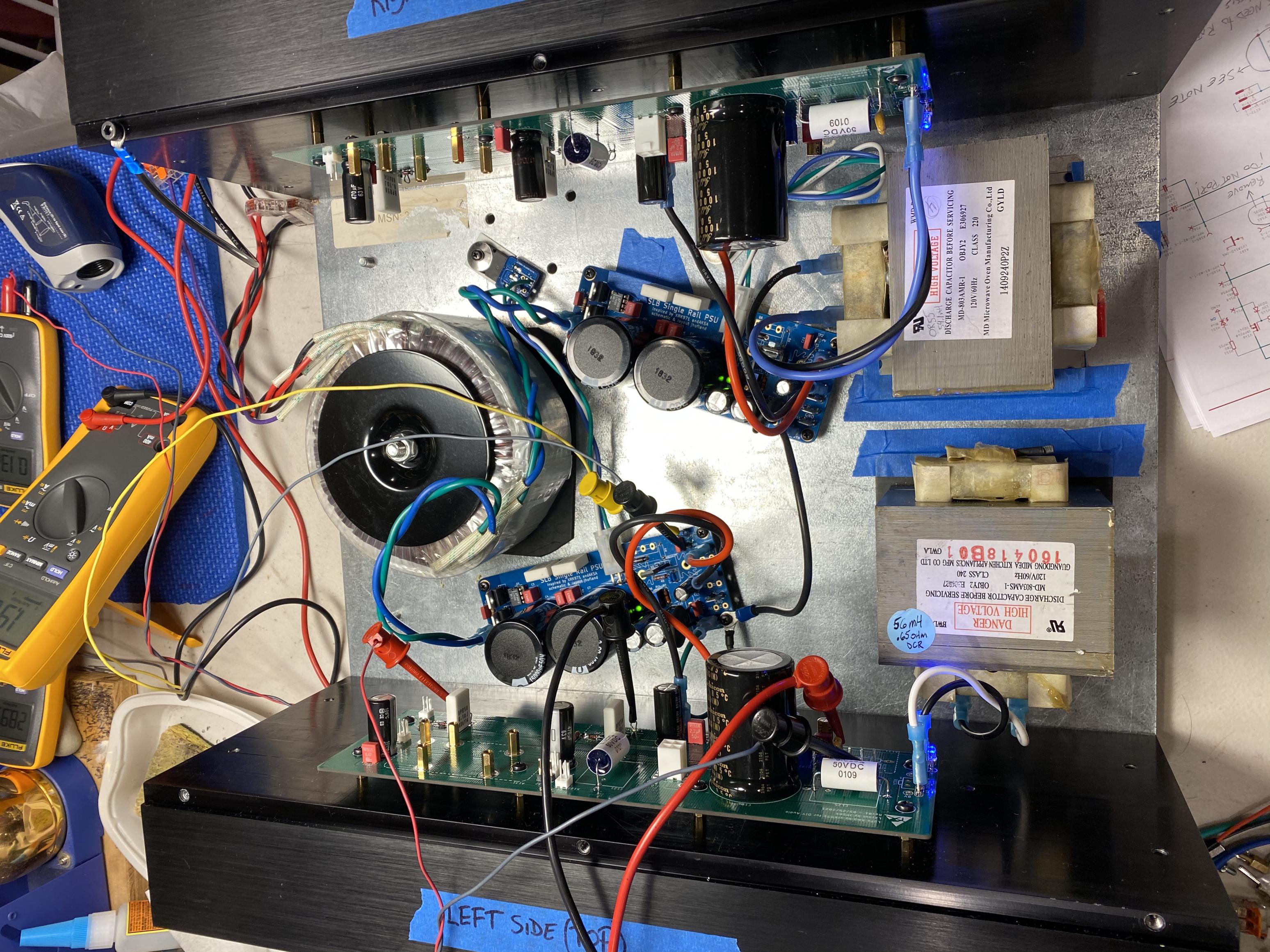

A bit more progress tonight. Second channel powered up smoothly. I was able to match the MOSFETs Vgs a little closer on this channel because I found 6 more of the same FQA’s in my parts stash. That did make a measured improvement with the current sharing between the three Mosfets.
Soooo close to hearing the LuFo in stereo, one more night!
Btw, this amp is getting heavy!! 😱

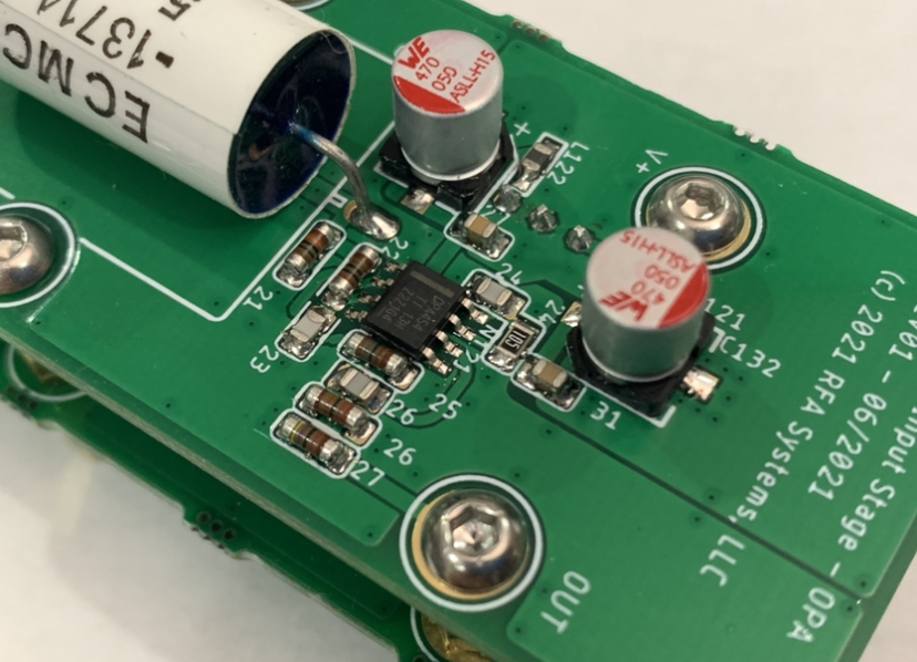

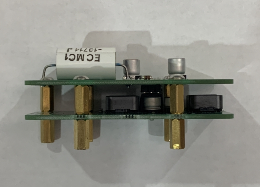

I made more progress as well. The OPA454 is singing away with the P2P LuFo amp! Sounds great! 22.4dB plus 6dB from my usual BTSB preamp is about perfect amount of gain at 28.4dB overall. With music off the amp is still silent. Can’t tell it is turned on. No hiss, no noise, no hum.
The +/-35v DC/DC converter is running off a 12v Class 2 linear wall wart and seems to work just fine. It accepts a wide range of input voltages. I have also tested with 28v input of course.
JPS64 did another superb layout on the OPA454 front end. Thanks, JPS64!
attachment.php
attachment.php

Thanks, guys. I think we may have stumbled upon a universal high swinging output stage for all of the 0dB gain amps: F4, MoFo, LuFo, SuSyLu, etc.
Once I add second channel all it needs is 12v from a wall wart and you are set. 0.0008% THD with 125mA drive capability. +/-35v (can be adjusted to be as high as +/-49v).
Yes, it was actually designed for that. I have tested it with the 28v from the amp. It was just more convenient for testing as I did not have a wire from my main 28v rail handy.
When you bolt this front end to the LuFo main board, you will automatically make the connection to the +ve rail and the signal input and output via the standoffs which also provide electrical contact.
Notice the five brass standoffs on the LuFo verification build that Vunce is doing. That’s where this goes and all electrical connections will be handled automatically.
