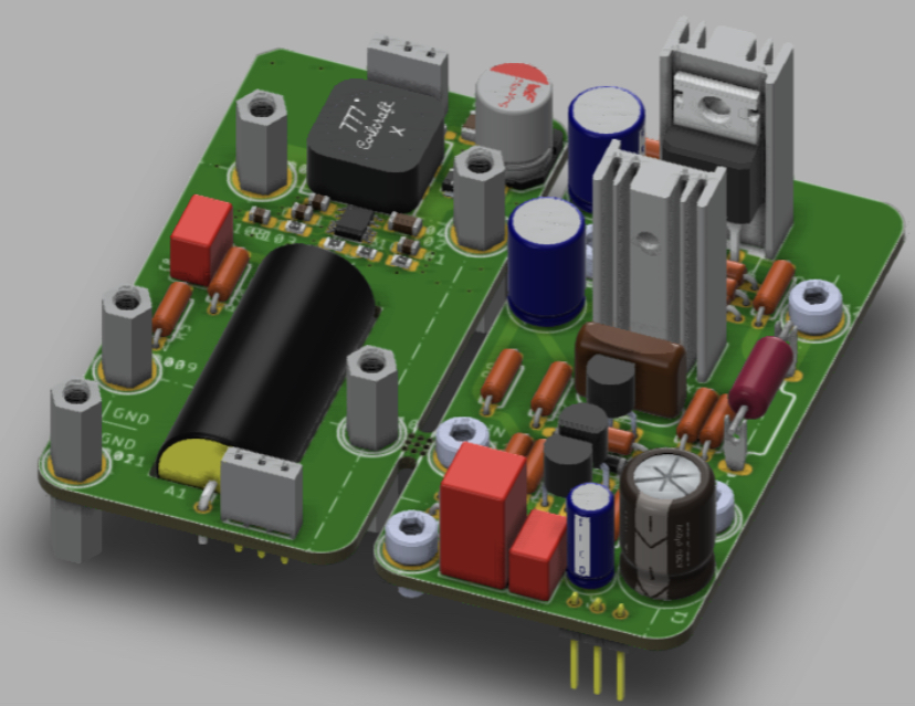

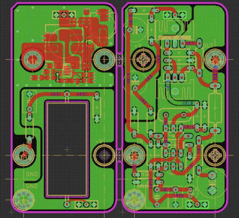

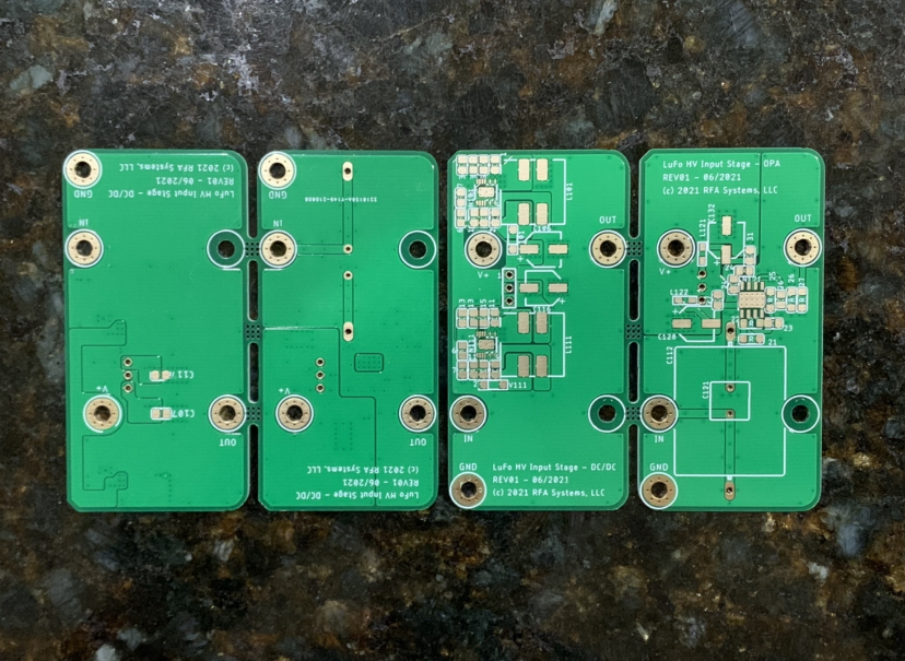

It's likely not worth the effort, but should the text be flipped on one of the mirrored boards? In Vunce's picture, the text is oriented as if the FETs were on the top, but traditionally they are installed on the bottom for better cooling.
Flipping the stencil labeling is my notes for the boards that will be released in the wild. This way when you look at the right or left side the text is oriented the correct direction.
You guys are all very Eagle eyed!🙂

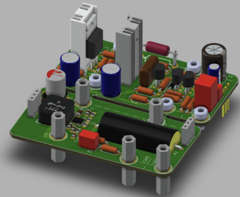

A quick update, JPS64 is close to finishing up the Aksa Lender front end board for the LuFo. It will have its own dedicated 55v DCDC step up voltage booster on the bottom and the preamp itself will be all through hole. However, we could not make the DCDC step up through hole. The lower power supply board however has a massive cutout to allow clearance for a large 2.2uF 250v MKP axial film cap for the input of the Aksa Lender. The output coupling will be taken care of by the LuFo’s on board cap (which can be a large boutique Mundorf etc). This board is in the usual M2X/Yarra bolt pattern.
The Aksa Lender is probably my favorite preamp of all time. Hugh Dean designed it at my request because I was looking for a good preamp to drive the F4. It can be used for any 0dB gain power stage like F4, MoFo, LuFo, etc. It will drive 50Vpp cleanly, and with a superb harmonic distortion profile. It will be set up for 22.4dB gain so should be quite compatible with most preamps and sources.

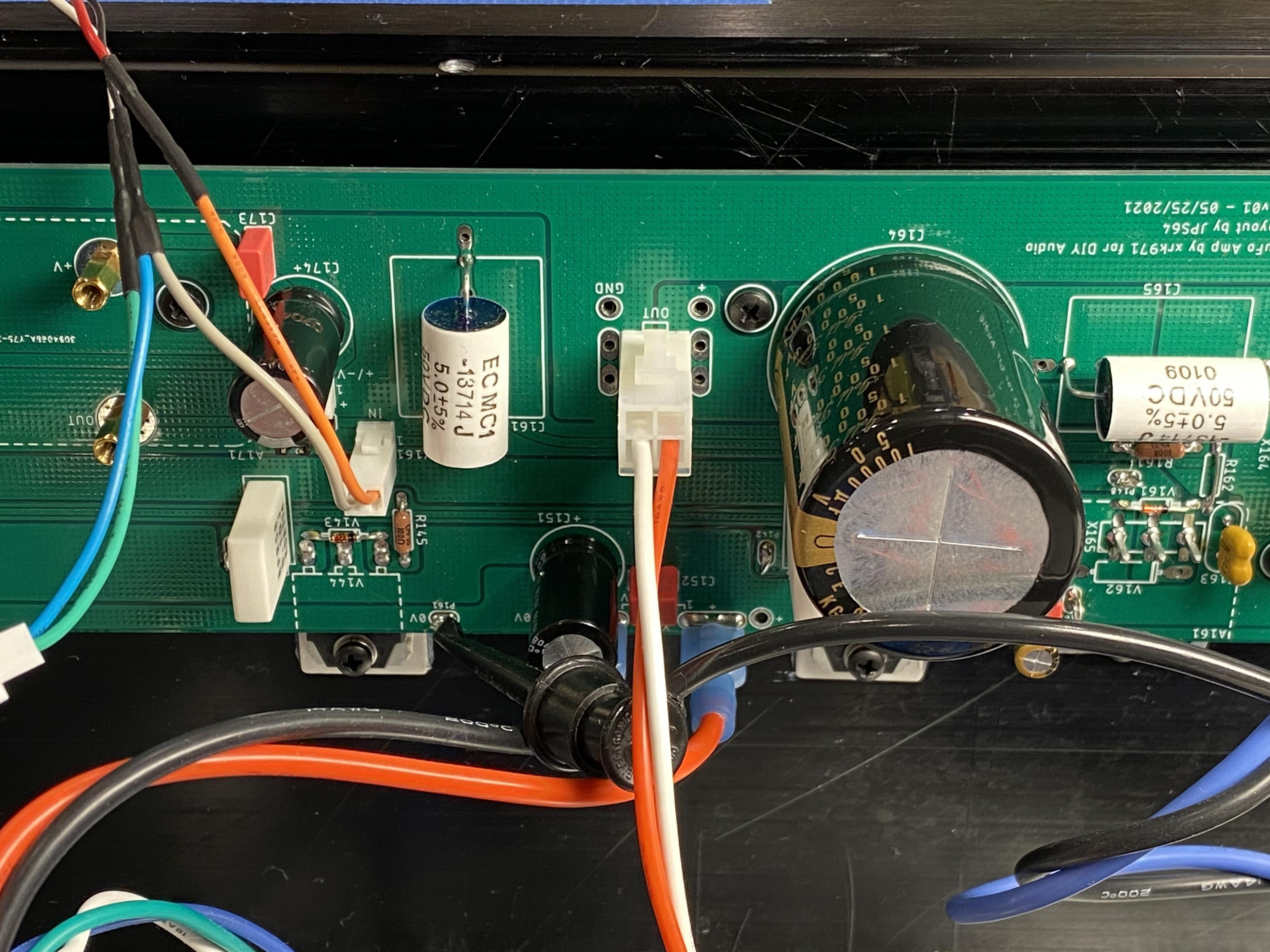

LuFo progress update

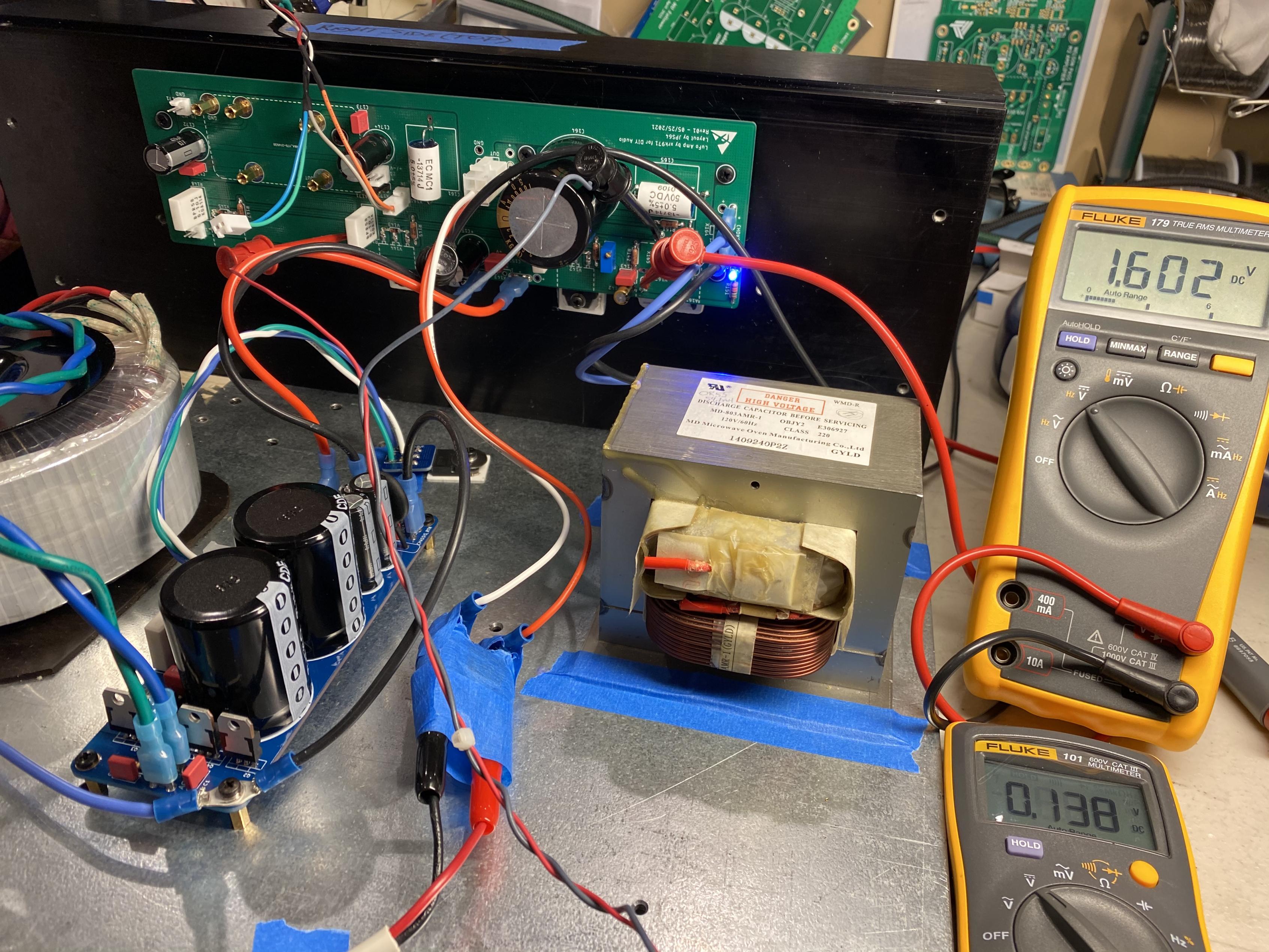

The LuFo Amp lives!!
Powered up drama free without any magic smoke 🙂
Bias easily adjusted to 3A with a couple turns of the trimpot. (1.65v across the MOT with a DCR of 0r55 ohms)

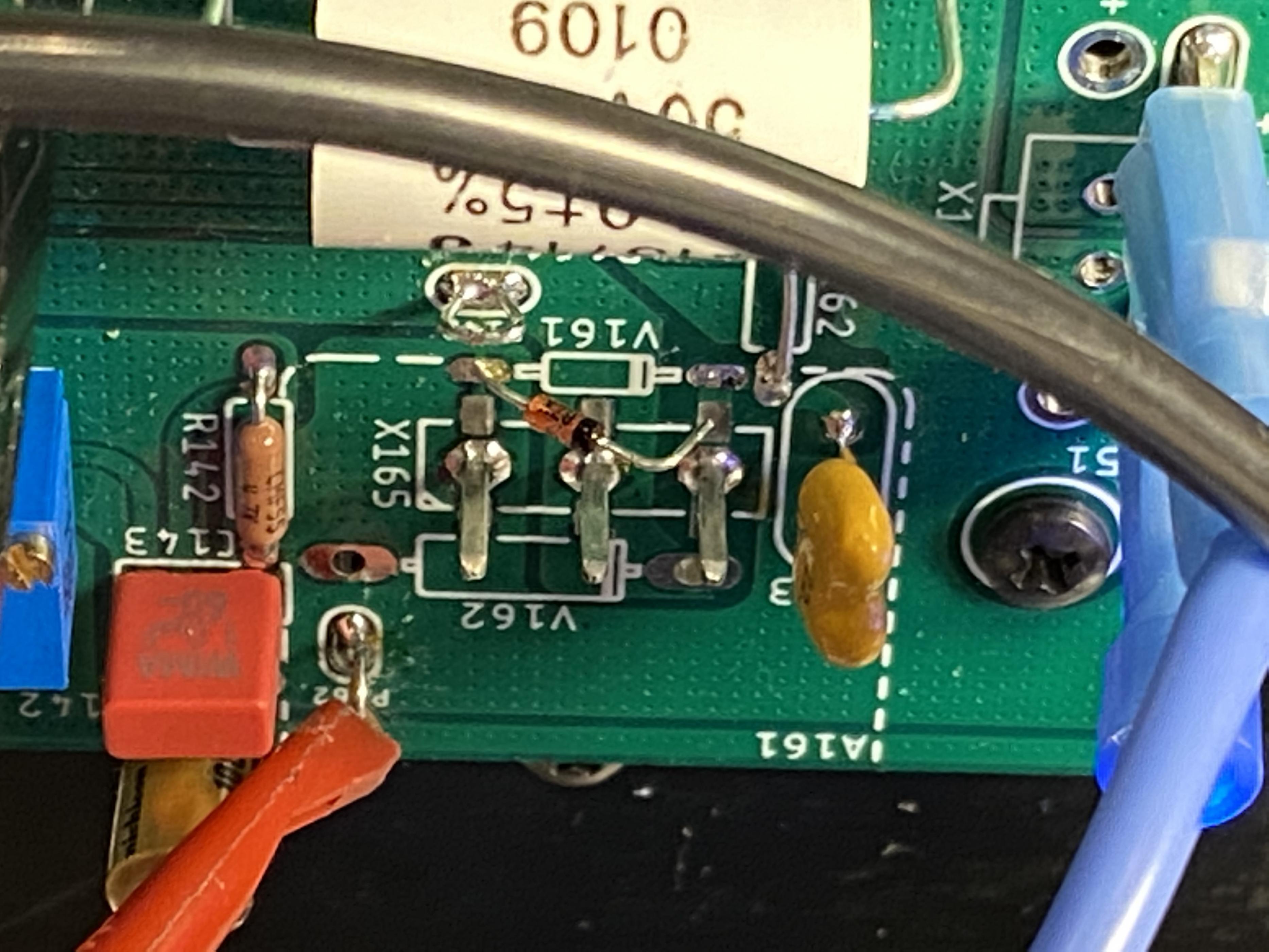

Set up my AKSA Lender preamp and a single Speedster (Paul Carmody design) speaker. Using an iPhone as the source I gave the volume knob a twist and noticed a strange behavior. The bias current was moving when increasing/decreasing the volume pot. After chatting with X, I checked for voltage at the JFET gate, almost 1vdc was present. I removed the zener diode (V161) and the issue was solved, near 0vdc at the JFET gate.

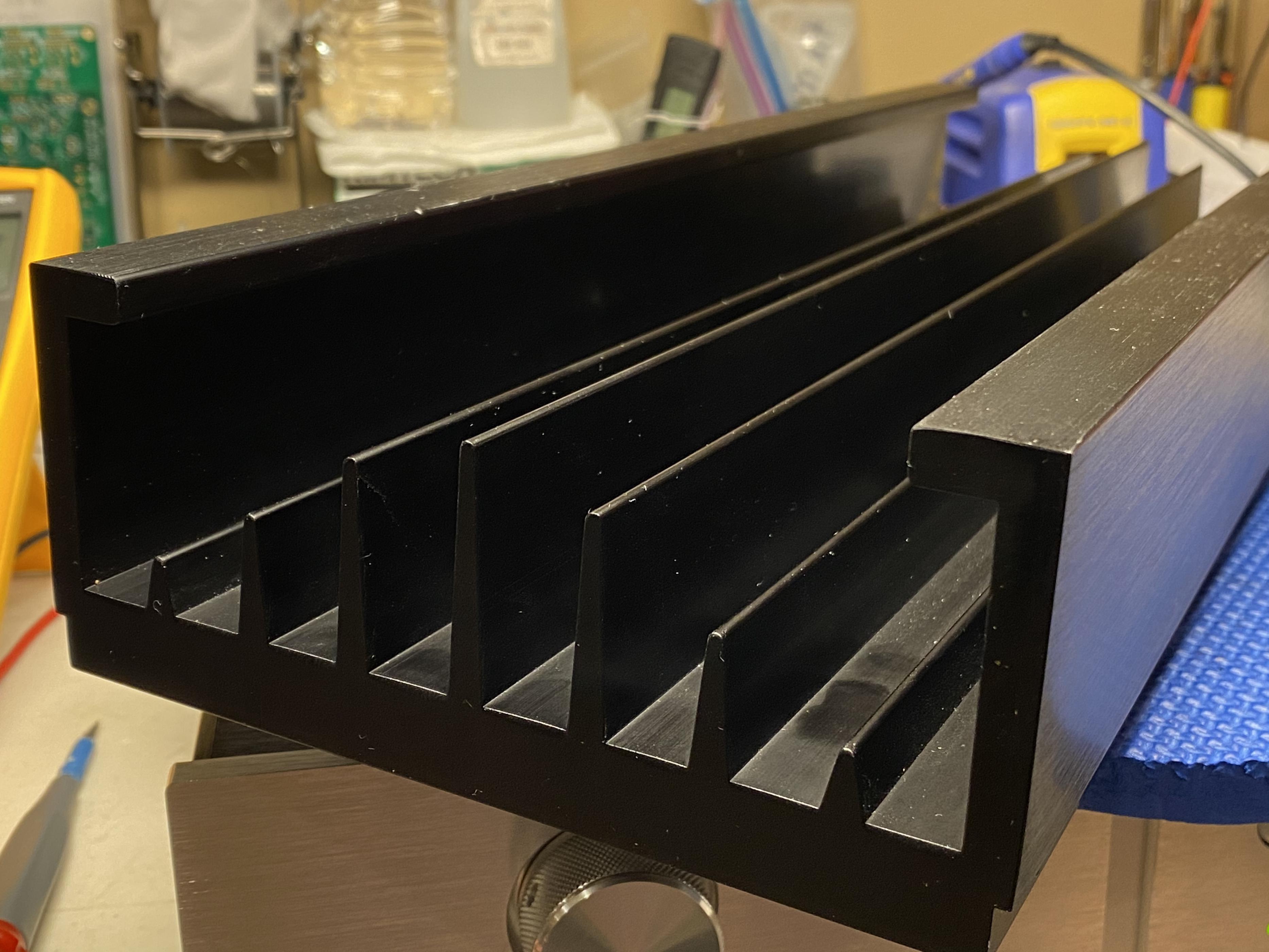

Clear sailing from there, no turn on/off plops or noises, no background hum, super quiet amp. Even with just a single speaker playing the music has an effortless presentation. Running for over two hours and the heatsink is 54°C, it’s a bit toasty but I expected temps would be a bit high because of the not ideal horizontal fins. I believe a 4U 400mm chassis would be perfect for cooling duty.
Time to get working on the second channel for stereo listening, and try adding the ACP+ as a front end. Lots to play with here.....

Nice work, Vunce. Thanks for verifying the prototype board. Sorry about the Zener diode on the LU1014D. I forgot that we can’t put it there if the source pin is connected to a choke which generates a reactive back-emf greater than 0.6v. 54C is par for the course with a big Class A amp. Looking forward to what you get with stereo. I was not able to get anywhere with building the OPA454 front end board tonight. Another night...

X & Vunce,
Thanks for working out the specifics with the LU1014 zener diode necessity. It seems to be a persnickety little critter but I guess all JFETS are in their own way!

Hi Anand,
That’s just me not thinking through the fine details and designing based on past similar situations. It’s great that Vunce does these verification builds and works out all the bugs in advance so that everyone out in the wild can expect an amp that will build up easily and and have an uneventful first power up.
Thanks for checking on price of Lundhals. That’s a fair price for the extreme quality and luxury item that it is. 🙂

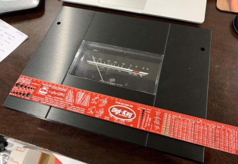

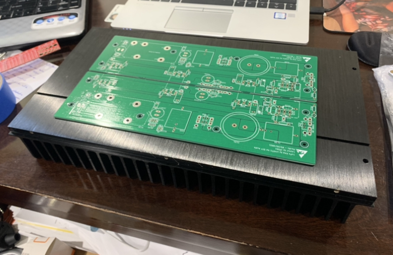

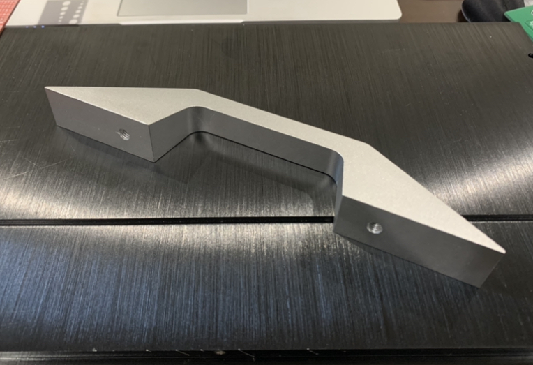

Some good news - my big dual mono chassis has been delivered (but not yet assembled). It’s very well made with 12mm thick front panel, 245mm x 200mm x 40mm fins heatsinks, nice CNC solid billet aluminum handles, machined aluminum feet, all hardware like IEC inlet, power switch, VU meter and driver board. I’m very happy with it.
Nice mono bloc chassis XRK, is this what you got it - 1PCS All aluminum amplifier chassis / Preamplifier case / AMP Enclosure /DIY box (320 *200*300mm)|Amplifier| - AliExpress
Or its bigger brother - 1 pair MC2620 All aluminum chassis Mono audio case Split amplifier Housing Class A power amp box 260*200*363MM|Amplifier| - AliExpress
