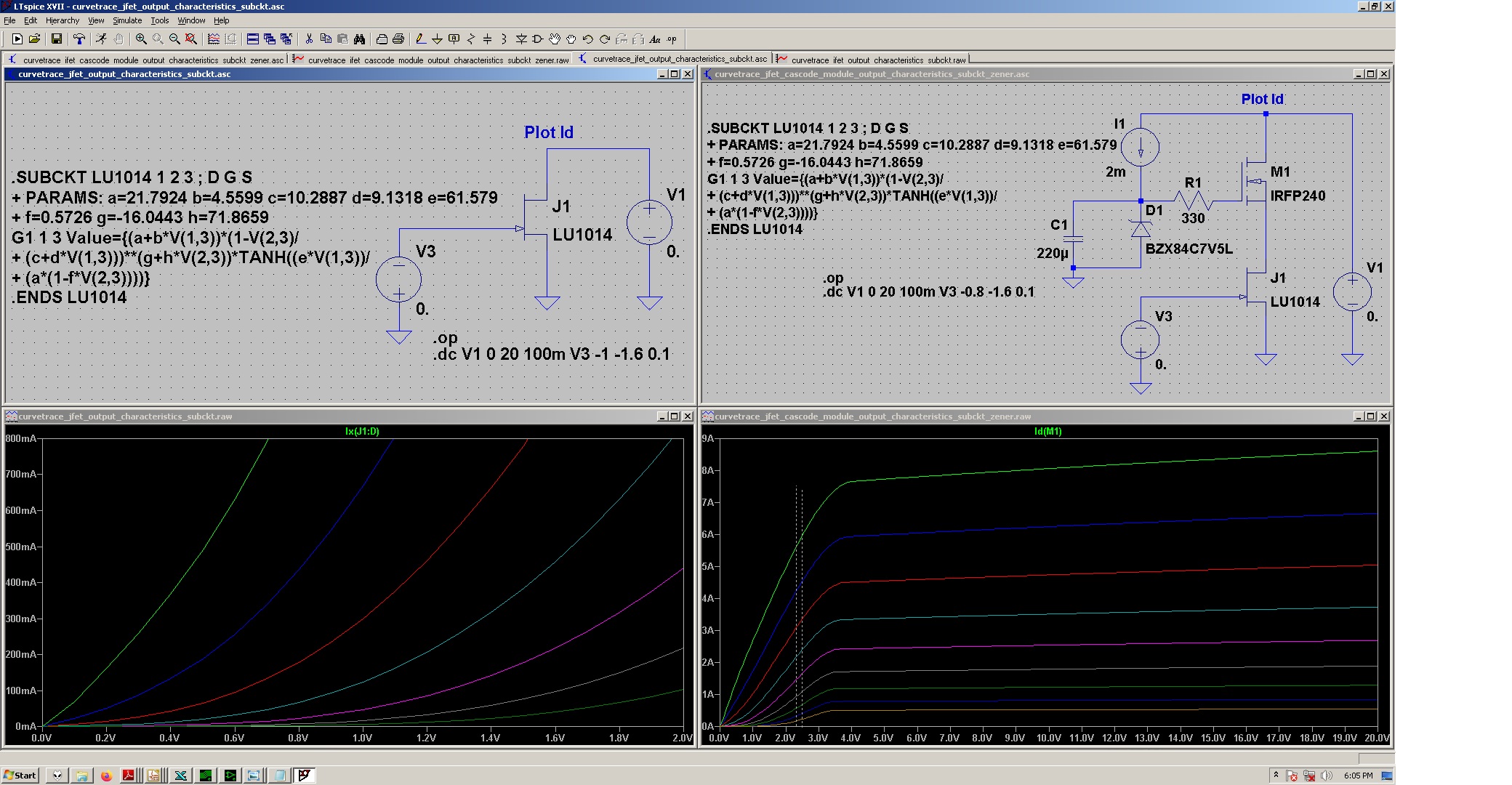

I got curious about how LU behaves in cascode and reread Pa's Cascode Article
The LU model I'm using, models the triode region pretty well.
Sim looks like what I traced, only difference was slightly higher Vgs needed to get sim look like scope.
I drew lines where Pa recommended LU operating area in cascode. He explains in article well. See, you don't let it get to that pentode area.

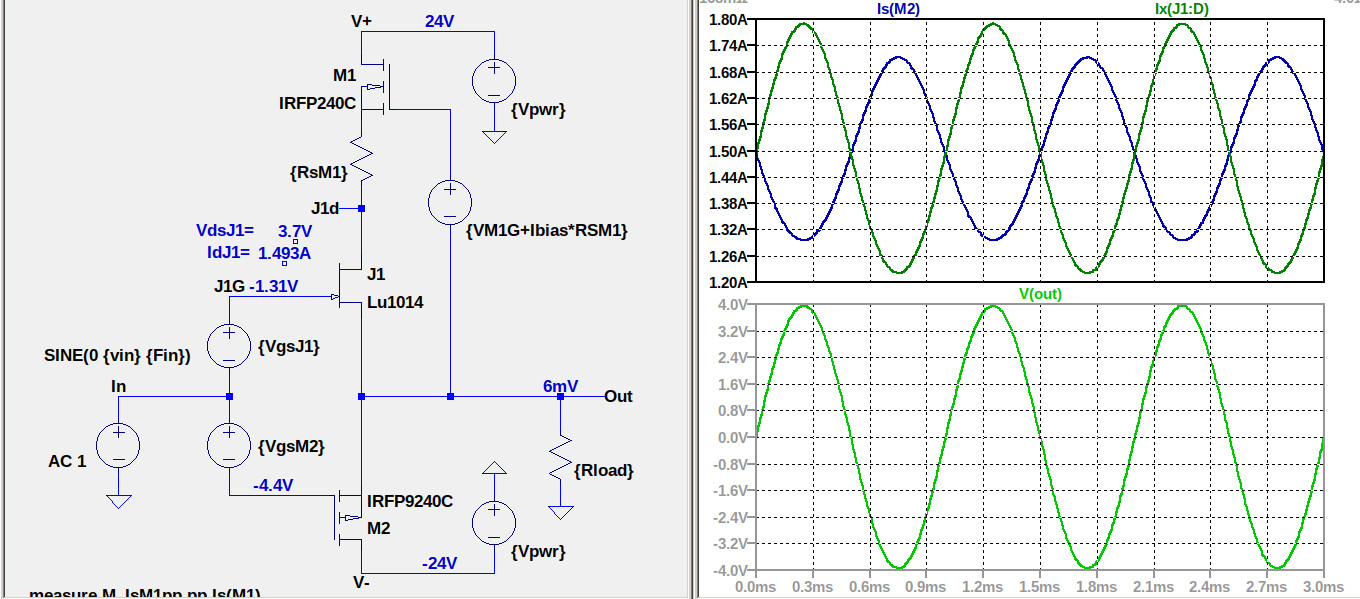

I have run some "interesting" simulations of a variant the LuDEF output stage in order to get a better understanding of the behavior of the cascoded JFET.
Nelson's post in Pass JFET Power Amplifier says:
In any case, The idea is that the gain of the device increases
with current, and increases with voltage. Ideally we want the
gain to be constant, which would make it distortionless. So
when we examine the voltage/current load line of a linear
amplifier, we see that for a resistive load the voltage across
the device decreases as the current increases, and so by
choosing the load line carefully, we have an opportunity to
cancel some nonlinearity in the gain device. This technique
appears to be most popular with triodes.
The result is to minimize (or adjust) the level of the 2nd harmonic. What I observe is that the technique is also adjusting the slope of the load line on the JFET, which is the apparent load impedance on the drain of the JFET.
The mu-follower "gain" resistor has similar behavior of changing the slope of the load line, increasing mu-gain increases the apparent load impedance on the drain of the JFET.

Can you post your Lu1014D Spice model? I am using the one from Lovoltech, but I suspect that it isn't good at the 1.5A region of operation. The transconductance values I see in simulations are high, like 40S. I do not have parts to measure. Do you have parts and can measure transconductance?
I have two pairs from an old F3 that was not built. I was planning on an F3 until the LuDEF popped up.
Happy to send them to you for testing. I think the LuDEF kits will come with them. I’m in Portland.
Here's the spice model. That one from Lovoltech didn't work for me either. :whazzat:
.SUBCKT LU1014 1 2 3 ; D G S
+ PARAMS: a=21.7924 b=4.5599 c=10.2887 d=9.1318 e=61.579
+ f=0.5726 g=-16.0443 h=71.8659
G1 1 3 Value={(a+b*V(1,3))*(1-V(2,3)/
+ (c+d*V(1,3)))**(g+h*V(2,3))*TANH((e*V(1,3))/
+ (a*(1-f*V(2,3))))}
.ENDS LU1014
  • I tried your model and I am finding the transconductance of the cascoded JFET to be about the same as the IRFP9140.
  • With the Loveltech model the JFET gm is about 10X higher than the IRFP9140.
  • ZM's simulation show a JFET gm about 2X higher than that of the IRFP9140.
It appears that everyone has a differeny SPICE model for the Lu1014.
ZM: Can you measure the AC voltages across the output MOSFET drain sense resistors R131 and R129? Test at something like 1 Watt, 1kHz, or lower frequency that you multimeter can accurately measure.

Run a Vgs-Id curve on the LU1014 at 3.7v Vds. That is how it will behave cascoded in your LUDEF as long as Vds remains at 3.7v.

Here is what I get using the LU1014 model from Cinco. (RsM1 is 10^-6R, ie. shorted).
