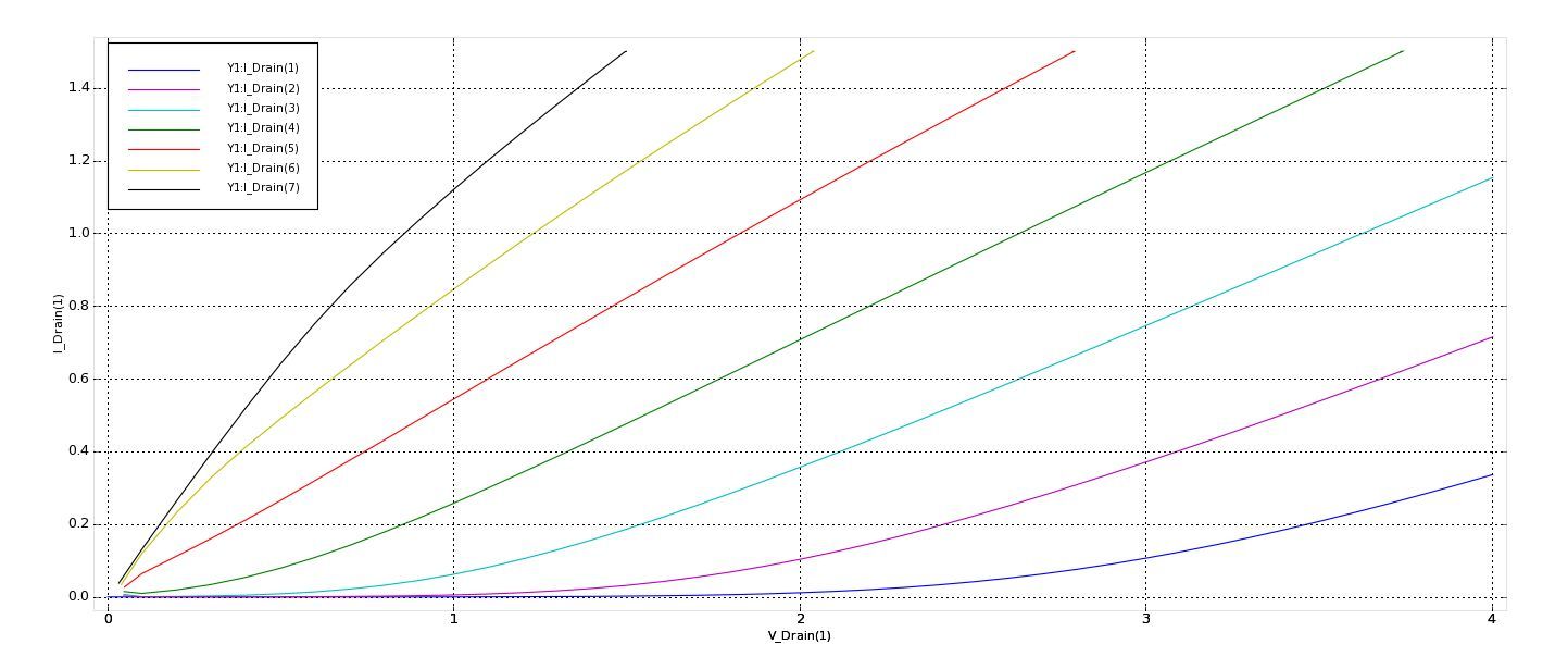

I am trying to understand the "triode" character of the cascoded LU JFET. Vds is held constant via the cascoding, so any triode behavior that the JFET might have had is made to disappear. Below is a simulation, showing the LU1014 JFET with and without cascoding. The curves in the lower plots show drain current vs. Vds for 3 difference values of Vgs. The uppermost plot shows Vds across the cascoded JFET.
What am I missing about the triode behavior of the LuDEF?
If you are in the low voltage high current quadrant, the curves are less concave-up and the gate probably is drawing significant current. At very high current, the device is more like a BJT.
The attached curve is Vgs from -1.2v to -0.4v.
That low voltage region is below the voltage needed to bias the cascode FET and would occur in operation with 25V rails only when the output voltage approached the V+ rail voltage.
Yep. Agreed. Bias point of 3.7 v @ 1.5 A is a good spot. As you point out, if you pinch off Vds, it is a different beast.
Yeah, in that low voltage region, it's a mini-SIT.

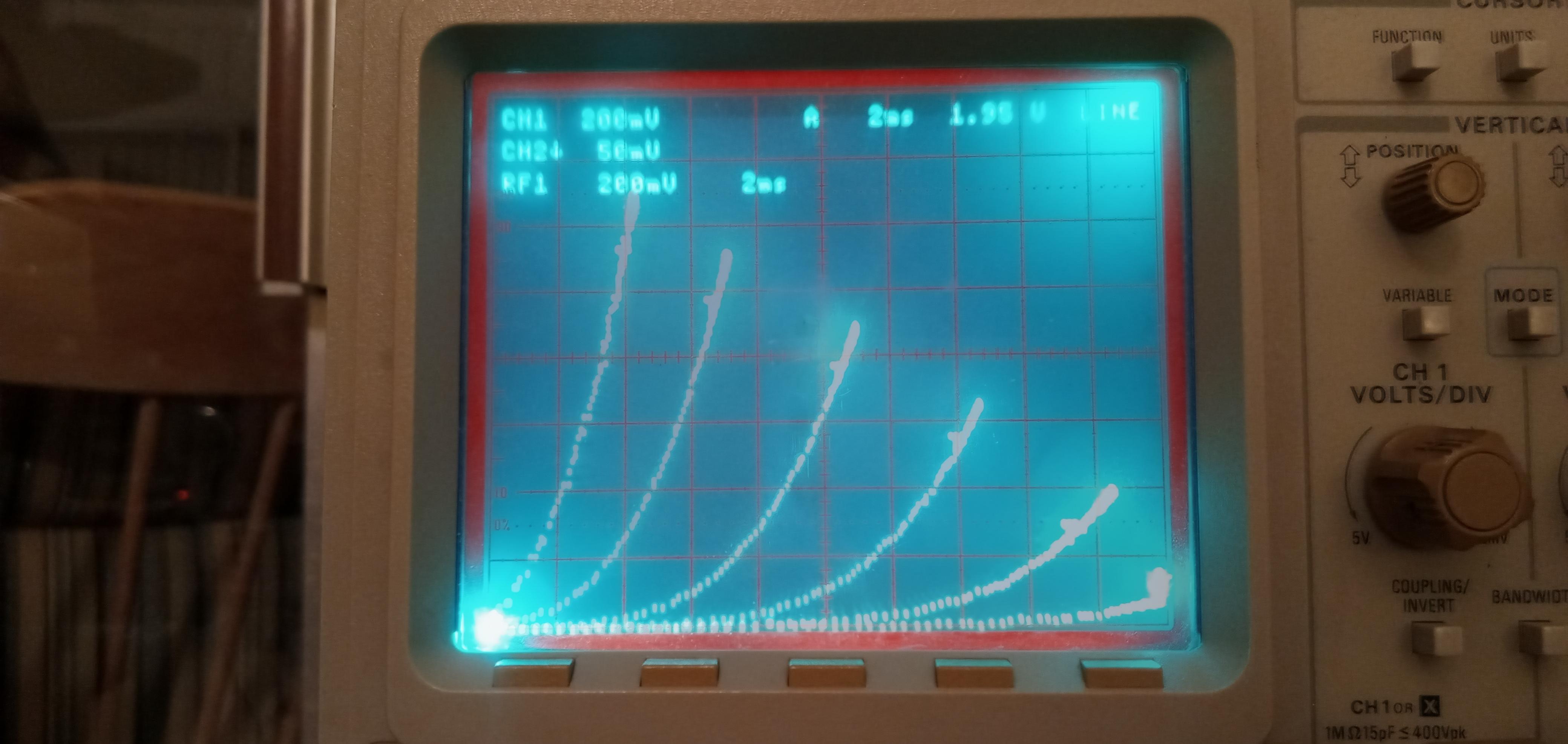

Curves traced with Vds set to 2.5V before turning on the gate. Y is measured across 1ohm so current is low
Then Vgs (V) at -0.8, -0.9, -1.0, -1.1, -1.2, -1.3
Yep gotta cascode to keep it in the magical triode region.
