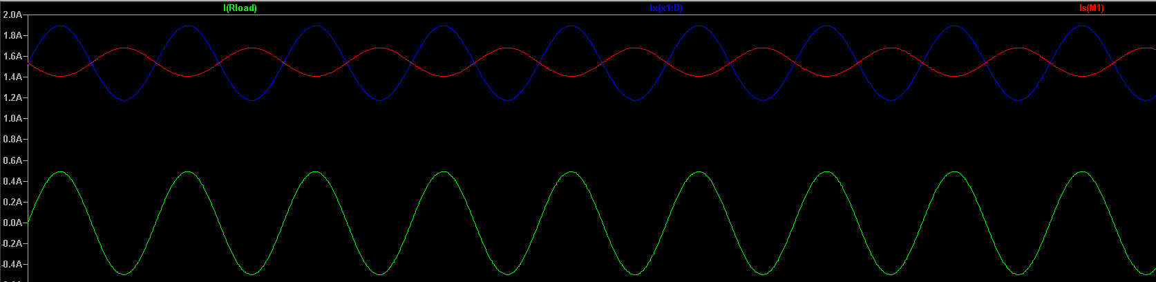

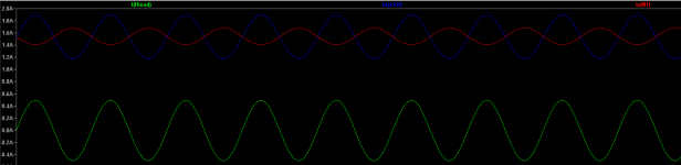

I have been looking at the LU1014D datasheets and the Spice models from Lovoltech Power JFET LD1014 and LU1014 PSpice https://www.diyaudio.com/forums/att...-pspice-lovoltech-ld1010da-ld1014d-2_9_06-zip.
Running simulations at 1.5A with those SPICE models and Vds=2.6V gives transconductance gm=44S, which is hard to believe. But the datasheets seem to give a similar result. This an amazingly high transconductance. Paired with the IRFP9140, the resulting push-pull output stage will be highly dominated by the LU1014, resulting in a strong 2nd harmonic, as indicated by ZM's plots in earliest posts.
this is what my sim sez
biggest, current through 8R load
smaller - current through LU
smallest - current through IRFP9240
sorry, blue hard on eyes, but lazy to change, preparing some other things
